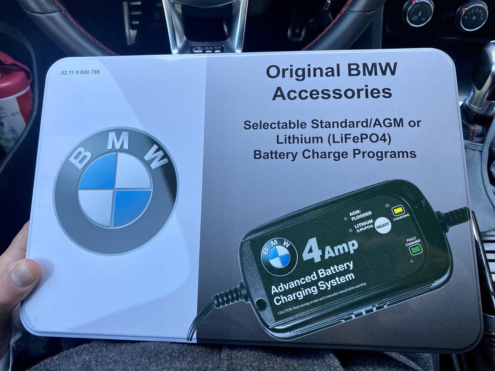

I charged all winter like you. Bmw sells a branded triclek charger for twice the going rate. I asked toyota about chargin. No clue!!
This is the charger Iā€™m using.

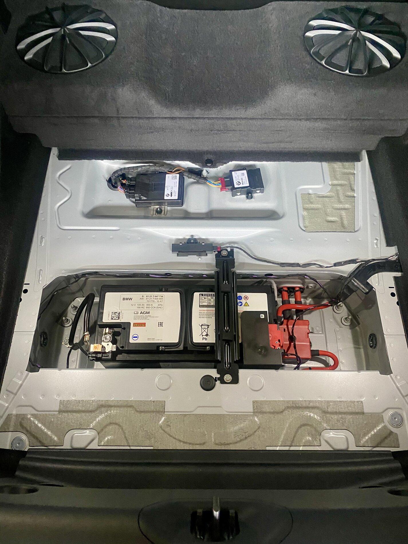

~ Heading to the dealer tomorrow for a new battery. Iā€™m going to wait on the swap while itā€™s completed. The new battery is in stock.
The trunk is ready for their work. No obstructions. ?

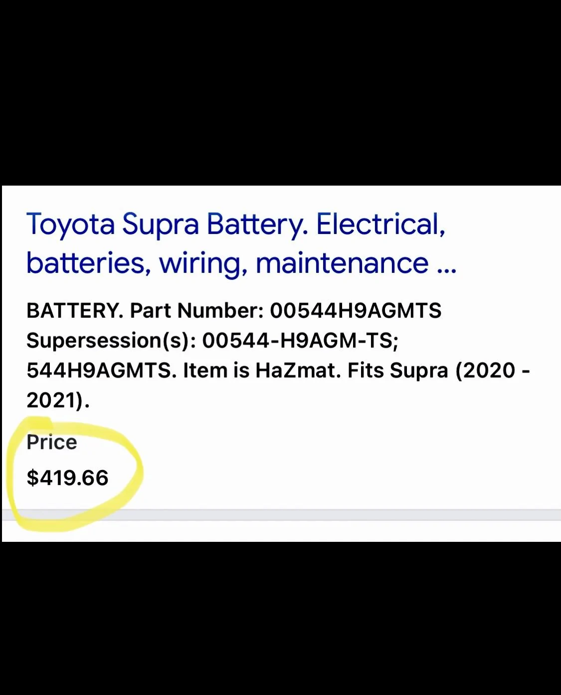

Wow the 63 lbs battery is pricy!
