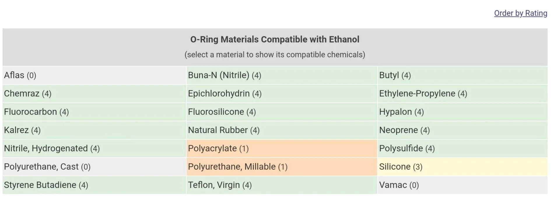

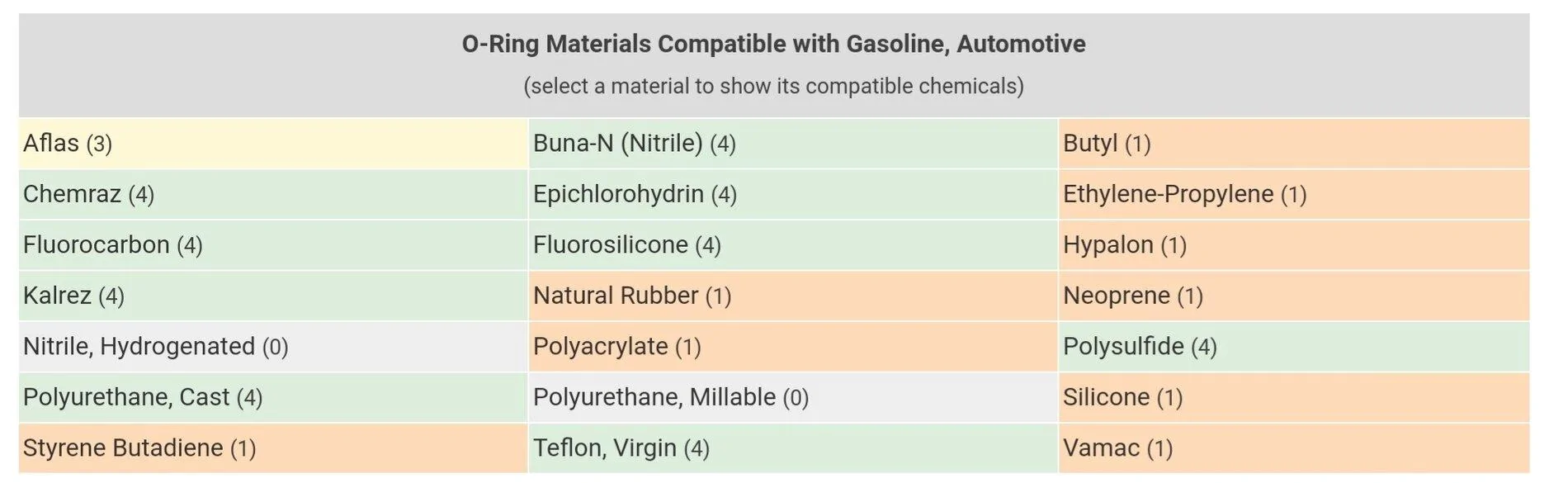

I bet it's due to the materials the O-ring is made from.
Below are two references charts for O-ring material types and their ranked usage for Ethenol and Gasoline respectively. Essentially what you should look to these charts for is a material that is green on both. That means it's a material that will not only hold up chemically to both gas and ethanol, but will also withstand a Dynamic seal application. Meaning a variety of different pressures and temperature. If someone would like to tag Visconti or send him the charts below be my guest.
My suggestion would be fluorocarbon O-rings on all seal points in the kit, much more expensive than traditional O-ring materials, but should fix the issue those of you have reported as these are commonly used in aviation for high octane, high temperature, high vacuum applications.
