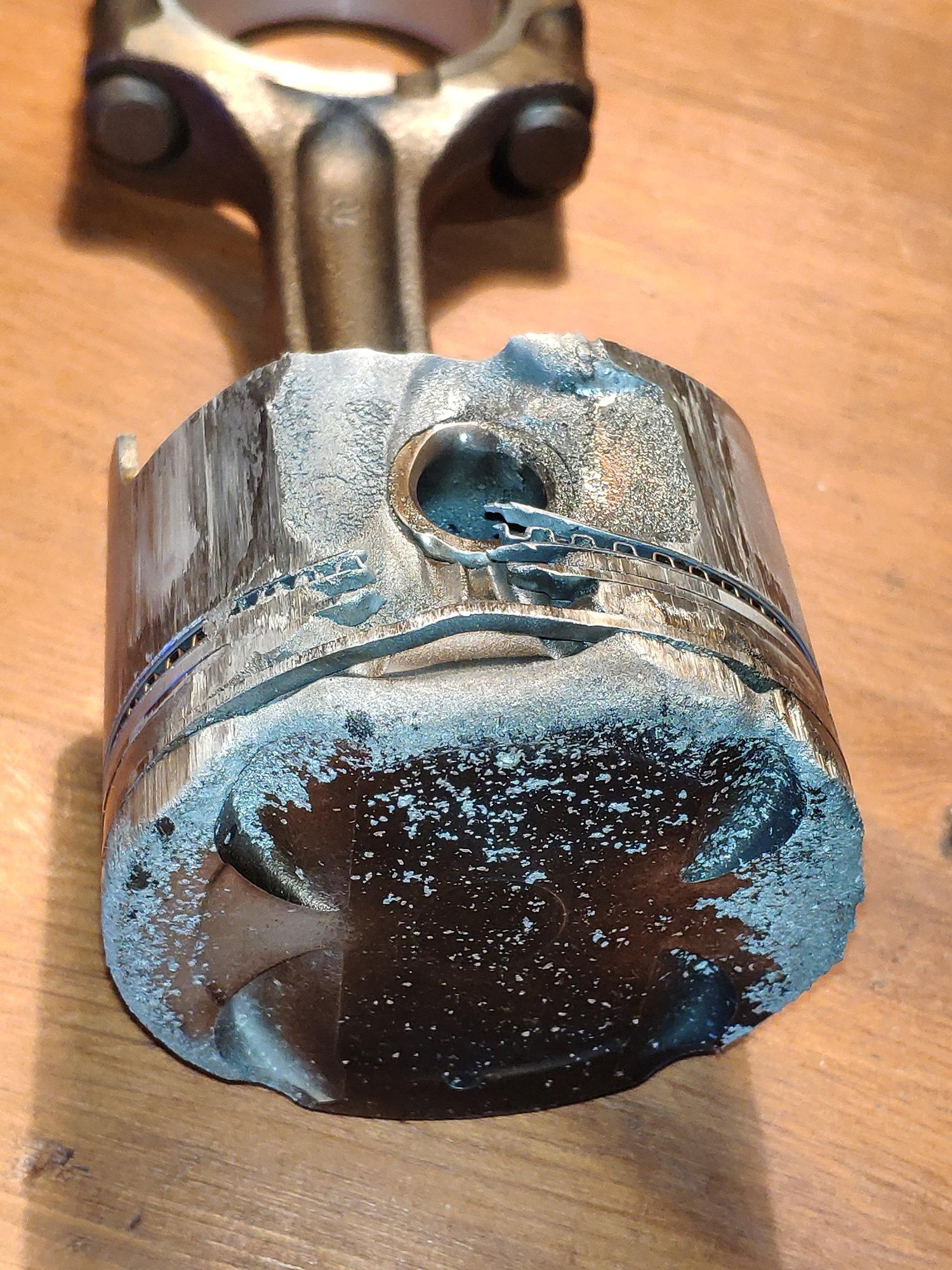

No you wont, there's plenty of spark, you'll just run lean as fuck and melt stuff.
By melt stuff do you literally mean spit flames? not that I'm trying to do that lol. Doing my best to get the mix as close to 50% ethanol as I can but was wondering about any downsides of being slightly over that.
Bryan / Briana
4,657
9,264
Your moms bedsheets
I believe he means as in, melt a piston.
