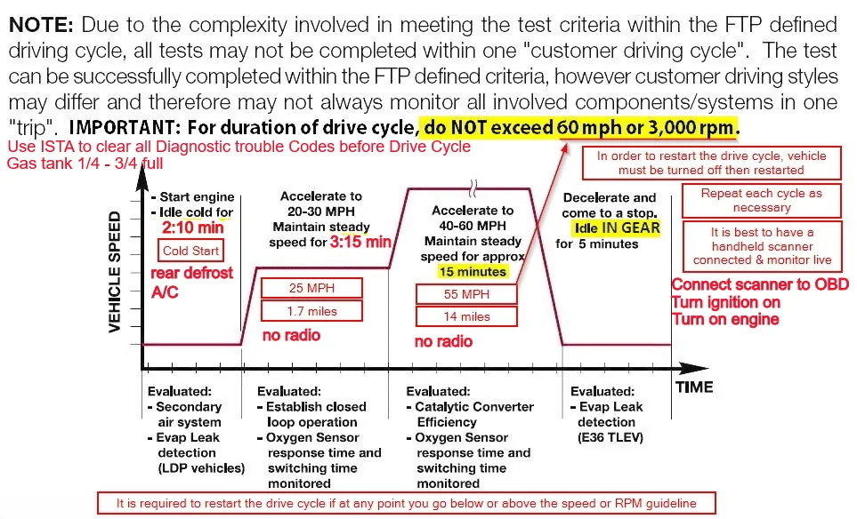

Yes correct. I also did the same this year with MHD. Actually this year I kept my tune on since I have S58 injectors/HPFP, put OEM DP on, set DP back to OEM in MHD, did the cycles to get the monitors to pass, then passed inspection.
also, would you mind letting me know what drive cycle / how long it took for the monitors to start reading?
I got pretty good at being able to run all the monitors in about an hour or so. You have to do a bunch of different style driving.
This helped:
