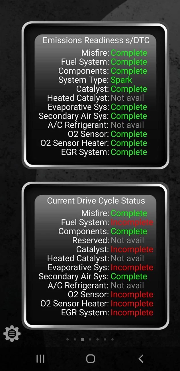

All stock save the tune. On the BMW Forums, no one is getting passed with a DP as it will throw a check engine light as well as fail the visual.
IF you want to check the readiness, grab your Android phone, OBD2 adapter and the Torque App. When you are computer ready, you'll see the top results.
