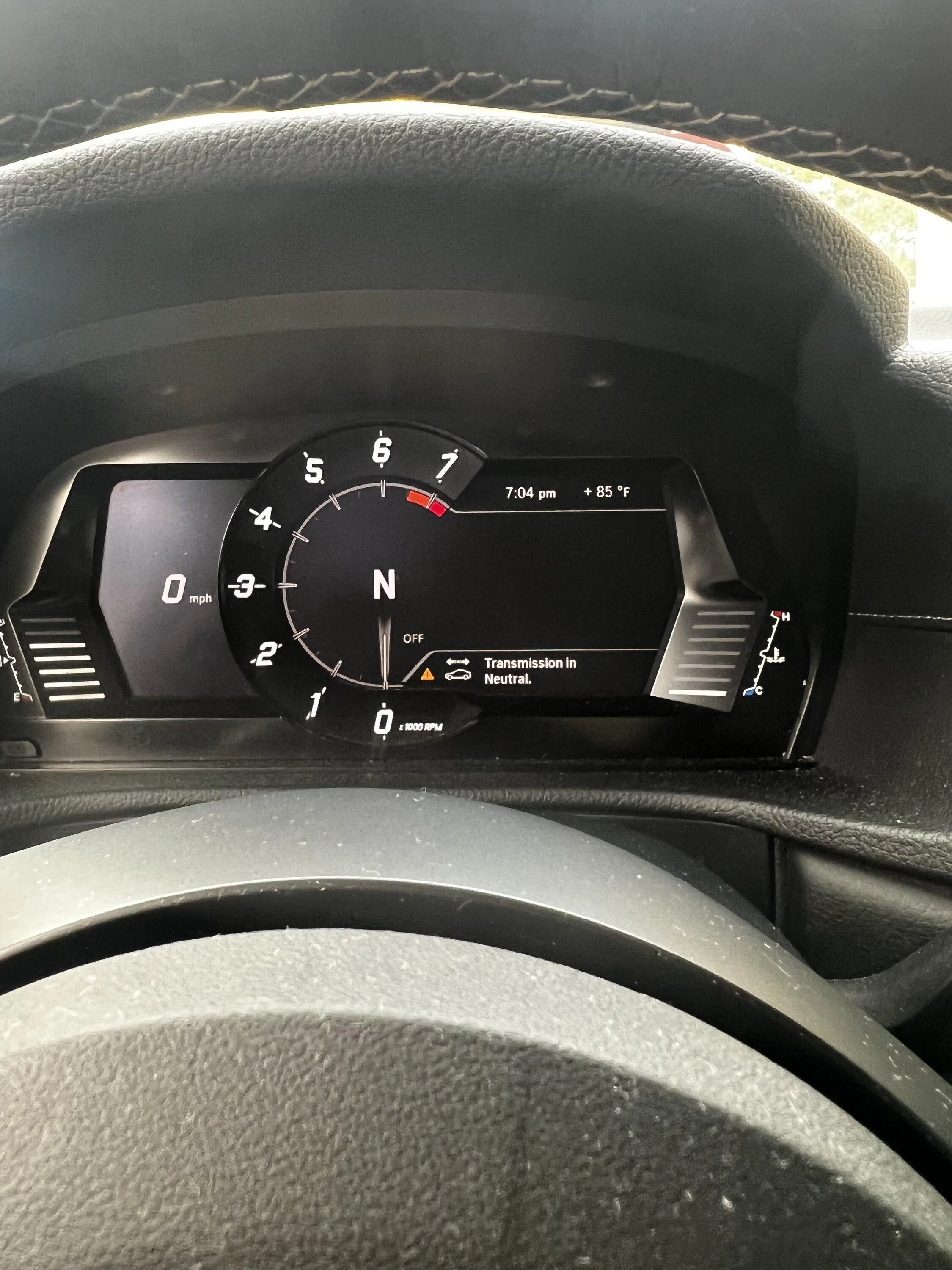

So I finally figured out how to put the car in neutral without going underneath the car.
The car has to be in a no start situation. For example unplugging an injector or coil pack. It’s a little unorthodox but better than climbing under the car
Hold start button and brake
Push shifter into neutral
Let shifter reset
Push into neutral
Let shifter reset
Hold shifter in neutral for 5 seconds.
Car will stay in neutral for
15 minutes

Did it keep showing neutral on your dashboard until it went back to park after the 15 min expiry?
Mine will go into neutral but will show Park after a good 10 seconds, although my infotainment screen shows that the car is in an emergency neutral state.

No luck. Just tried it and it still goes back to Park after a few seconds. :(

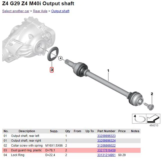

Remove any of your rear wheel center caps, you’ll find a screw (if I remember right, a big Hex screw head). That screw is what keep the axle attached. Remove that screw and your diff will become disengaged so the car will roll freely.
You gotta put something in the wheel to stop it from rolling because once you loosen that screw, the car will roll on its own weight if slightly sloped.
That’s how BMW dealerships keep the cars in neutral on their shops and that’s how I found out about this amazing, easy method.

That 02 Collar Screw is what you want to remove for it to roll freely.
Hope it helps you avoid that fee and that huge headache you must be going though.
