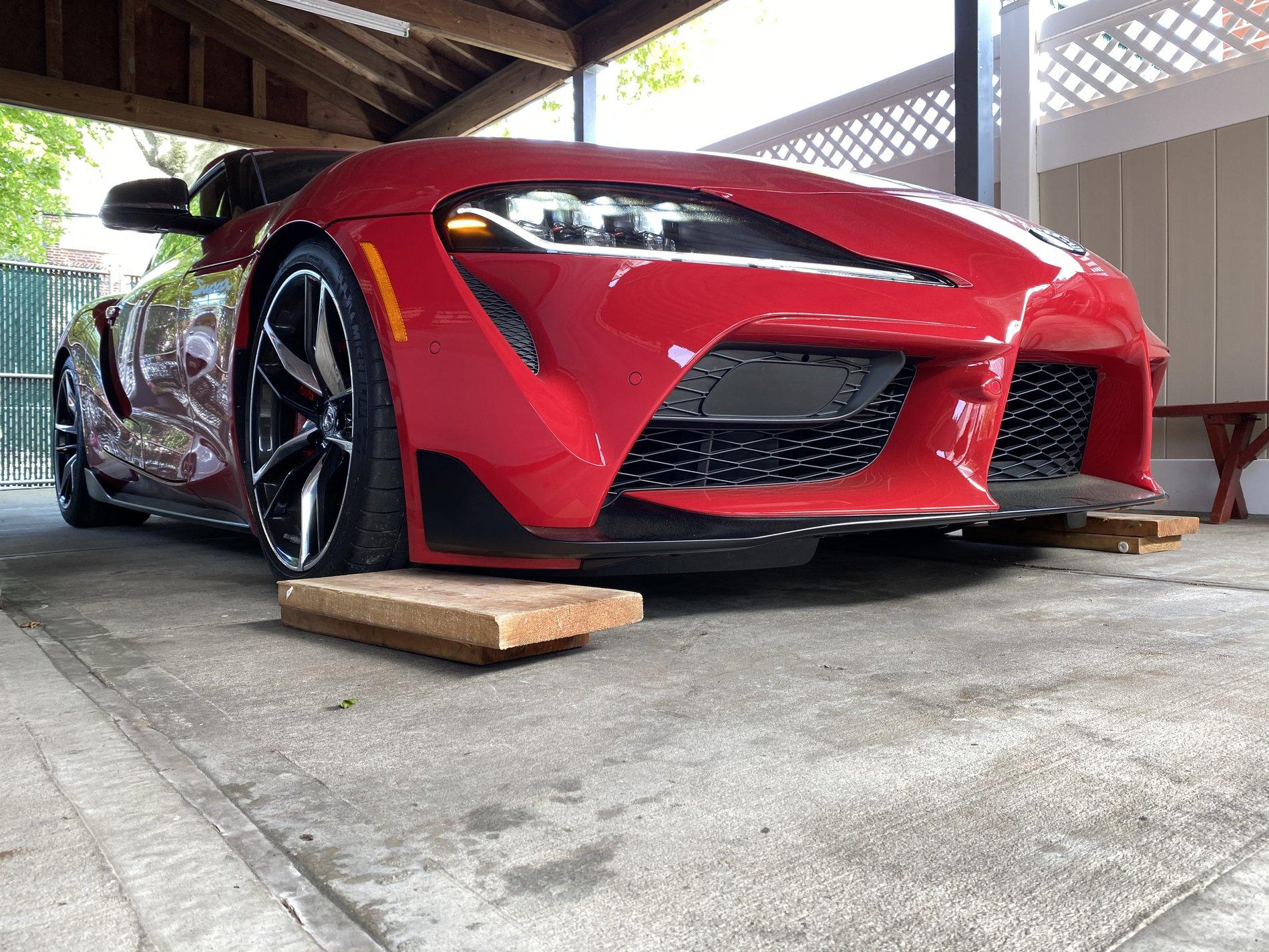

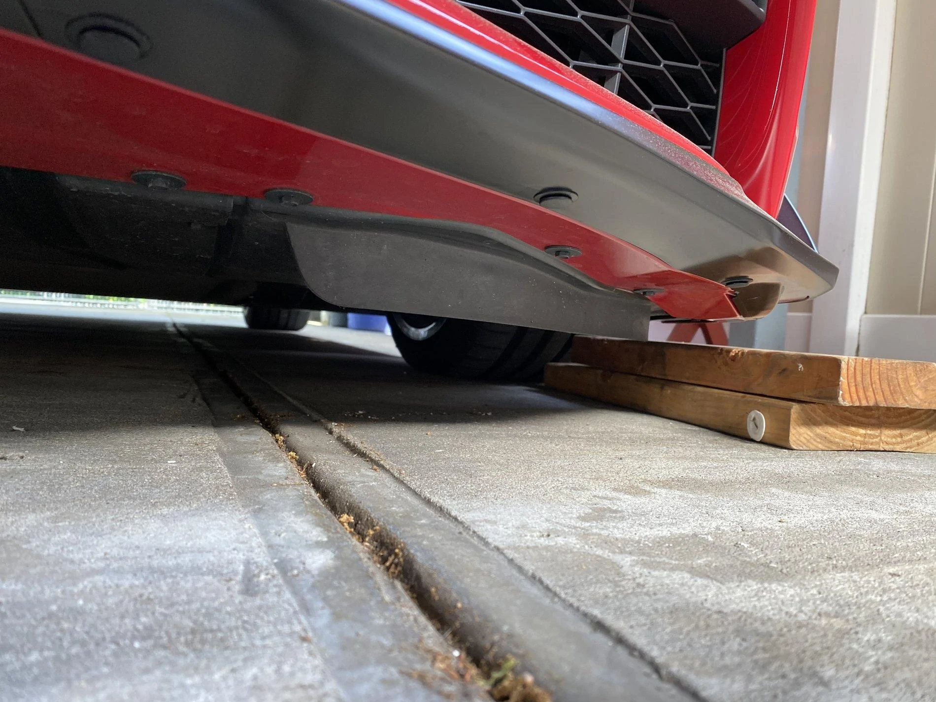

I'm lowered on Eibach springs. I use 2 pieces of wood that I nailed together as a small ramp. Then I jack the car up easily using the rubber square pads. Once the wheel is up a little, you can move the wood out of the way and the wheel is at the perfect height.
what is your clearance to the ground? Looks Great but i would scrape my driveway almost everytime i think
MAXecutive
Patrick
Apr 25, 2020
NYC
'20 A90 Supra, '15 F36 435i GC, '97 A32 Maxima, '86 Z31 300ZX
I measured a few days after installing the springs. My front section in the middle is just under 6.5". Front fender to ground is 25.75" and rear is 26.75". I should probably measure again since the springs are probably settled by now.

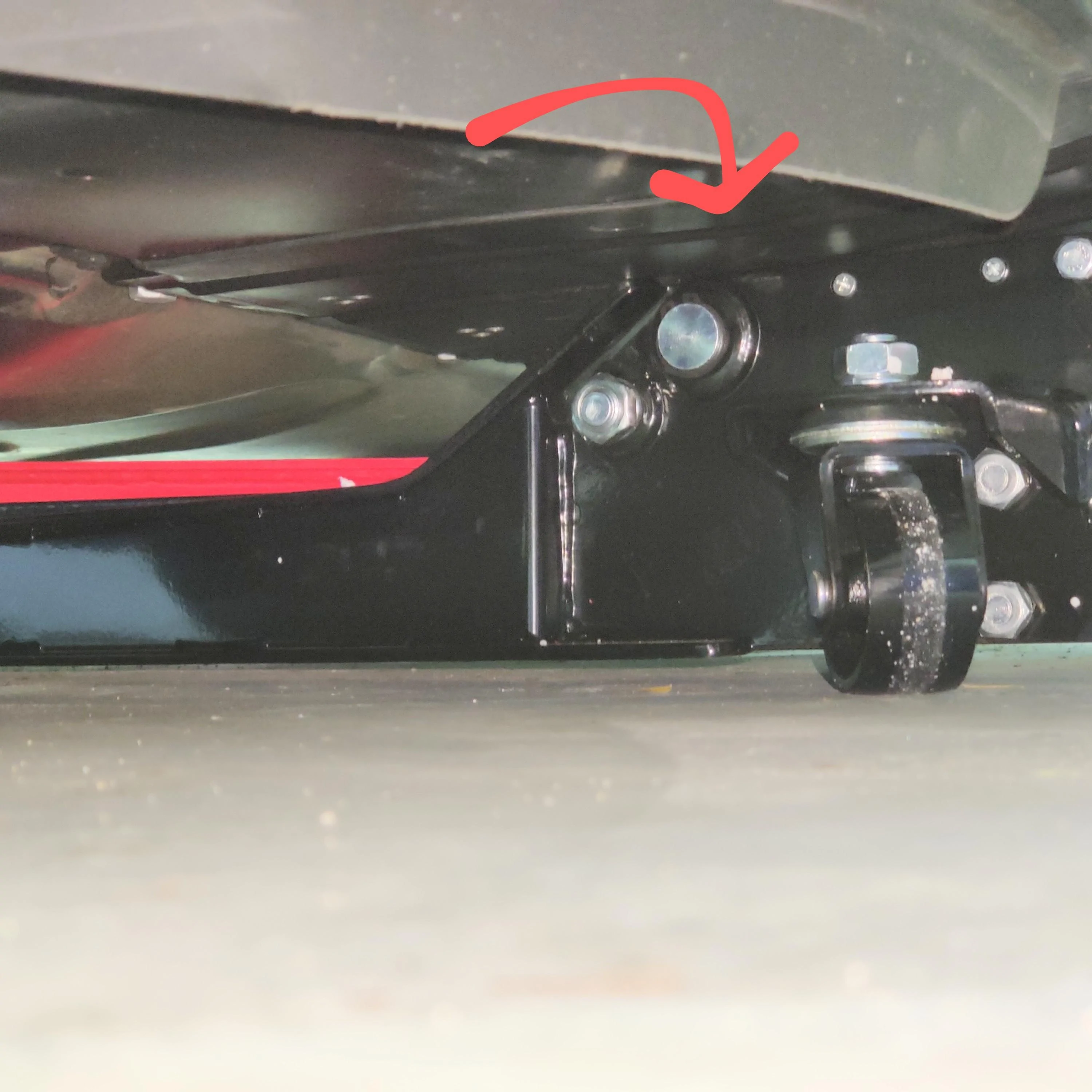

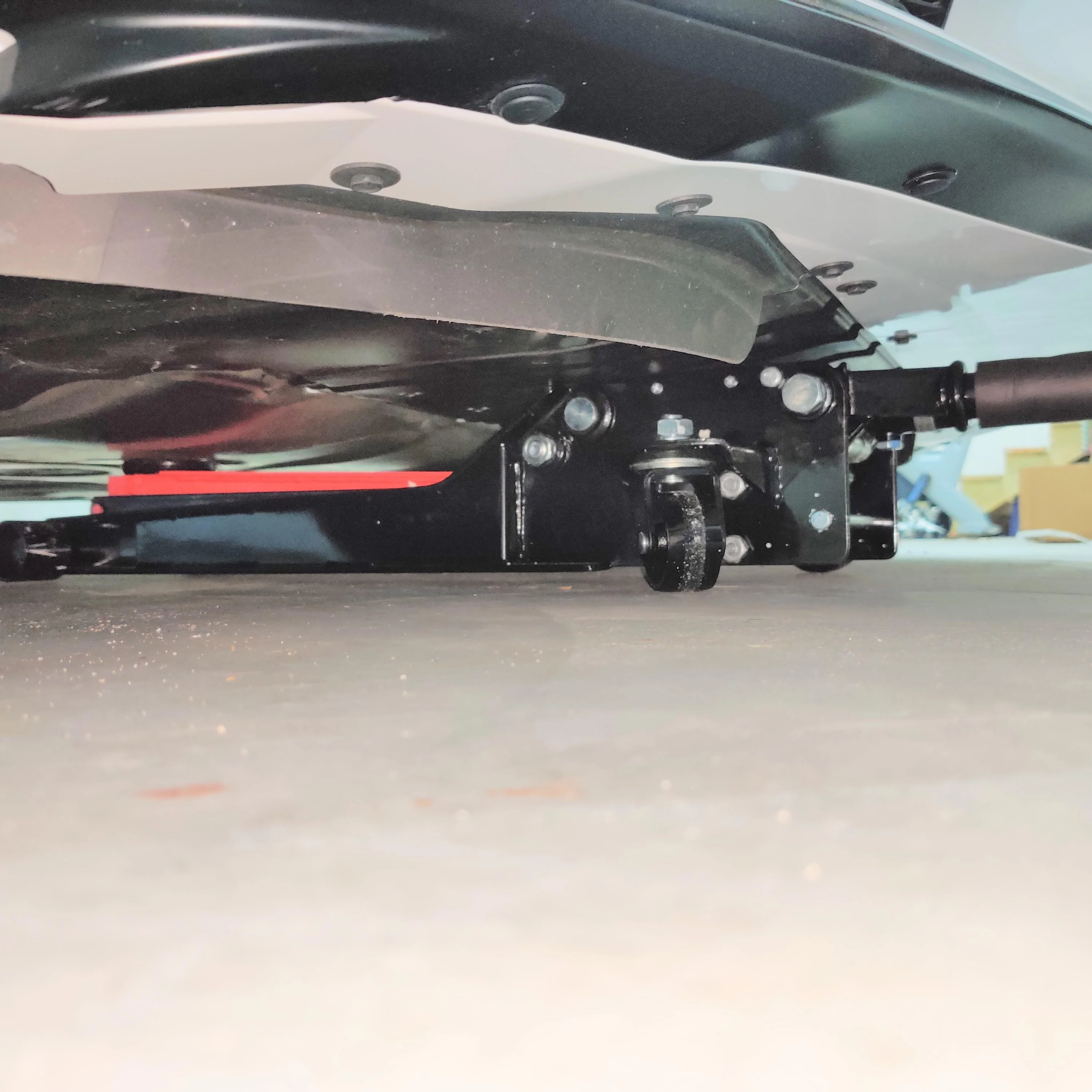

Probably spent a half day searching the internet trying to find the Omega 29023 Magic Lift. Its discontinued everywhere, except for one sketchy looking website that i don't feel like trying my luck. So I ended up getting the sunex 6602LP equivalent of the arcan XL2T (it's the same company, just different branding). You can reach the front center jack point without driving onto boards, but unfortunately it makes light contact with the under tray. Looks like there's no one-step solution to jack up the car without ramps or boards if you have a splitter or lower suspension.

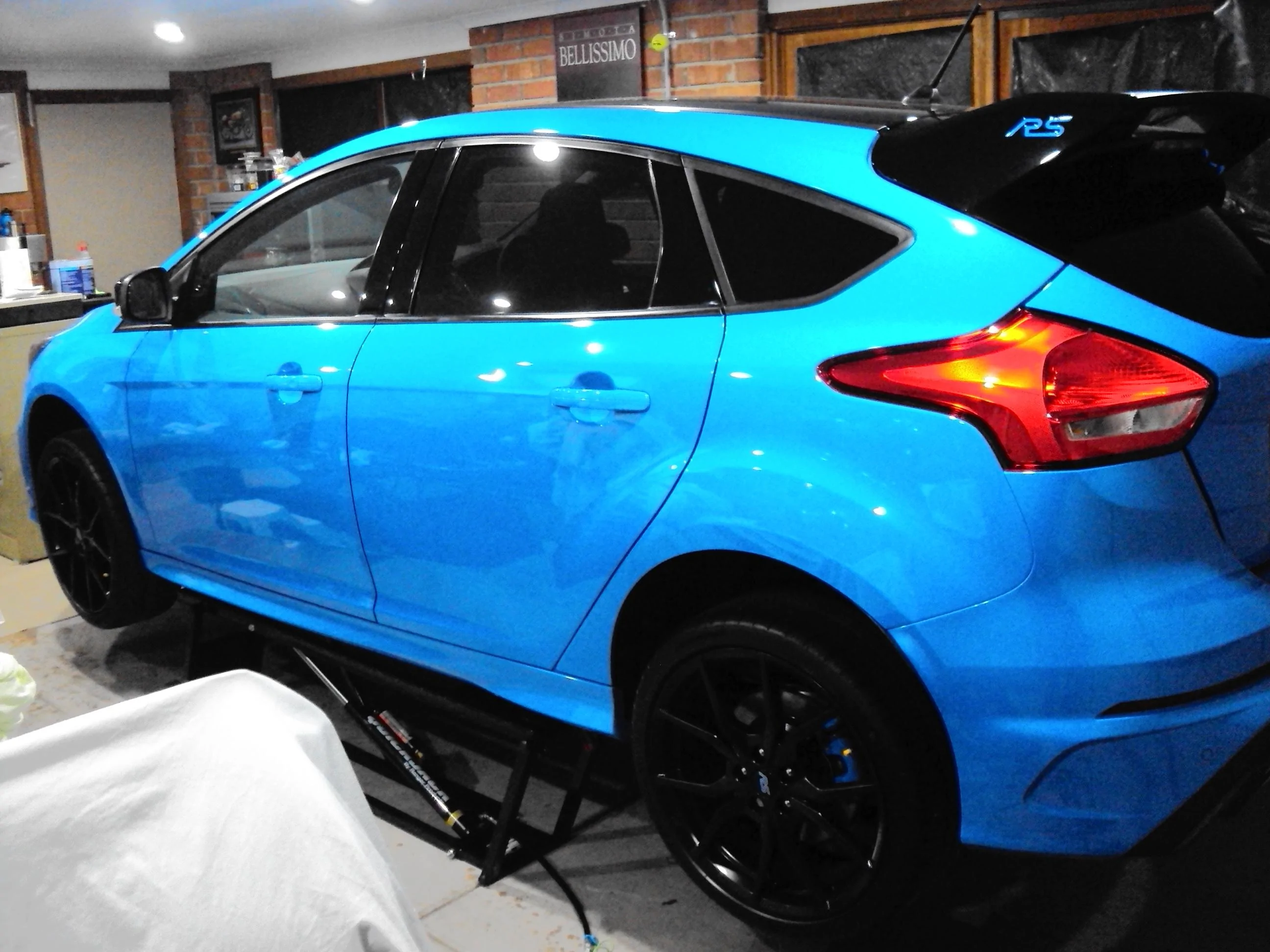

Quickjack 5000XL
One of the best investments in tools I have ever made, along my Easy-red racheting long wrenches and the Ingersoll electric 1/2 impact gun
Things I never knew how I lived without before I had them 😂

Quickjack 5000XL
If you can afford it and even if you can’t try saving enough so you can get one…this is definitely the way! Have used one before and was about to buy my own but bought a spoiler instead 🤦‍♂️ but it’s for sure my next big purchase for the car

Quickjacks
I have a set of 5000LB Quickjacks but I can't remember what the minimum height is with jack pd adaptors. I guess I'll find out if they fit the Supra soon enough
