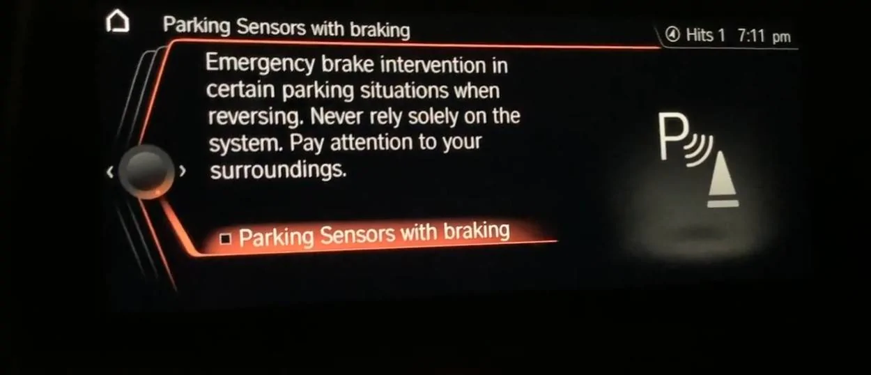

Is there a way to leave it off even after you restart the car?
Also, I’ve turned my system to FULLY OFF and when I reverse into my garage, it still slams on the brakes occasionally (even if there’s nothing in the way).
How can I fix this?
How can I fix this?
Pick custom and select what you want and they should stay, for a while at least. Sometimes I have to repeat the process.
As far as parking brake coming on in reverse, hit the top button on the center console with the P. You’ll see it change color and the reverse camera will go off. That way you can get out of your garage ? Laughing only because this has happened to me a few times when it thinks I’m too close. Scary as ? when the brakes slam on!
In the main settings menu, not the safety settings
raiu
Ben
Oct 16, 2022
76
2023 3.0 Supra, 2018 WRX STI
Wait.
How do I get here? If I turn it off here, will it be off even after I turn off the car and turn on the car?
