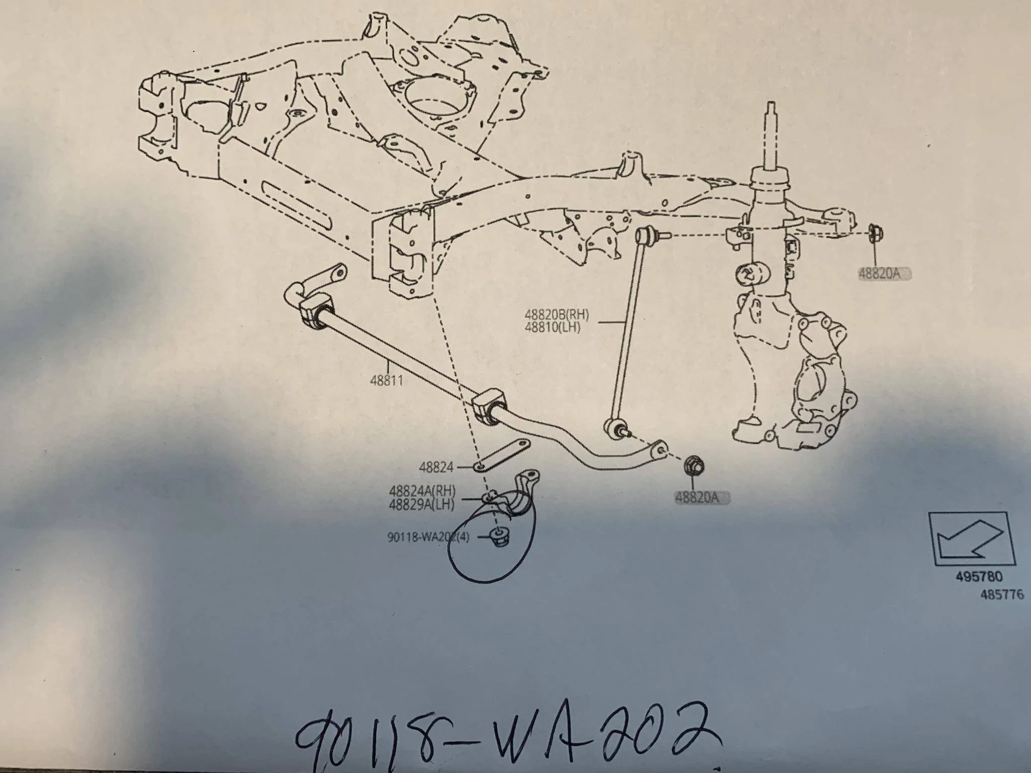

Yes, it was those nuts holding on the brackets.
The nuts are backordered from Toyota so I purchased some from BMW (P/N 31 30 6798572), put them on with loctite and double nutted them to be extra safe.
Lesson here is always replace those nuts when you're replacing the bar, don't reuse them.

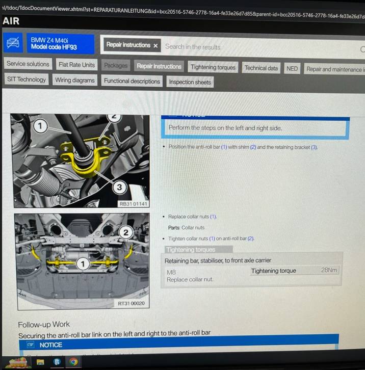

Does anyone know the torque spec on these nuts? I can't seem to find it anywhere.

Thank you!! I spent more time trying to find this info that actually installing the sway bar. Note to self, when in doubt search up z4 info.
