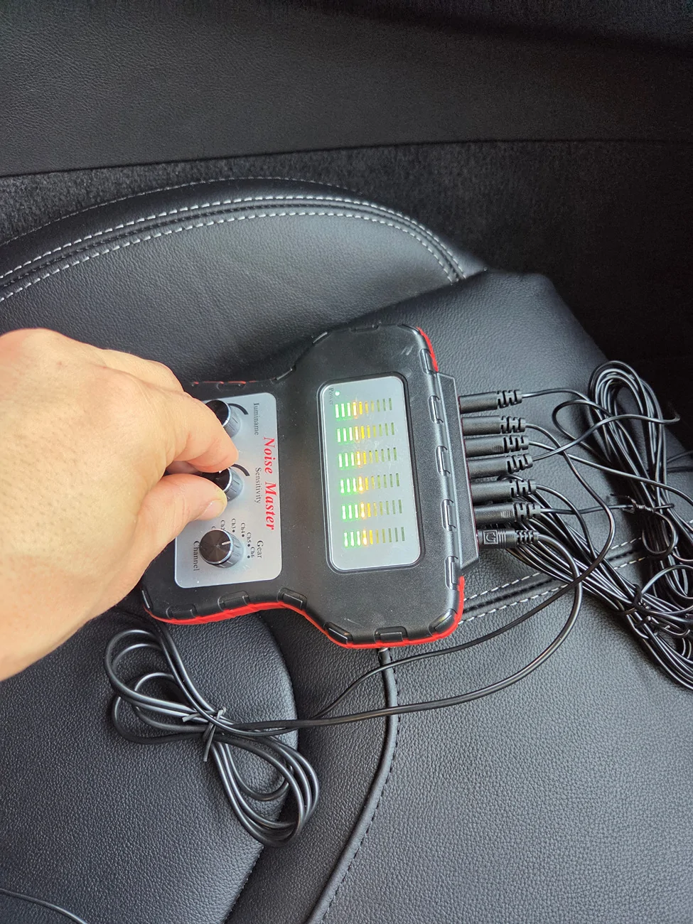

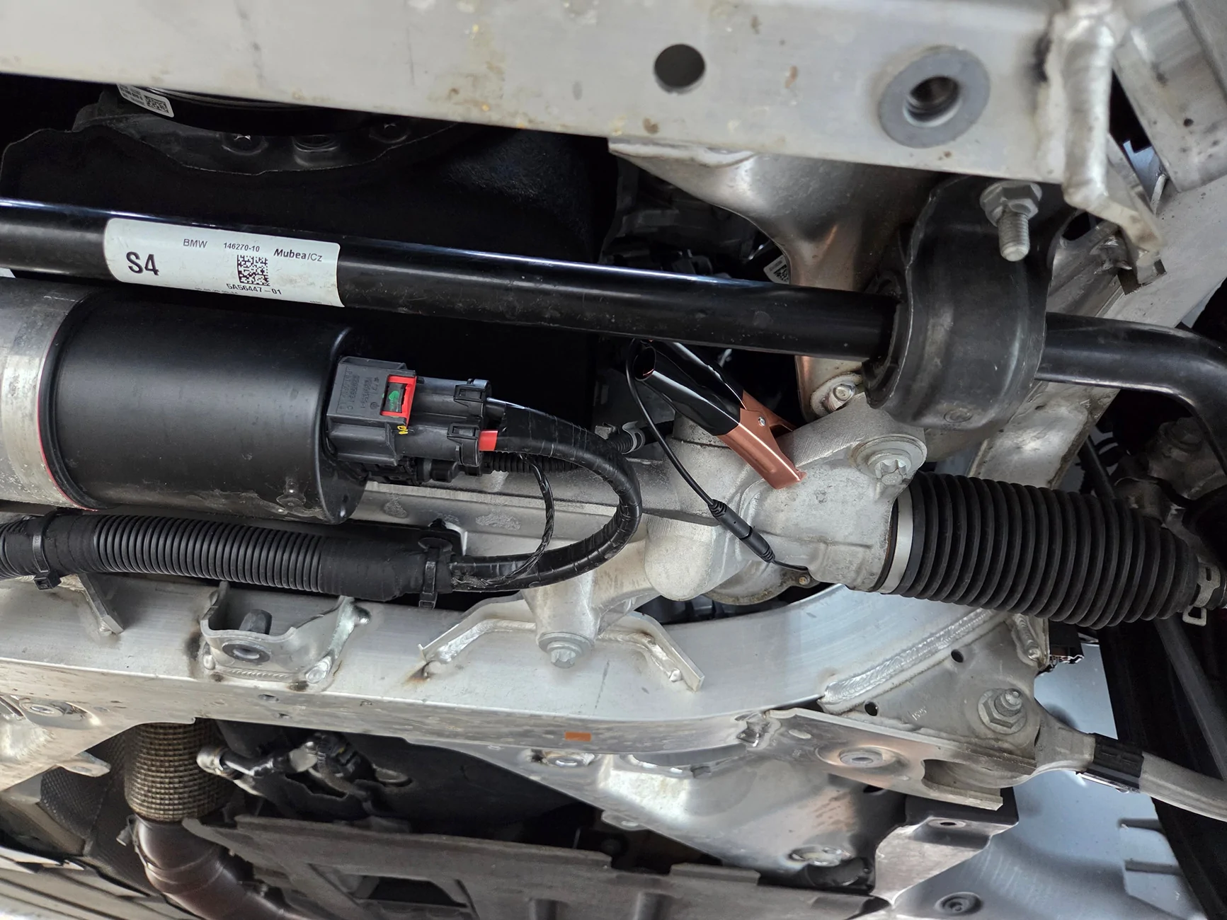

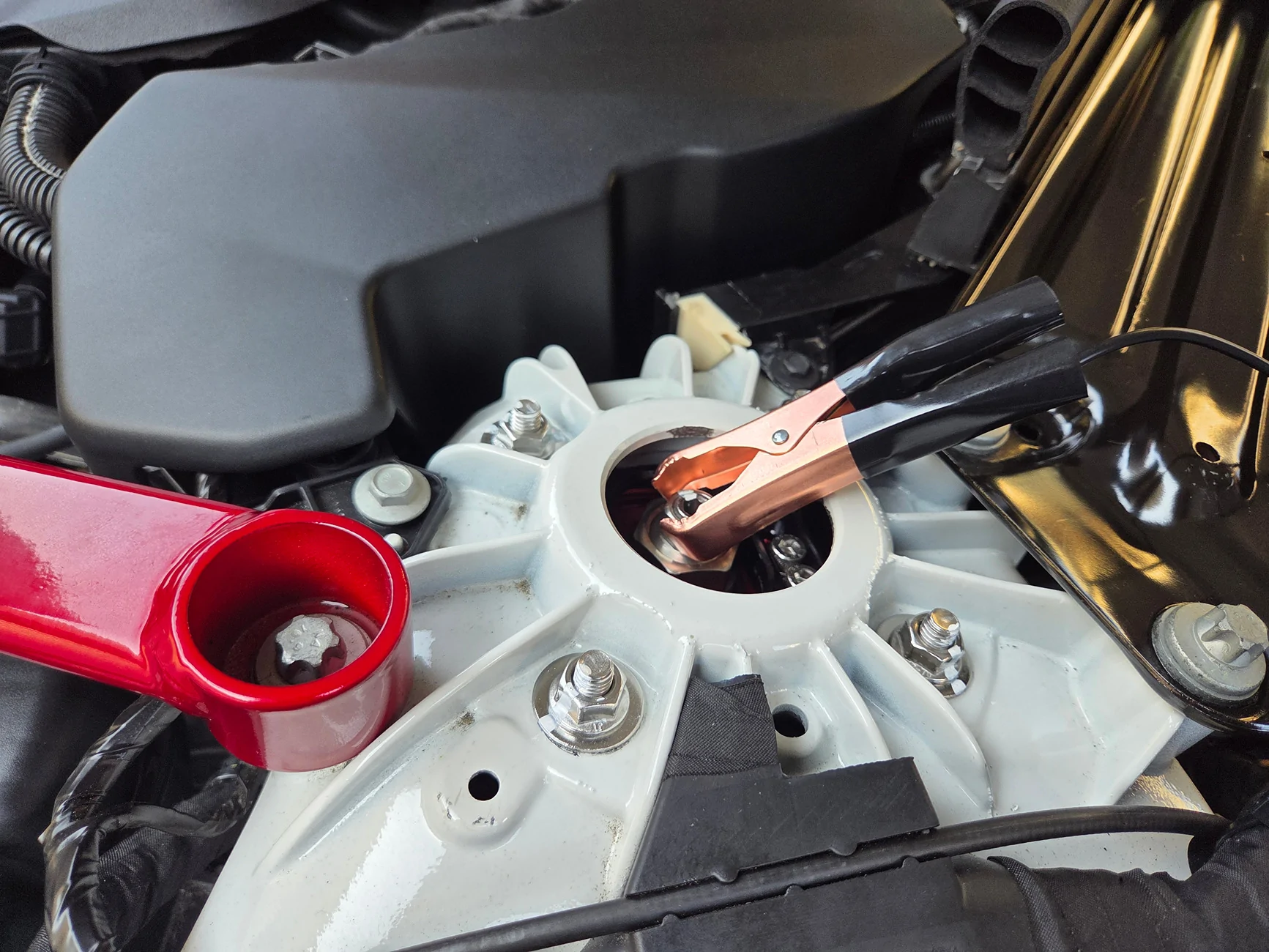

I also tried the chassis ear thing. I hooked it up to the driver strut nut, passenger strut nut, steering adjuster, driver spring and driver knuckle. The mics aren't equally calibrated, some are more sensitive than others, so it's something of a judgement call, but it seemed like the driver top nut was the nosiest of those.
