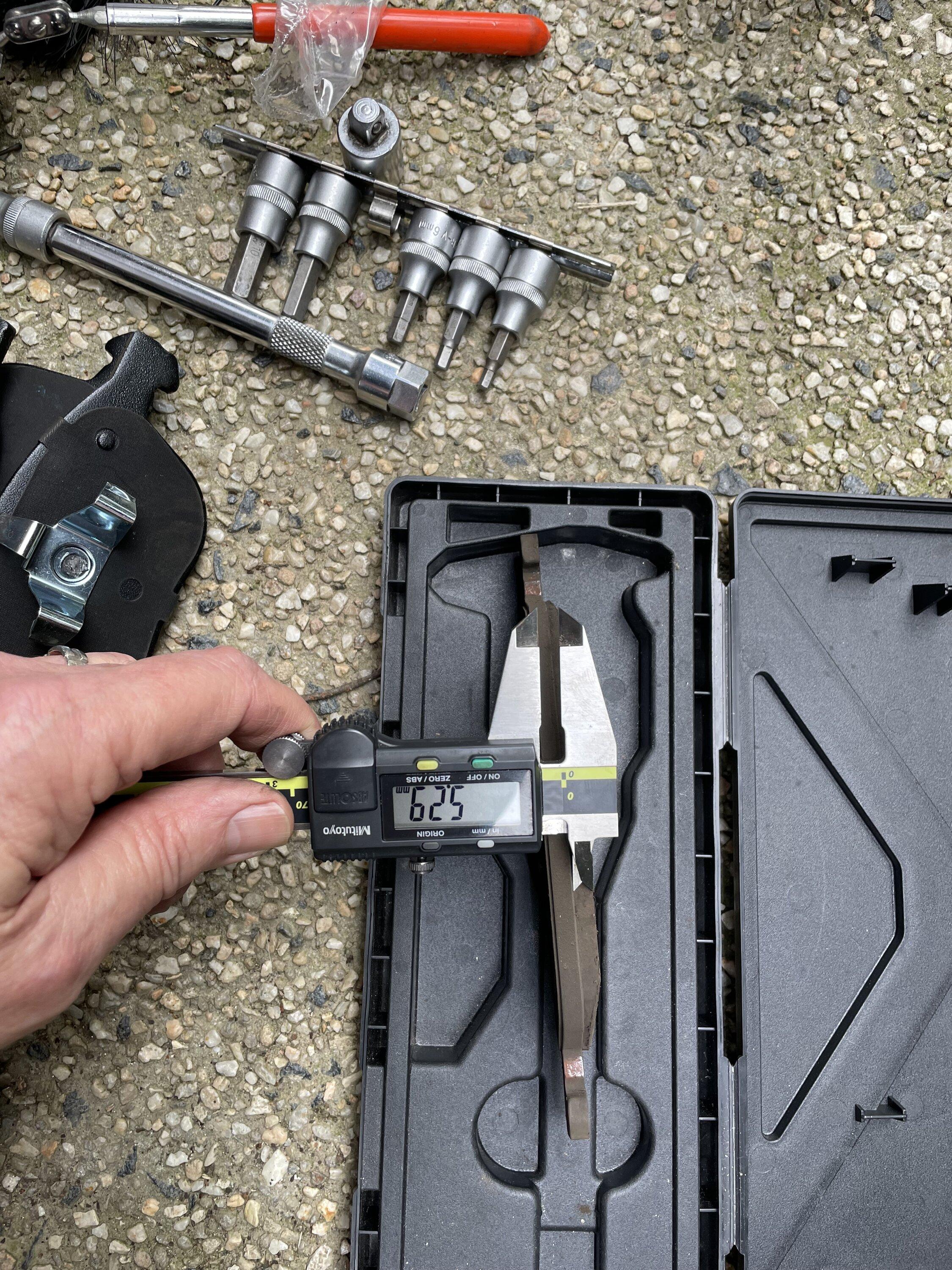

Here's a set of my Mitutoyo Vernia callipers. Note the rebate on the internal measuring faces that are 1mm or .040" on each face so you can measure over any outside lip if you position the callipers over the the disk in a semi perpendicular attitude. So unless the lip on the edge of the disk is over 1mm on each side then the callipers read the swept area face thickness just fine. So on my callipers you would need over 2mm total disk thickness reduction to need to resort to a mike. Obviously if you measure right on the min thickness AND the disk is badly grooved then the rotor is toast.

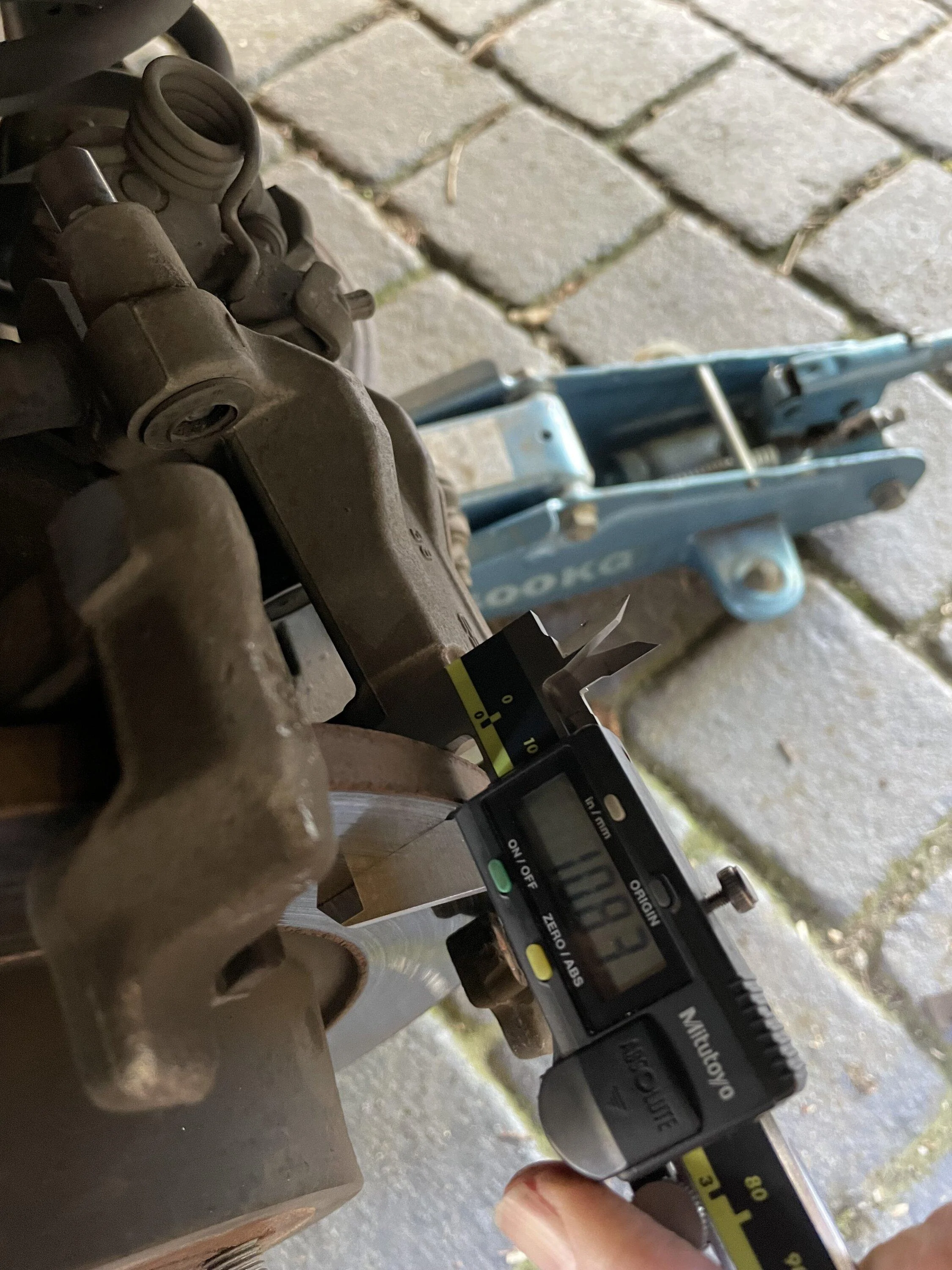

Here's actually an image of me measuring a rear rotor on my wifes car a few months ago. No problem with Vernier's. No lip in this case because the pad sweeps the whole rotor ( the front was the same) but you can see the technique and the way the measuring face recess on the Vernia works if a lip was present. So spend money on a tool that's good for one application or learn some engineering skills and techniques and buy a tool you can use for the rest of your life for many many applications. You choose.

Here's a set of my Mitutoyo Vernia callipers. Note the rebate on the internal measuring faces that are 1mm or .040" on each face so you can measure over any outside lip if you position the callipers over the the disk in a semi perpendicular attitude. So unless the lip on the edge of the disk is over 1mm on each side then the callipers read the swept area face thickness just fine. So on my callipers you would need over 2mm total disk thickness reduction to need to resort to a mike. Obviously if you measure right on the min thickness AND the disk is obviously badly grooved then the rotor is toast.
Phil
Thats fair, I am not sure if my calipers have that cut...or maybe they do and I have not thought about using that notch.

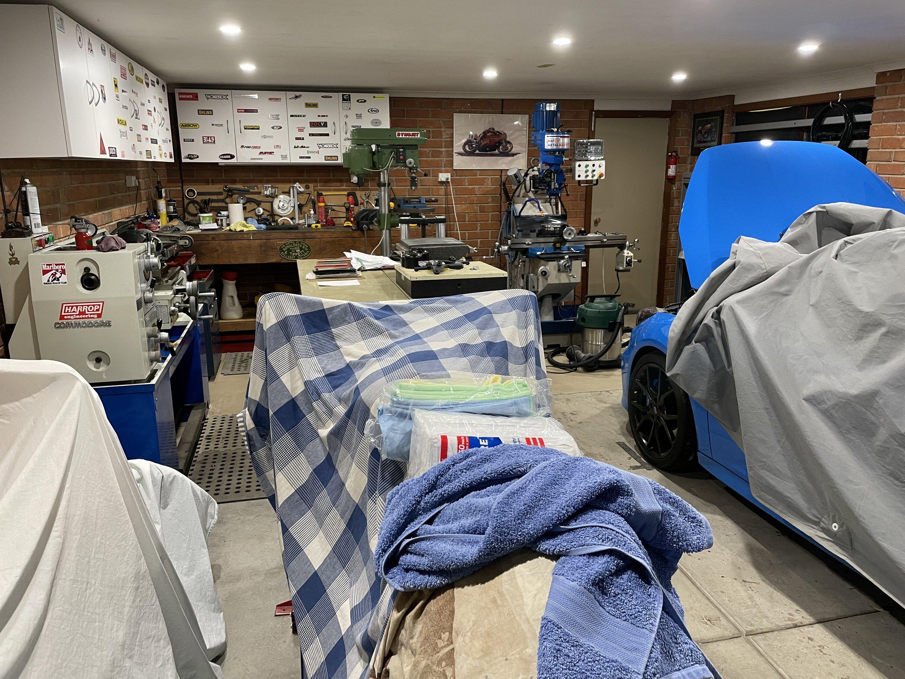

The object of my advice I give is to help the average person that doesn't necessarily want or need to buy specialised tooling for everything. Here's a picture of my garage and I have a cabinet full of measuring equipment as well but not everyone wants this.
Out of interest I checked the the max wear on the Supra front rotors it is 1.6mm under nominal so my Verniers and a little experience with the callipers will measure them just fine. So as I said if you Vernia them at 1.6mm under AND they are grooved then they are toast.

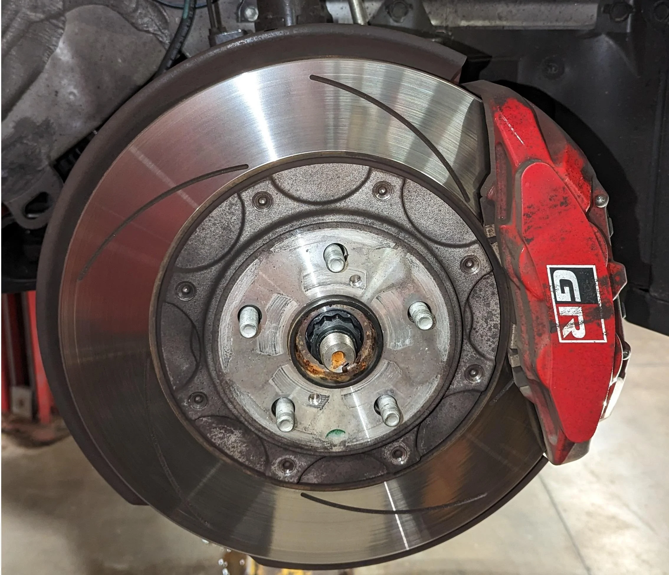

..aand here comes RT to flip your worlds upside down (except Phil, he's already upside down ;))...
I present to you, the GR Corolla front brakes!
Pads are a reasonable $120, and rotors are a budget-minded $810 EACH!
Is that an actual rotor or a double stuffed oreo? Asking for a friend. I remember when a rotor was one solid piece of steel.
