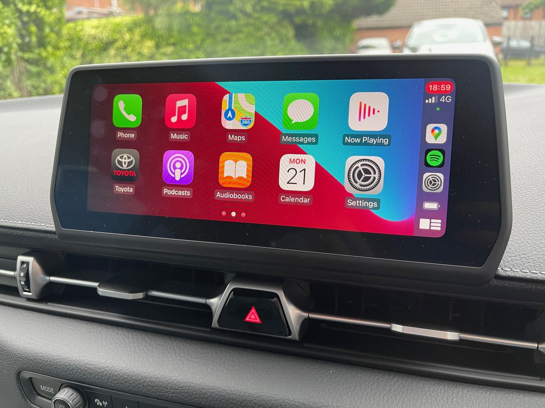

Another UK car done by Rob! Whole thing went smoothly, and it works fine! He also coded the stop-start memory and nav screen brightness while at it. Very happy with the result, thanks!
