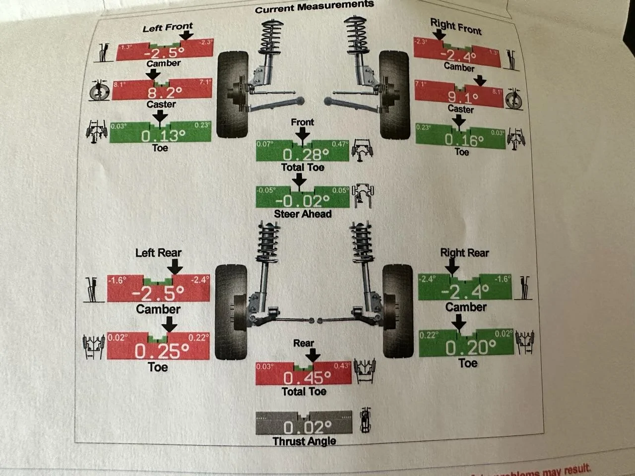

For tracking: front and rear sway bars always (on every track car I’ve owned since 2002). I’m a cheap bastard and every race shop I’ve been to, 1st thing they always do (besides seats). Lowering springs (coilovers eventually), every SPL upgrade available, track alignment (negative camber all around, pinch toe out up front, pinch in back). Feels incredible! I can’t wait to get the seat and a 5 point harness to push her even harder. Amazed how well this car can hang with any other brand out there on the track.
Edit: only my 2nd track day with her & basic setup above. Currently working on a steering angle sensor reset. Found out the car gets really pissed off without that done ?

Which coilovers do you recommend? I’m trying to find a local alignment shop with a Hunter wheel alignment machine to reset my steering angle sensor. Afraid to go to BMW or Toyota, lol. The car is really pissed off from my track alignment with lowering springs, but damn she handled beautifully on track.
