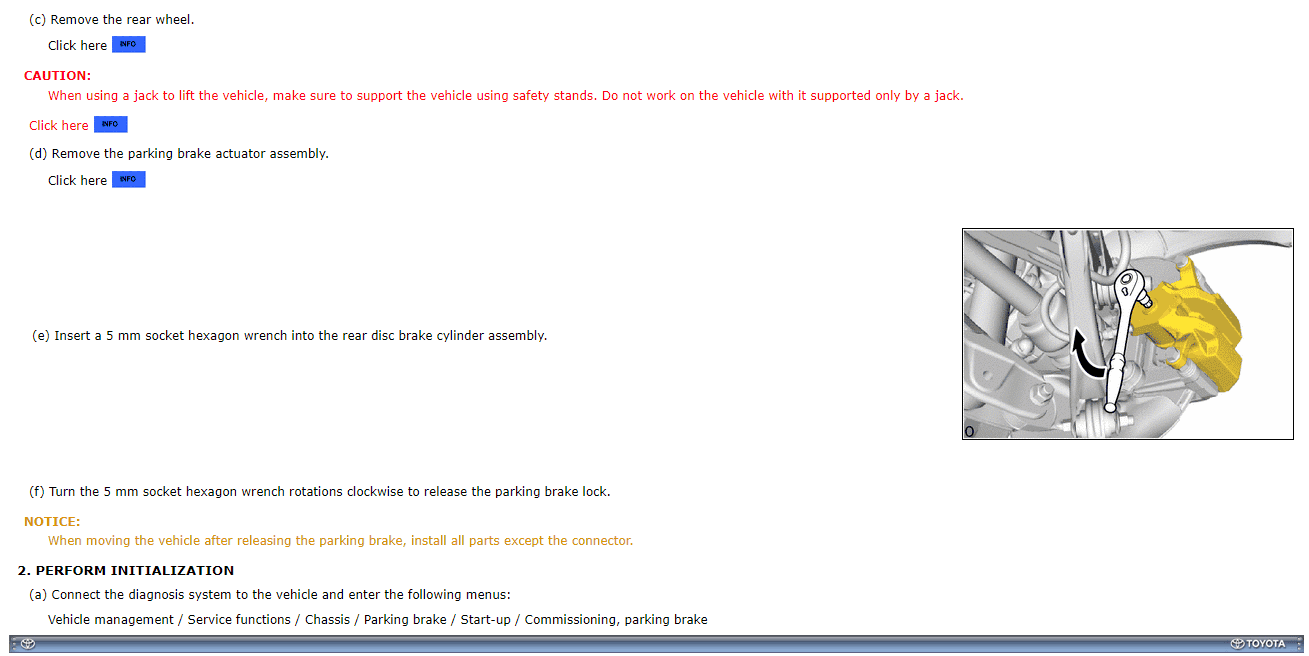

I meant after putting it in neutral. My previous cars all had manual e brakes. So I'm trying to figure out how one can disengage the electronic e brake without turning on the car. I guess what I meant to ask is, how can you push and roll your car if you can't start the car to disengage the electronic e brake ?

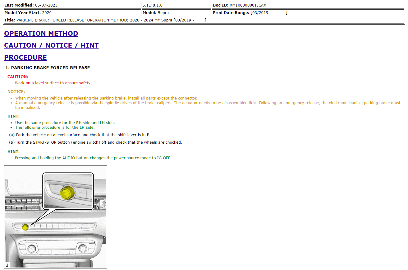

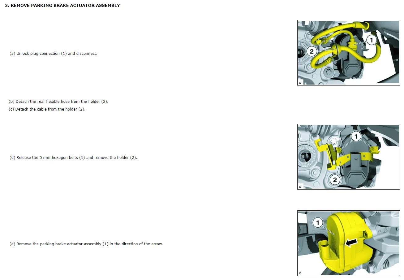

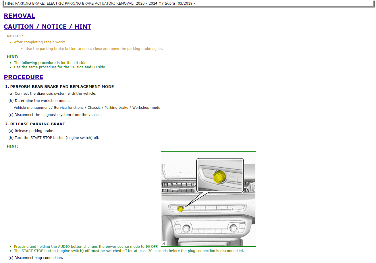

When I crashed mine, the electronic parking brake automatically applied, and we couldn't figure out any electronic or manual procedures to disengage it. So later on I decided to do the homework, and you have to remove the rear wheels and use an allen wrench/socket to twist a bolt on the back of the actuators. I'll find and post it up in a bit..

ACTUATOR REMOVAL:
BRAKE RELEASE:

Here you go, good luck getting to the bolt.
-RJM

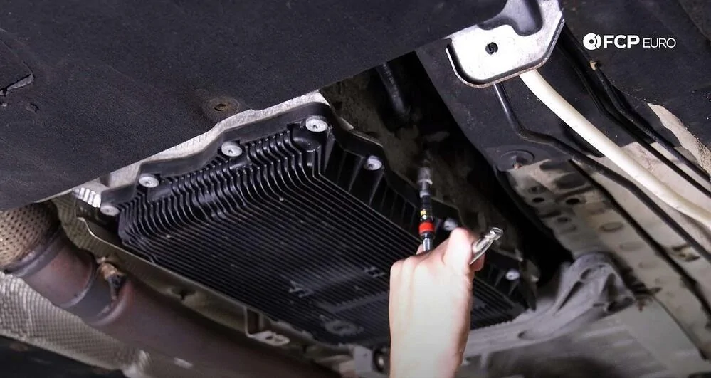

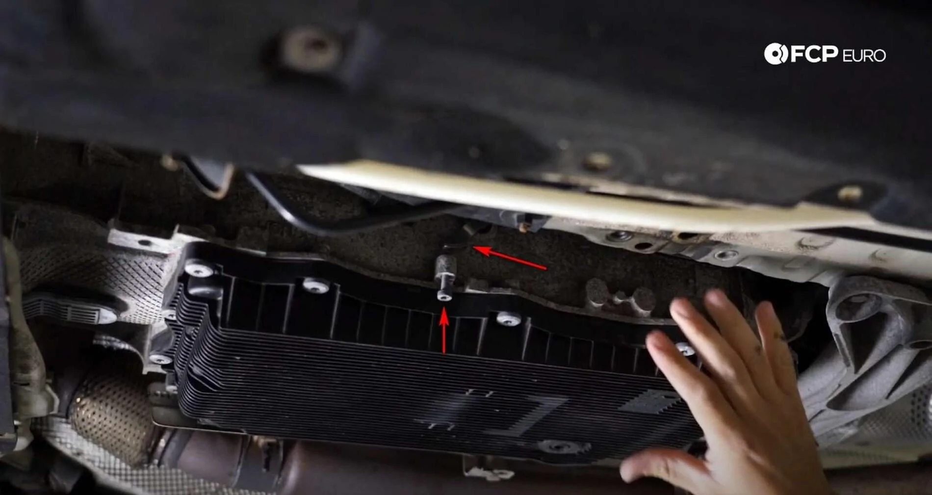

Where is the ZF 8-Speed Neutral Safety Switch Bypass Located?
The ZF 8HP neutral safety switch bypass can be found on the bottom of the transmission; there's a bolt positioned below a small foot that comes out of the transmission. That little foot is the manual neutral safety switch bypass. Depending on your vehicle, the location of this bolt could be obscured by various belly pans/plastic panels. You will need to remove these to gain access.
As you rotate the bolt to the right, the foot will move upward. As you push the foot up, the transmission will click into neutral, allowing the car to roll freely.
Tools Needed to Put The ZF 8-Speed Transmission in Neutral:
How to Put The ZF 8-Speed in Neutral:
First start by safely lifting the car in the air. We always advise using a quality floor jack and jack stands to support the vehicle. Once it is in the air, you need to gain access to the transmission. Depending on the car in question, this could be behind belly pans or covers.
Once you've gained access to the transmission, locate the hex-head bolt. Use a 5mm hex bit socket on a ratchet to rotate the bolt to the right. Listen for a click as you move the foot up. The click indicates that the transmission is no longer in park, and the car will roll freely.
After the transmission clicks into neutral, loosen the bolt until there is a gap between the bolt and foot. The transmission will stay in neutral and will be able to be shifted into park with a charged battery. Leaving the bolt tightened will prevent the car from being shifted into park once it is charged.

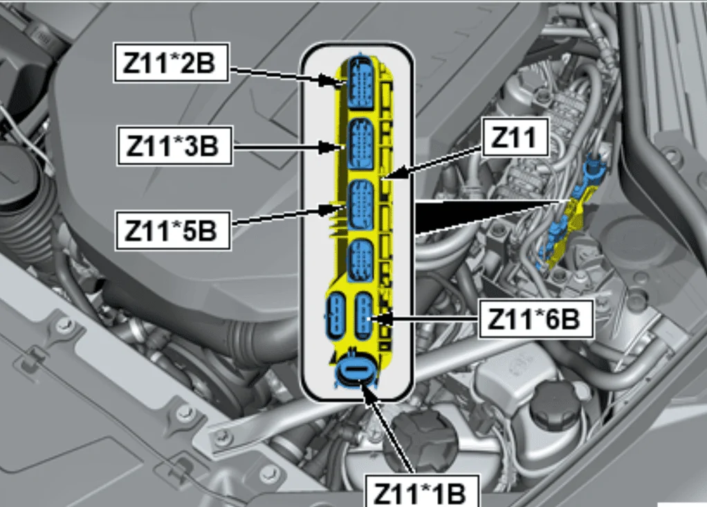

Unless you got lucky. Most if not all Supras do not have that bolt.
Remove the DME cover, and unplug the Z11*6B connector from the Integrated Supply module.
This cuts power to the Injectors, Ignition coils, and Vanos solenoid. This will in turn, not allow the car to start.
Get in car, crank the car, while its cranking put trans in neutral. TCM needs to see turbine speed to release the trans lock. It will stay in neutral for 30 minutes. whereas if you have to put it in neutral again, repeat the process.
