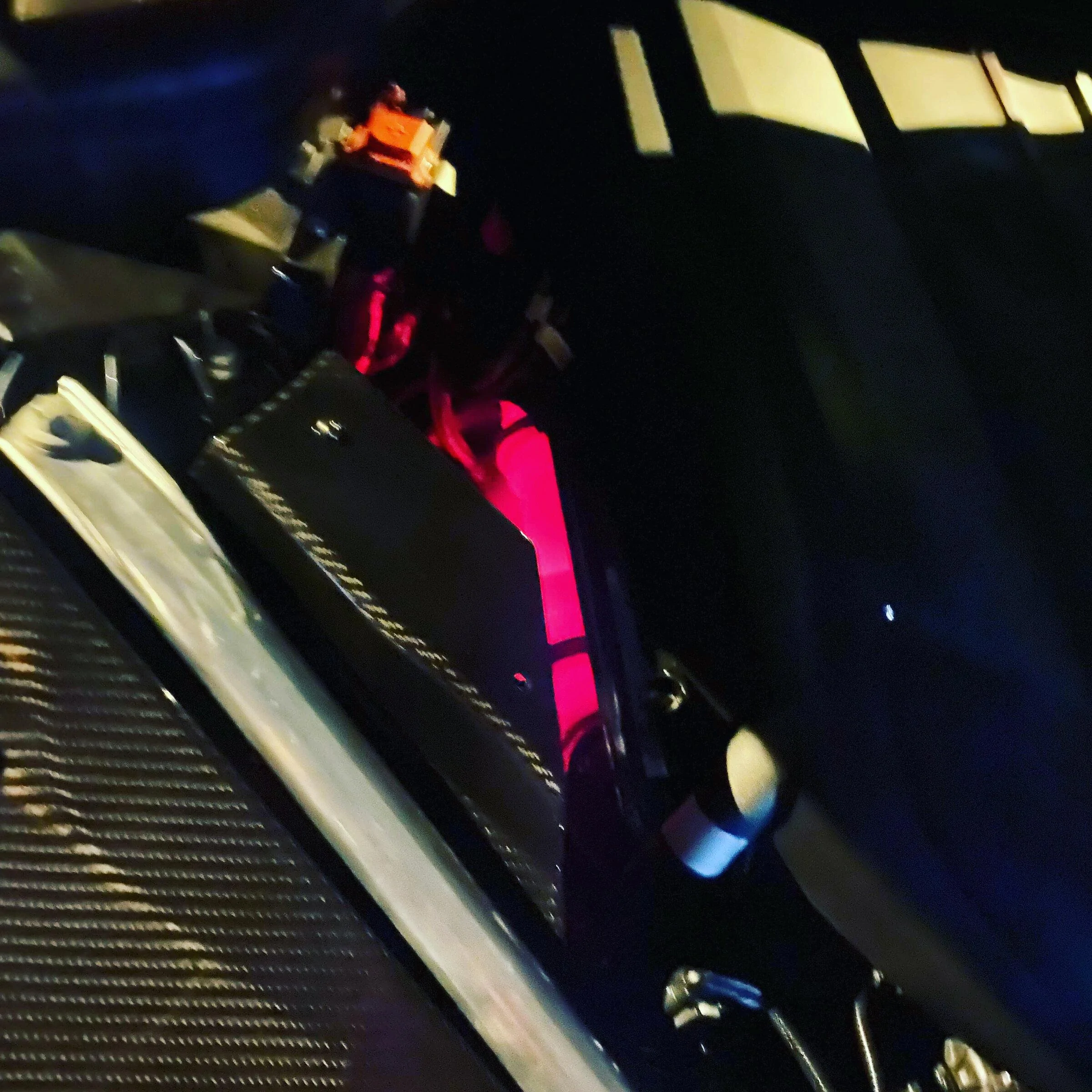

This was the only time back to back racing I’ve done with the car. It felt sluggish while it was glowing. Ran the car to let it cool but I bet it would have burned oil if I shut it off without realizing. It’s « ok » for turbos to glow under high stress but it will also shorten the life to get beat up all the time. I have catless sitting in my garage ready to go in this spring

This is my turbo glowing because of the stock cat. Can’t dump the pressure or the heat fast enough. If everyone on here is giving you the same advise and you still don’t want to take it, then I’m not sure why you asked in the first place
This is 100% normal on a turbocharged car after going WOT a bunch at night. Same thing during the day, just harder to see the glow. Most cars have heatshielding on the exhaust manifold. Supra does not, so easier to see. Cat or not. My Evo did that 100% stock and also now at 700hp with no cat.
Don't look at rotors on cars tracked at night, that will really blow your mind. ;)

This is 100% normal on a turbocharged car after going WOT a bunch at night. Same thing during the day, just harder to see the glow. Cat or not. My Evo did that 100% stock and also now at 700hp with no cat.

Again, that glow is 100% normal. Your post made it sound like it's a bad thing which is inaccurate. 100% normal.
People pay good money for shielding that keeps that heat in the turbo for better exhaust response.
