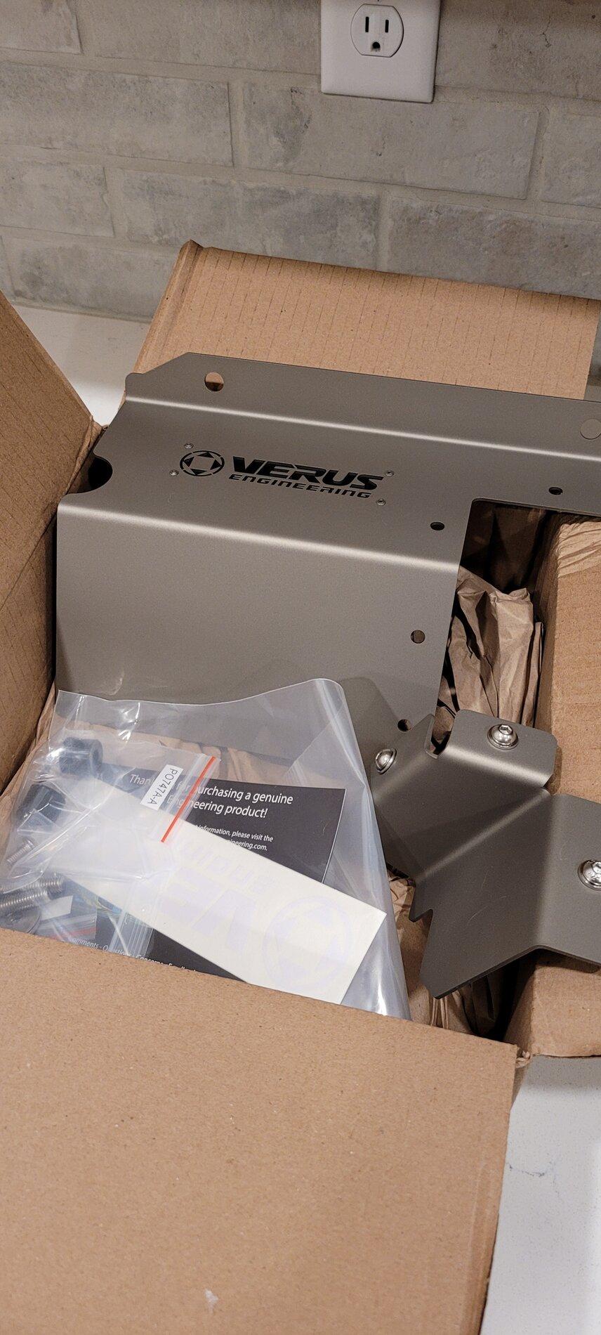

I have a duct aimed at that area and on the track- only place I care about performance- as long as I am moving it will blow across the shield.
So far 3 or 4 track day’s with shield. Temps are fine and I am also pushing more boost which has increased heat Have been happy with the performance here in hot and humid VA summer temps
I will update if possible. I do not have any extraneous temp sensors in the bay. I can only really watch IAT at this point.
Verus is track focused. I think for daily drivers and cars and coffe folks here it really won’t matter. Couple 50 rolls on the back roads won’t elevate temps like 20/30 min sessions at 5-6k

I took the same classes you did surely as I am an engineer also. Data bud, data. Slap some thermocouples on there, before and after, and educate us. Right now with no airflow, nothing is changing the heat dynamics. As a matter of fact, one thing that is surely happening is that the shield is acting like a heat sink.

If someone can send me some links of what to buy and monitor I’m happy to spend some $ and time mounting a couple in and around turbo and shield. I track several times a month. Plenty of hit hard runs to gather data.
https://en.m.wikipedia.org/wiki/Thermal_radiation
Next time you’re standing in front of something very hot, like a campfire or stove, and you can feel the heat on your face despite the air temperature being normal, stick your hand or a piece of paper in between your face and the heat source and see how that changes. You don’t need air flow to transfer a ton of heat when you’re dealing with an object as hot as the exhaust housing on a turbo. If you are an engineer, you should know that radiative heat transfer is proportional to the temperature to the power of 4. That’s a really big number when you’re at 1000 K.

I have the Verus 6 port turbo heat shield installed. Definitely helps reduce radiant heat from turbo housing. The next thing Im going to do is wrap the stock airbox with Thermo-Tec to help with keeping things cool. Also I have the Verus Hood Vent I want to install hopefully soon. I don't have actually data but any product that helps with heat reduction will be great to have.
