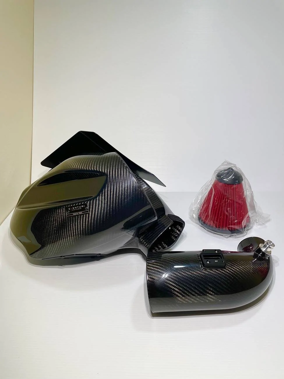

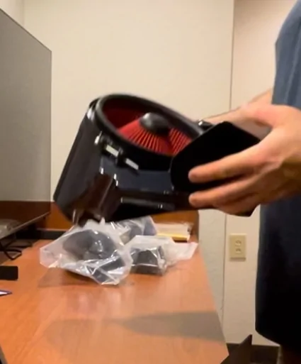

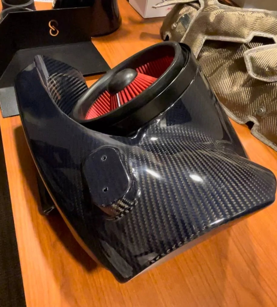

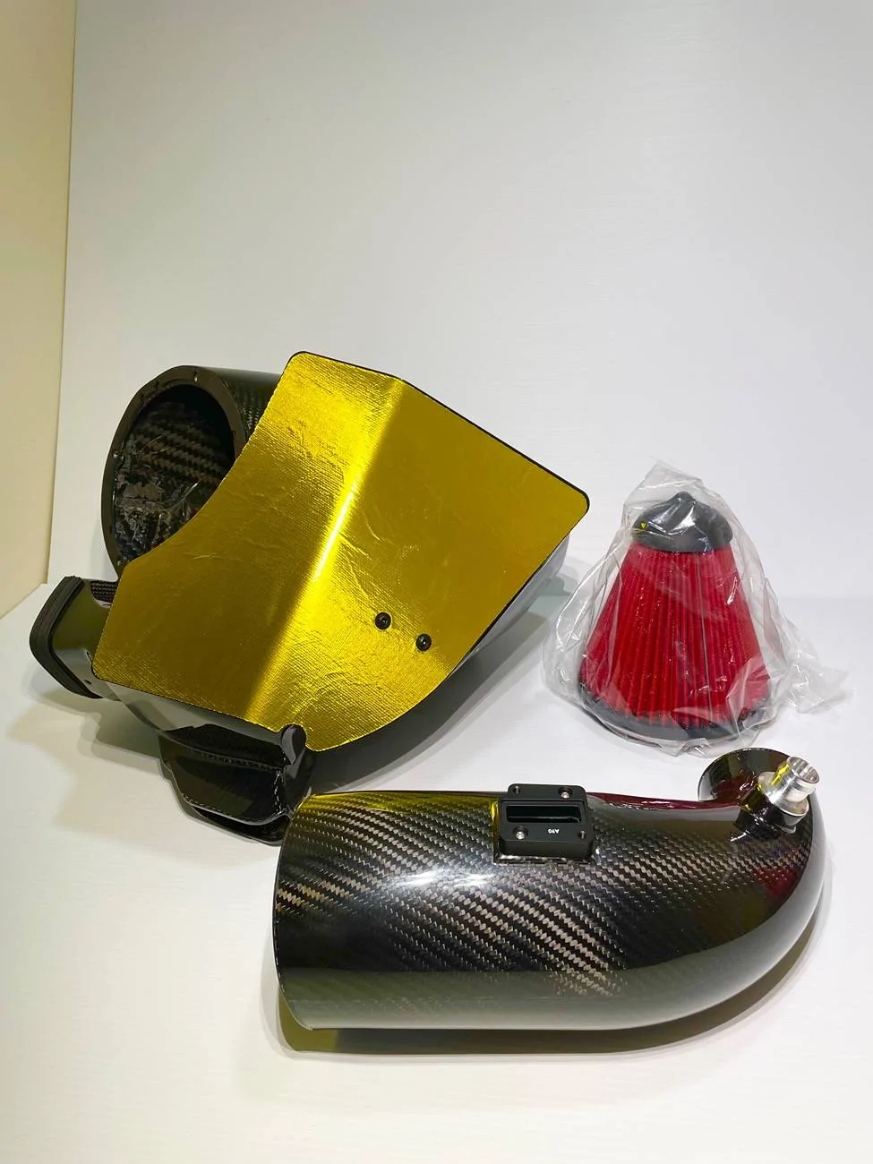

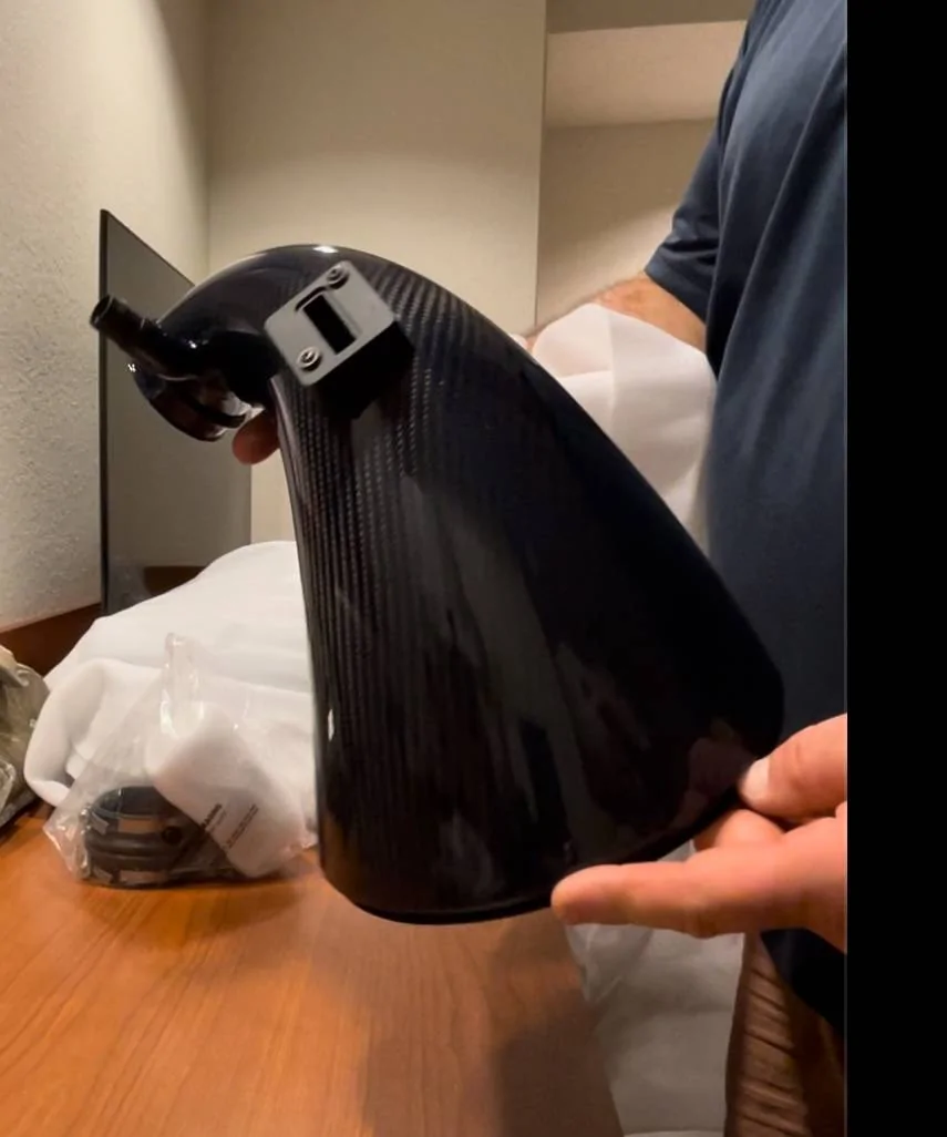

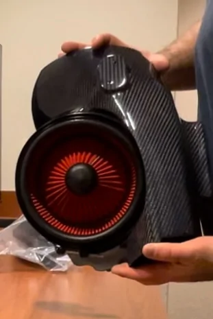

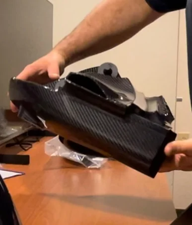

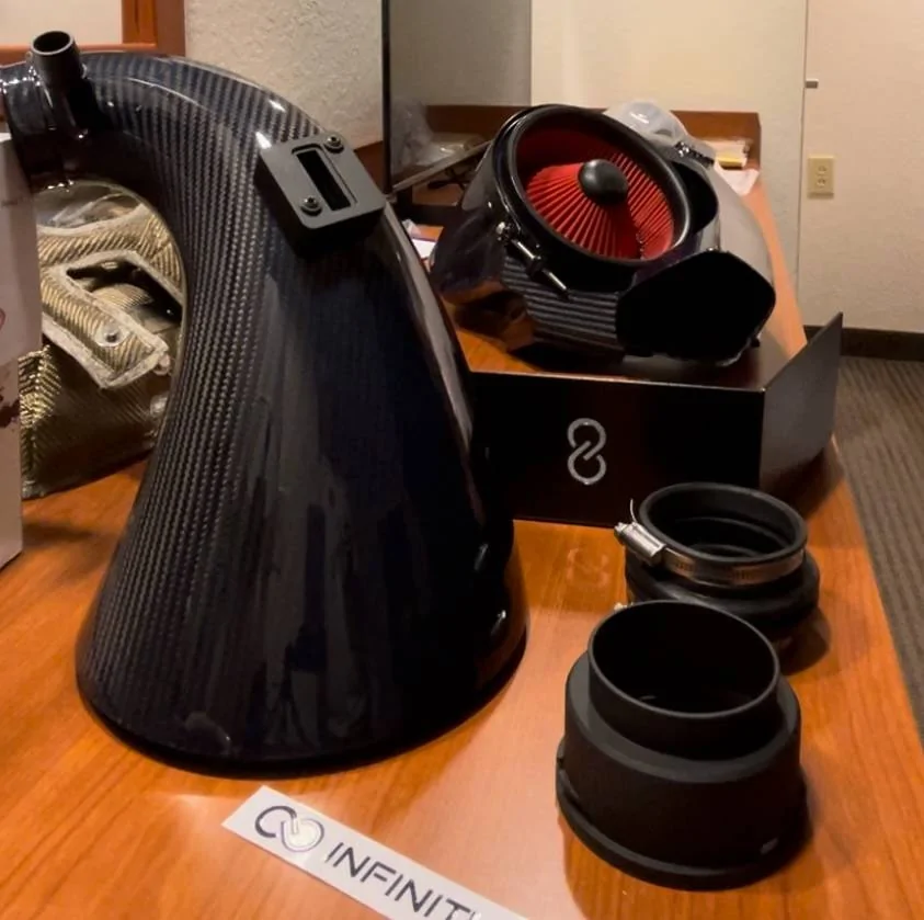

To expand on #1 as promised, the thing I like about the engineering of the ID intake that attracted me to it in the first place is essentially the amount of thought that seems to have gone into the part. I think it’s unique in that regard and seems like it might work well. See below:
-CF is a good choice of material for thermal resistance (but its $$$)
-they seem to attempt to make the CF high quality by using a dry CF and autoclaving manufacturing process.

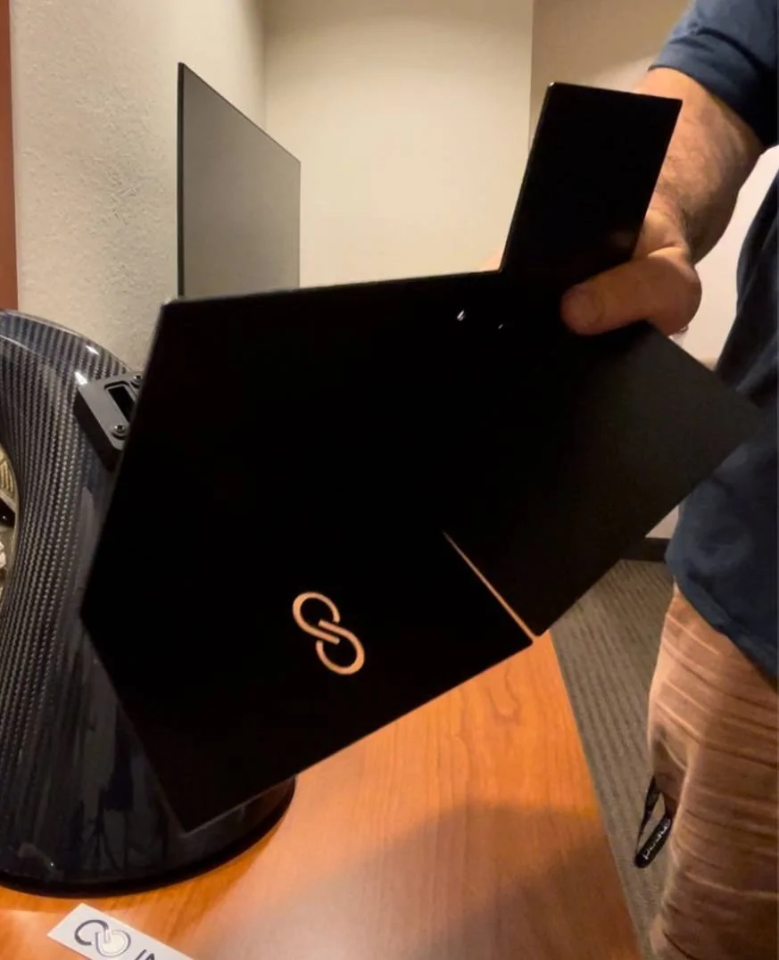

-the system comes with a bolt on heat shield that covers the manifold similar to a Verus or BMR heat shield so you don’t need to buy one of those now.

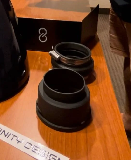

-the turbo inlet tube is basically a big ass venturi duct that ends in a machined billet inlet at the turbo (don’t have to buy an aftermarket turbo inlet because this one comes with a nice one already) coupled with a short silicone hose and clamps (I am concerned that this may be a turbulent point in what is otherwise likely a very smooth flowing system.)

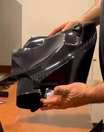

-the airbox is designed as a closed system (my understanding is that closed > open in Supra for intake temps) that utilizes the stock duct behind the headlight.
-additionally, the airbox draws air from two other locations that should be pretty much ambient also, one is an extra frontal opening below and central to the stock duct, and the other faces down and out projecting into a recess that communicates outside the engine bay.
-the airbox is designed to take advantage of all the space available where the intake sits to maximize volume. (It really hugs the contour of the engine bay but might be able to be even bigger on the top side though after seeing it in the car, especially if you remove the ever so crucial strut brace.)
-the cone filter is alleged to be the largest on the market (6 ¾”) and is shaped in such a way that it’s supposed to help improve the function/flow of the venturi section.
-more surface area of filter just about has to equal more filtered air flow per unit time.
-the company makes the claim that intake temps match the stock system, which made me want to find out.

Thanks for the review @zackarybyrd. Been comparing and considering different intakes for a while now. I'm deciding between this one, Dinan, or just a intake tube with the stock air box
One question I have about the Infinity Design: is it possible to remove the filter without uninstalling the whole assembly?
This is a gripe I have on several other designs like the eventuri where the the whole box has to come out to access the filter. It looks like it might be possible on this Infinity Design one, to just undo the main clamp and push the two sections apart enough to remove the filter... have you tried this?

yeah you can totally do that. It’s not hard at all.
