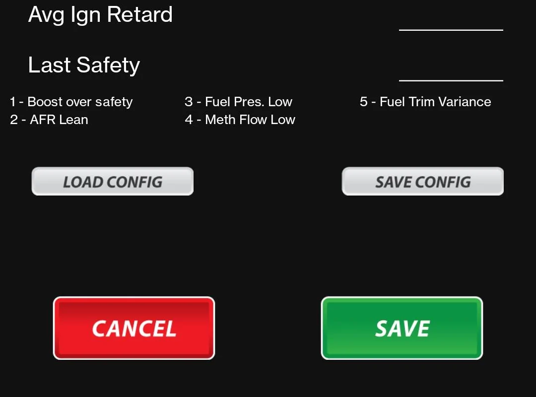

Thanks a ton! I'm actually not sure how to save more than 1 map 6 config from the app.
I can for sure feel the extra oomph those 2-3 psi give me. I really didn't want to go much higher anyways as it's my daily driver and I value reliability most.
I'll try this new Map6 and send you over some more pulls. Send me your venmo as well. :thumbsup:
