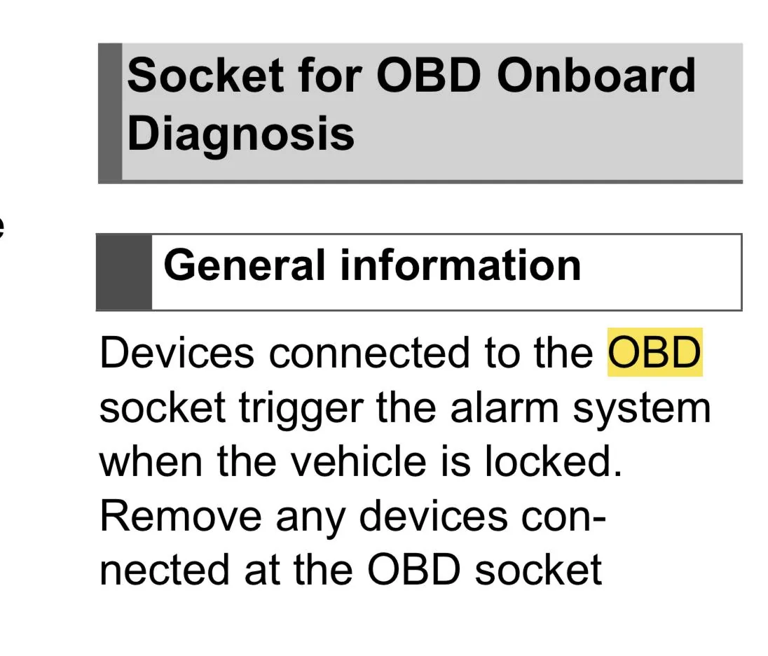

    257AFD4C-9923-4D03-AC6D-4BD4471F78C4.jpeg C940307A-4DC3-4BB3-B0A0-6DDD98E8FF43.jpeg
    Yup got the app, been playing around with the “demo car.”

    The Bluetooth connect kit has nothing to do with the OBD2. its for controlling the JB4 with a mobile device. The obd2 connection will activate the steering wheel controls and etc. And add some of the needed logging stuff thats fed via the CANBUS.
    As for triggering an alarm. This is 100% true. However, in more detail it means if there is an "ACTIVE" connection to the ecu while the car is locked. As long as the connection is not ACTIVE/Connected. The alarm will not sound. JB4 disconnects with ignition off when wired correctly. So it shouldnt be an issue.
