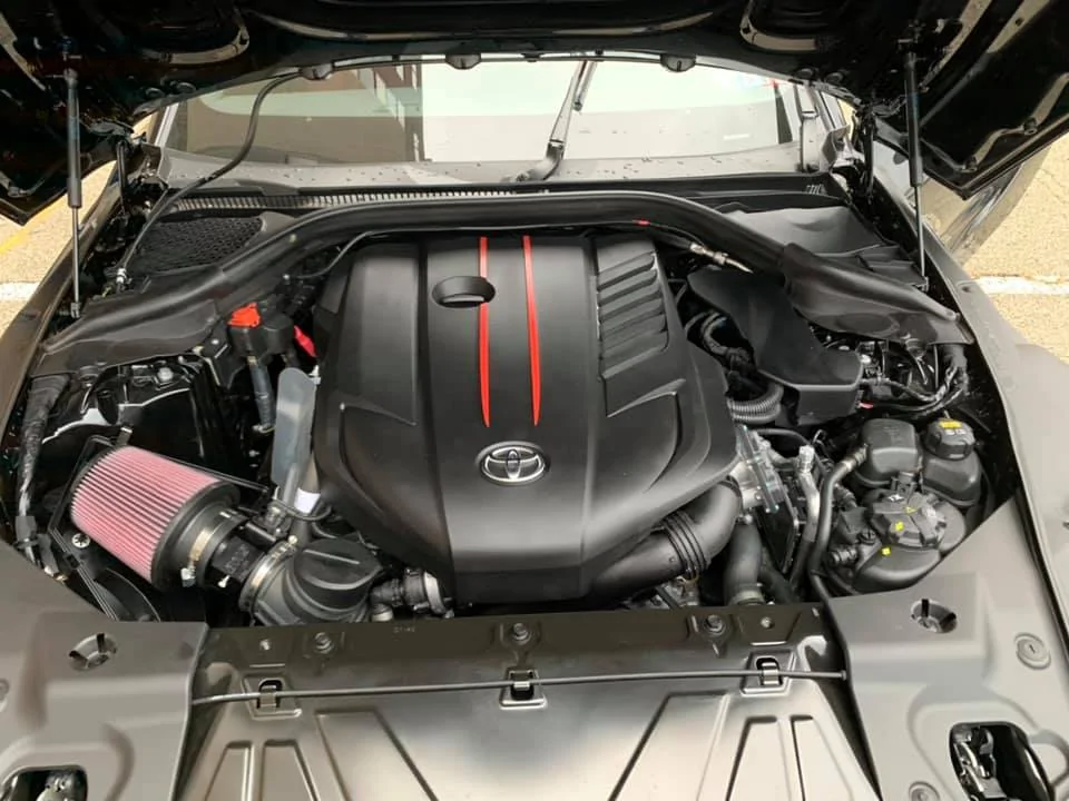

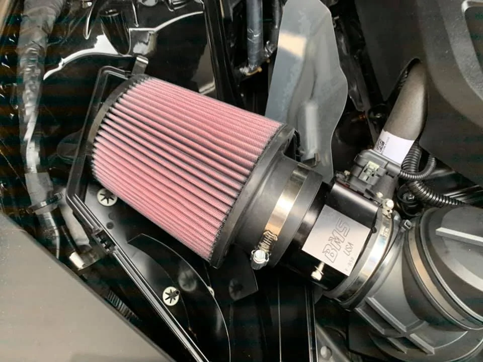

Is that the updated intake with a mounting bracket? I heard the originals had fitment issues?
Also read that the stock intake is doing better than the after-market options that are open to the engine bay...Too much heat getting in...

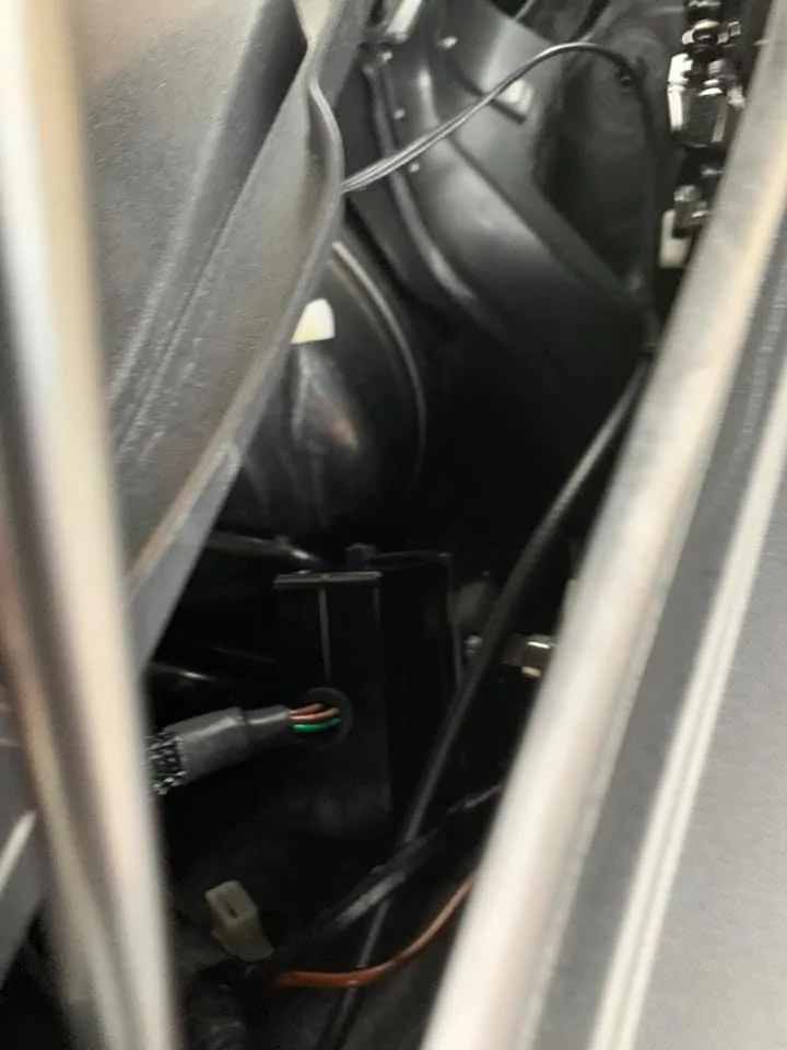

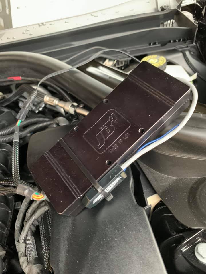

Guys, I installed my JB4 with the Bluetooth, the only thing I'm suffering with is finding a place to route my OBD cable through the firewall.
Man this firewall has no good access on either passenger or driver sides!!
I saw two large grommets on both sides but I can't locate them on the engine bay side.
Go from the inside the car and poke a hole out. Look under the driver's side you will see a black rubber grommet. Use a screw driver and poke a hole out. Then go under the hood and look for the hole right next to the round metal device. If you are facing the silver metal device, it will be on the right side. Hope this helps.
