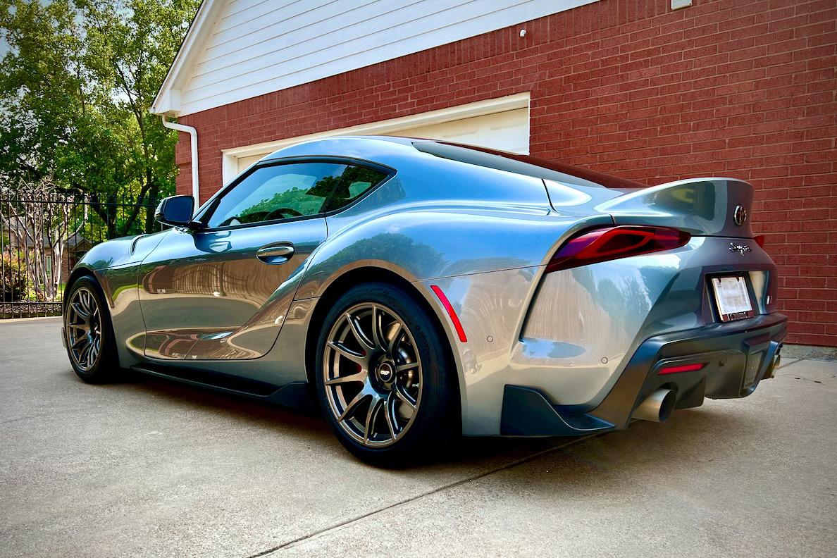

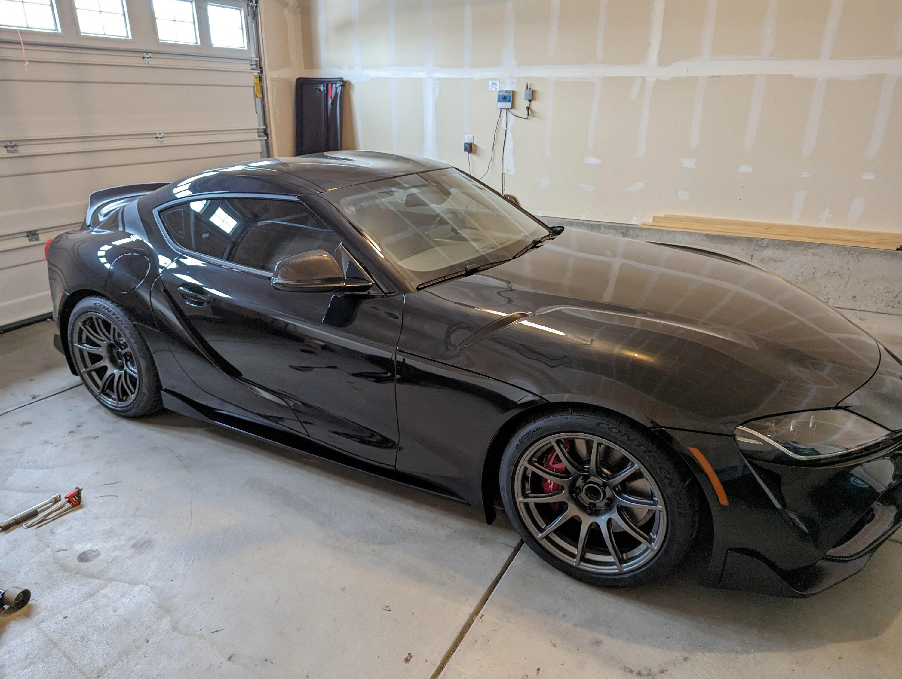

Installed Apex SM10 18x10 ET30 front and 18x11 ET40 rears with Conti EC sport 2 F 265/40 and R 295/35's. Definitely more grip than the stock Michelin PSS. HKS springs, MAPerformance DP, and HKS super turbo exhaust to be installed next week.
I went the same route as you, love it!
Shitty picture of mine

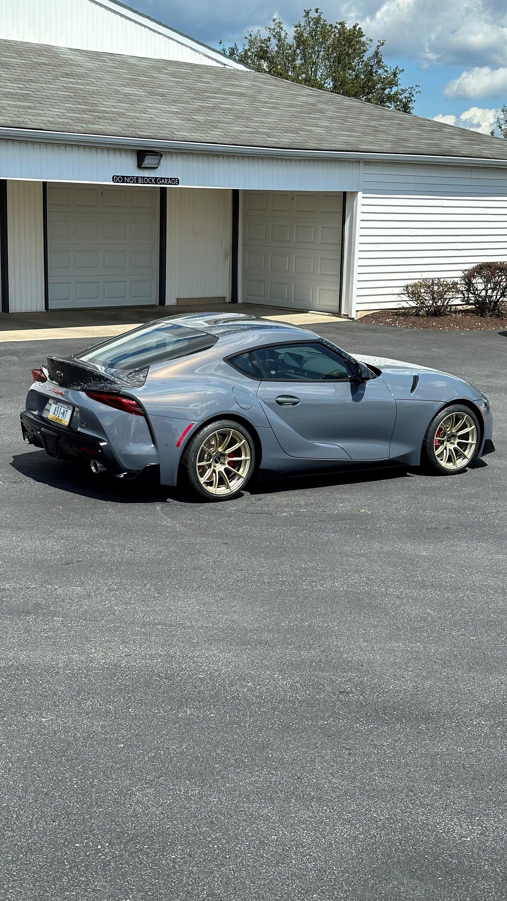

Installed the Apex SM-10RS in motorsport gold about a week ago 18x11 +40 and wrapped in Continental ECF 295/30. Really wish they were offered in a 35 sidewall profile cuz the wheel gap definitely grew a bit more than I would have liked. Just have the HKS HAS kit to make everything fit for now with the SPL FLCA sitting in a box until I get some more time to work on the car.

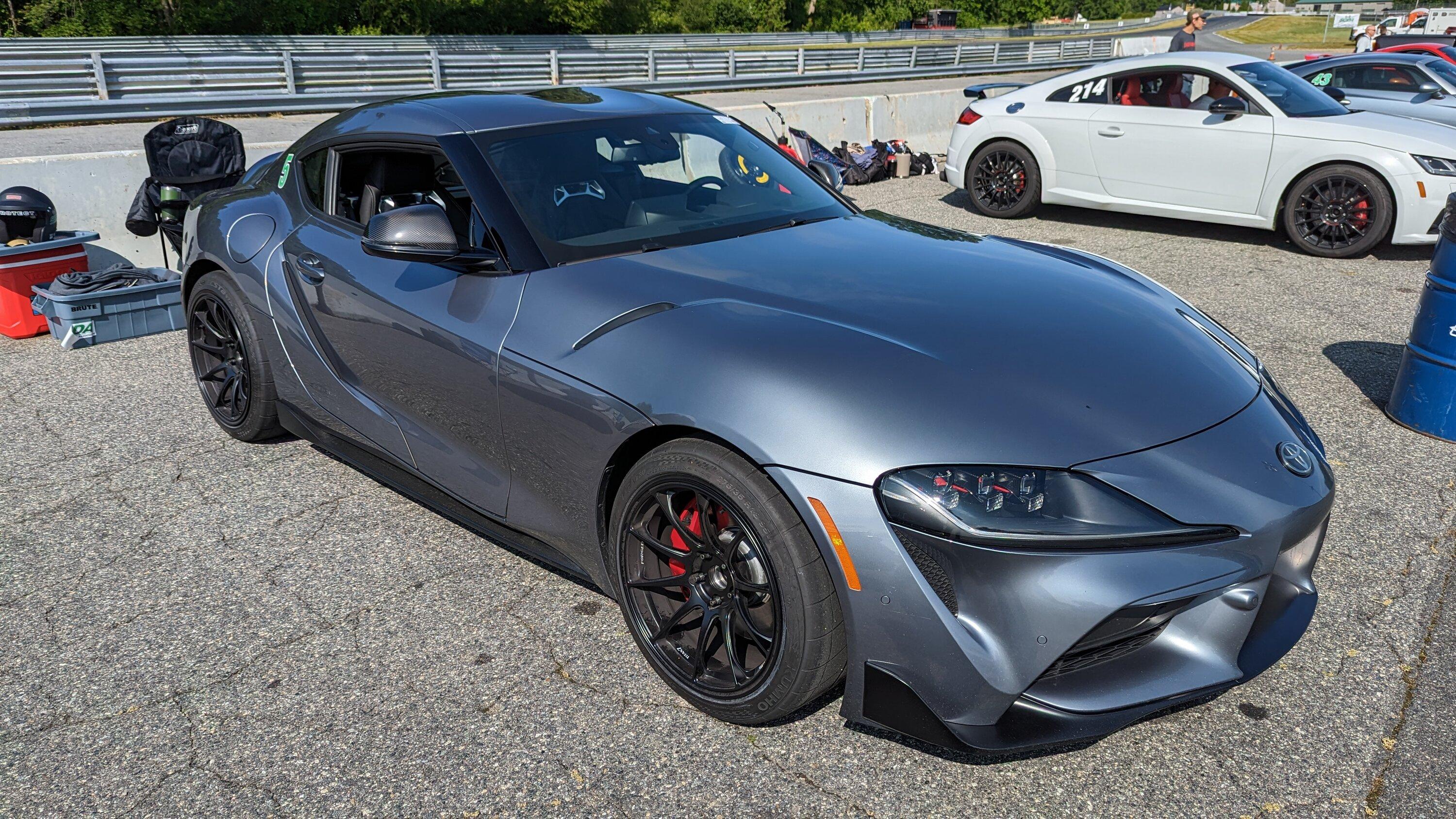

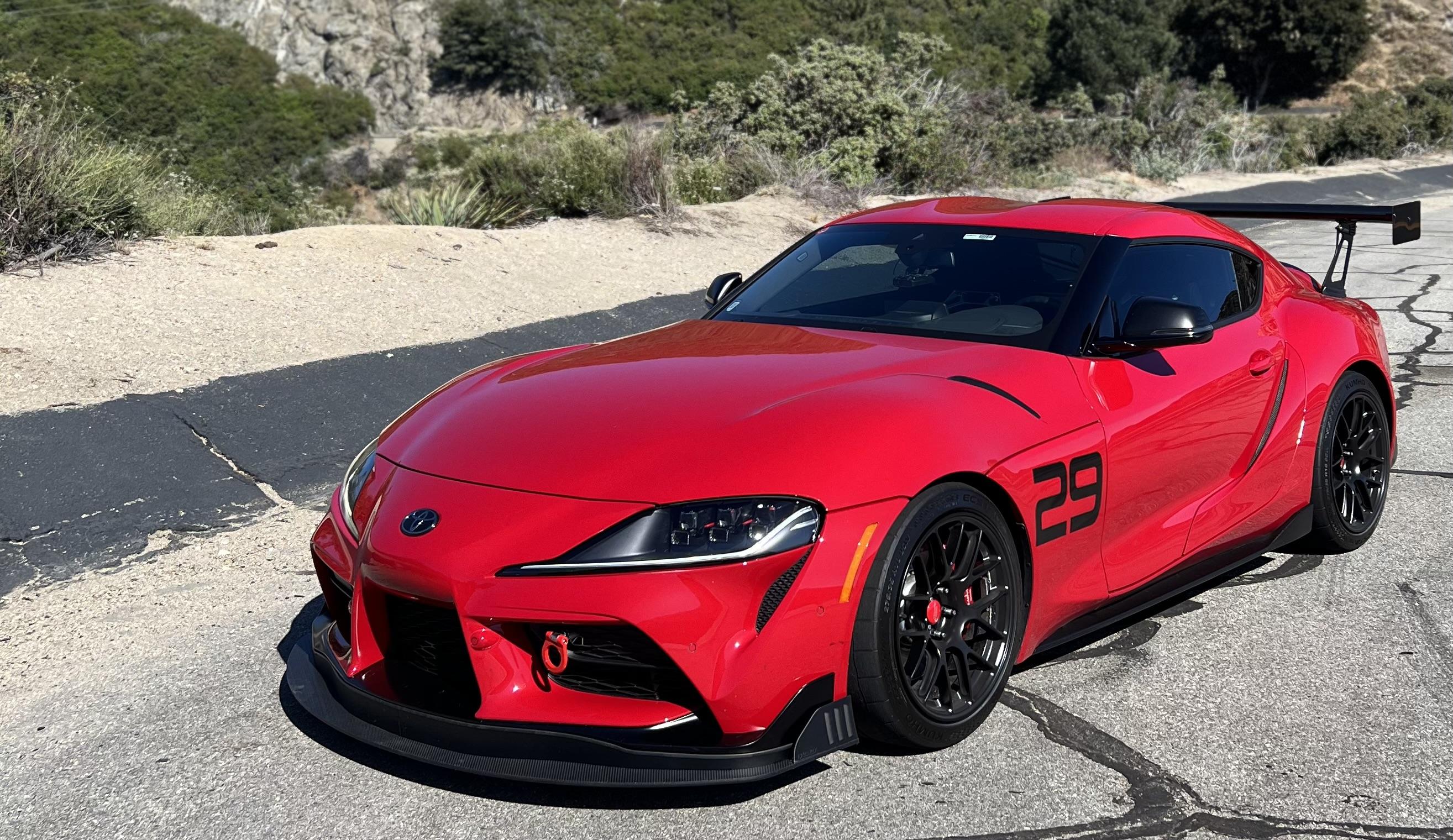

Here's a picture and a walk-around of the Apex EC-7R, 18x10.5 square with 275/35/18 V730 tires. Red center caps from apex.
Beautiful! I have a square 18 Apex setup. Planning on Hyperdiping them. Not sure how long that will last on track. But my stock wheels have held up well after being ā€œdippedā€ (aka spray can ? epoxy)
275-35R18 V730 square on Titan7 T5-R with 15mm Motorsports Hardware spacers. Stock springs and dampers, -3.5 degrees of negative front camber.
Once I go to coilovers the spacers will come out and I'll be 15mms lower.

You think a 275 40 would clear the stock suspension with those wheels?

If I recall correctly, I don't think so. APEX has a fitment guide on wheel set ups that was helpful. I like those 18's but was second guessing after I pulled the trigger. No regrets once mounted and get comments all the time when filling gas or parking.
