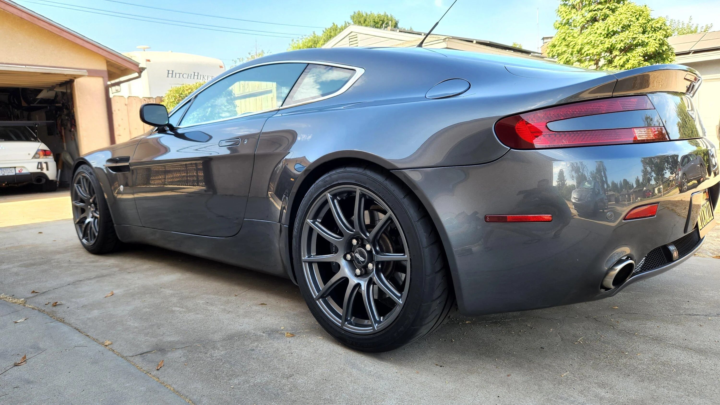

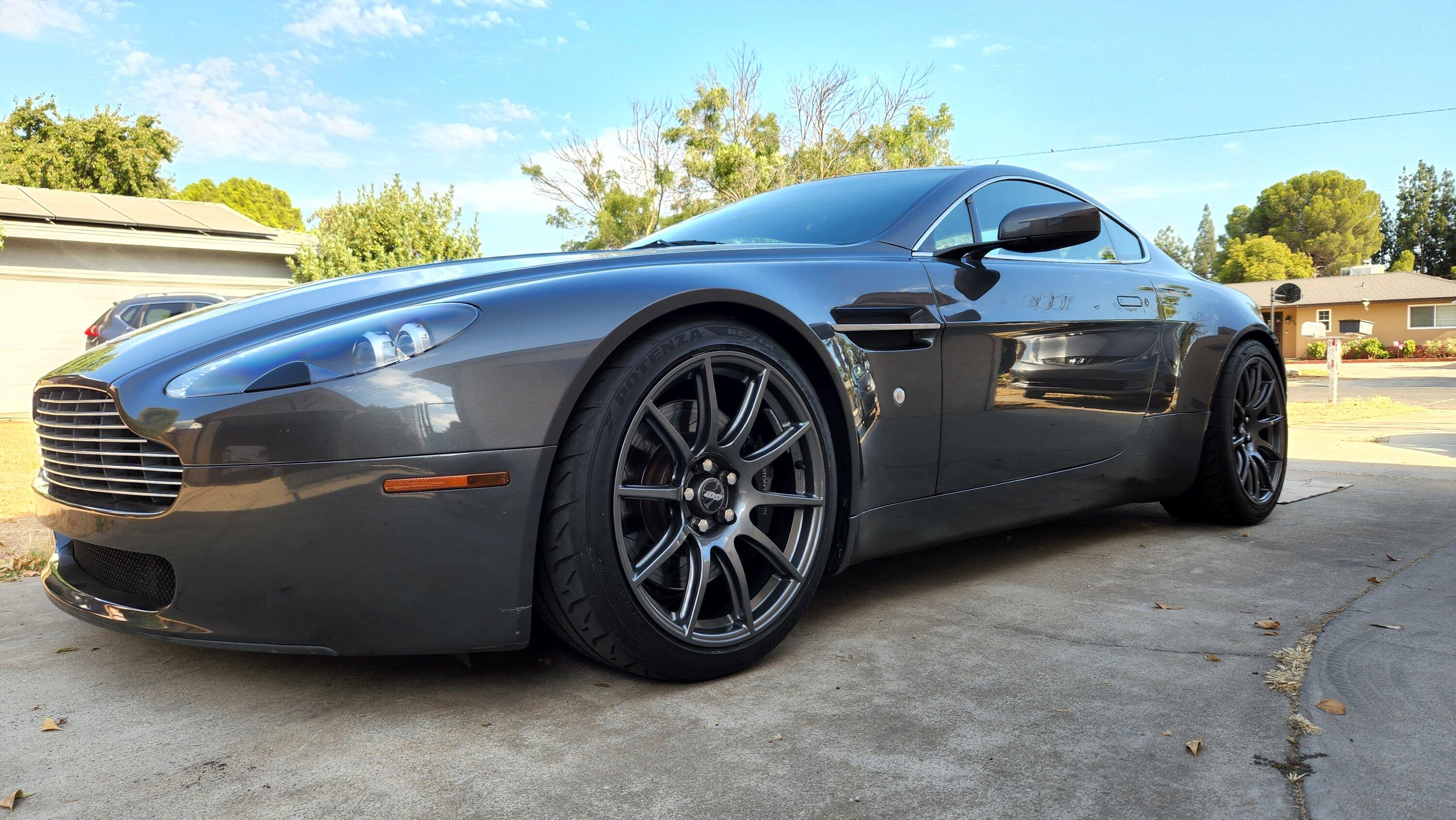

Lets see those 18" wheel setups!
Looking for advice on fitment and clearance.
I ordered a set of 18X10 +36 for a square setup.
I'm either planning on running 275/40R18 or 265/40R18, this is on stock suspension and stock height.
The manufacturer says I need to run a 5mm spacer up front in order for the spoke to clear the brake caliper. My concern is if I decide to run 275/40R18 square, will the 5mm spacer be enough, or do I need to get a 10mm spacer instead to clear the suspension components? Also, has anyone run 265/40R18 square on the track? Just want to know if there's any difference between running 265/40R18 and 275/40R18 on the track.
Thanks in advance

There are definitely more tire choices that I prefer in 275/35R18 and 265/40R18 compared to 275/40R18. I know I can definitely clear the front with a 5mm or 10mm spacer if I end up getting continental extreme contact sport or Michelin PS4S in 265/40R18 since I read up on the apex 18X10 ET30 technical notes and tire fitment thread.
I'm not a big fan of lowering the car since I will be putting suspension and aero parts down the line once I figure out my goals for the car. I'm satisfied with the stock suspension and stock height for now.

I know this was said elsewhere but will repeat. Local Supra track rat in our neck of the woods is all stock except consumables. And is the fastest Supra around our track ? ✌?
Coulda, shoulda, woulda saved me a ton of money looking back. This car is very capable with better rubber and pads, indeed! Knowing that would have given me extra money to try the holy grail $1000 CSG pads ? JK - I still wouldn’t pay that much for pads… ?
Edit: I will say I do really really like the SPL parts. Giving the car a more direct telepathic feel and the ability to change my camber (w/out plates up front).

I have Nakangs, $400 pads, and fluid. I did just buy camber plates for obvious reasons. I expect the car to be very fast. I'll know next week!
These cars do so well even stock
