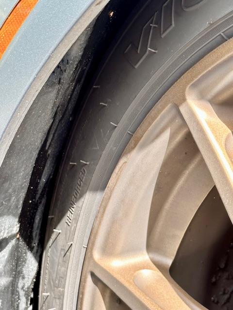

Stock suspension yes, but when I got an alignment I added as much camber as I could to benefit on track. Alignment doesn't really matter for fitment in stock suspension.
Since I’m driving on a 275-18 square setup for 6 months, I bought some adjustable endlinks. You’re right, less problematic in town. Did you get anything else for less stress on the OEM geometry being inherently lower?
And she’s tight on a full turn. Obviously trying not to full turn much and I haven’t had a problem with outer wear there yet… ;) If full turn on track, I’ve got bigger issues to worry about ?
Nope, nothing else in my suspension was modified for that at the time

I’ve got my stock height now, on Ohlins, so no rubbing up top where I was having problems. OEM suspension would have been fine too. I’m back to OEM height and on 275/35-18s. It’s fine for track and town. But just showing at full turn it’s tight. No problems as long as you’re aware. Each manufacture can vary, as far as fit.
