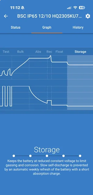

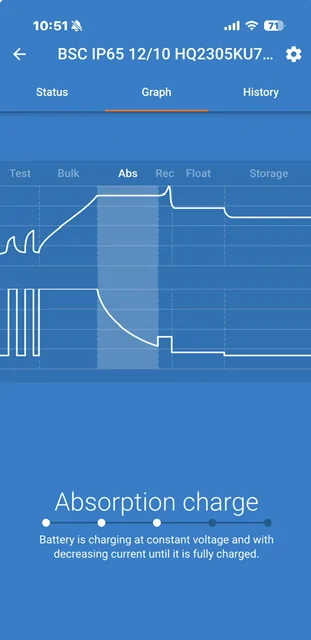

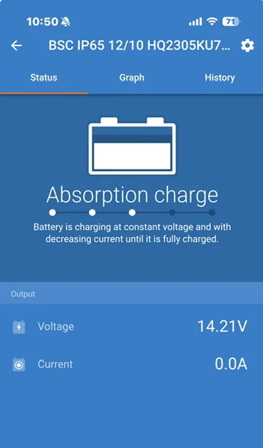

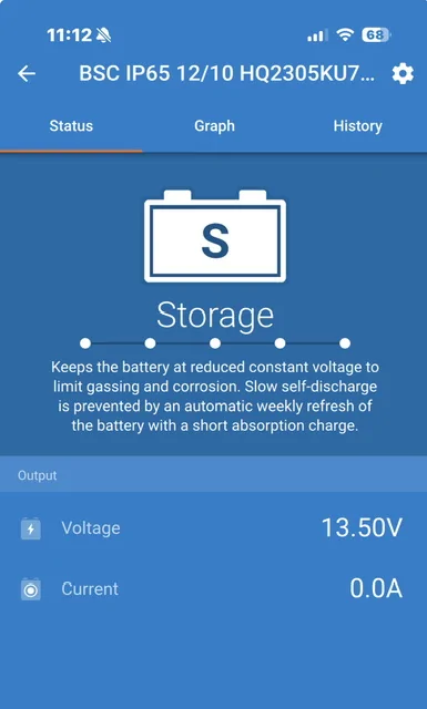

Going to install mine today. Correct me if I’m wrong, here’s what I found out from the Victron Blue Smart Charger. The app pics below:
The *ABS* LED on your Victron Blue Smart Charger indicates that the charger is in the *absorption stage* of the charging process. During this stage, the battery is approximately 80% charged (or over 95% for Li-ion batteries). The charger maintains a constant voltage while gradually reducing the current as the battery approaches full charge. Once the absorption stage is complete, the charger will move to the *float* stage, which means the battery is fully charged and ready for use.
Takes quite a while even though I just did this last week. So I don’t want to install it in the car until the *FLOAT* or *STORAGE* LED on the charger is illuminated. These indicators mean the battery is fully charged:
*FLOAT LED*: The battery is fully charged and maintained at a constant voltage.
*STORAGE LED*: The battery is kept at a slightly reduced voltage to prevent overcharging and extend its life during long-term storage. If either of these LEDs is on, the battery has completed its charge cycle and can be safely used in your car.
So after about 2 hours I made it to this installing state.

It looks like the voltage readings are steady, which is a good start, but to fully confirm that the battery is ready for installation, we recommend verifying that it’s holding a charge effectively. Here are a couple of quick steps:
  1. Check the Voltage: After disconnecting the charger, test the battery's voltage and note the reading.
  2. Observe for Stability: Leave the battery idle for a few hours and test again to ensure the voltage is stable. A consistent reading suggests the BMS has successfully woken up and the battery is holding charge.
Once we confirm these steps, you should be good to proceed with installation. Feel free to post your readings here, and we’ll be glad to help you analyze them!
