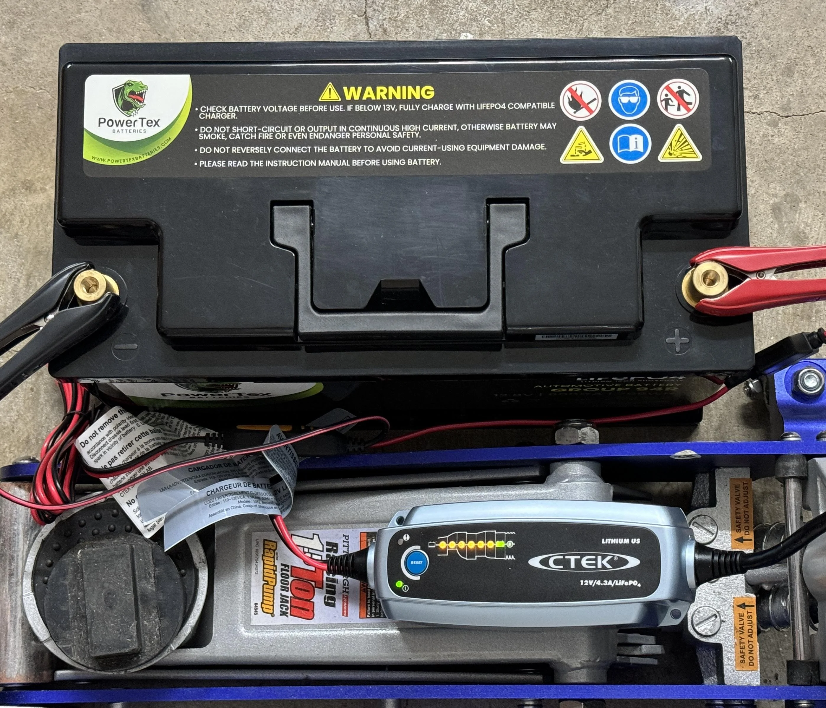

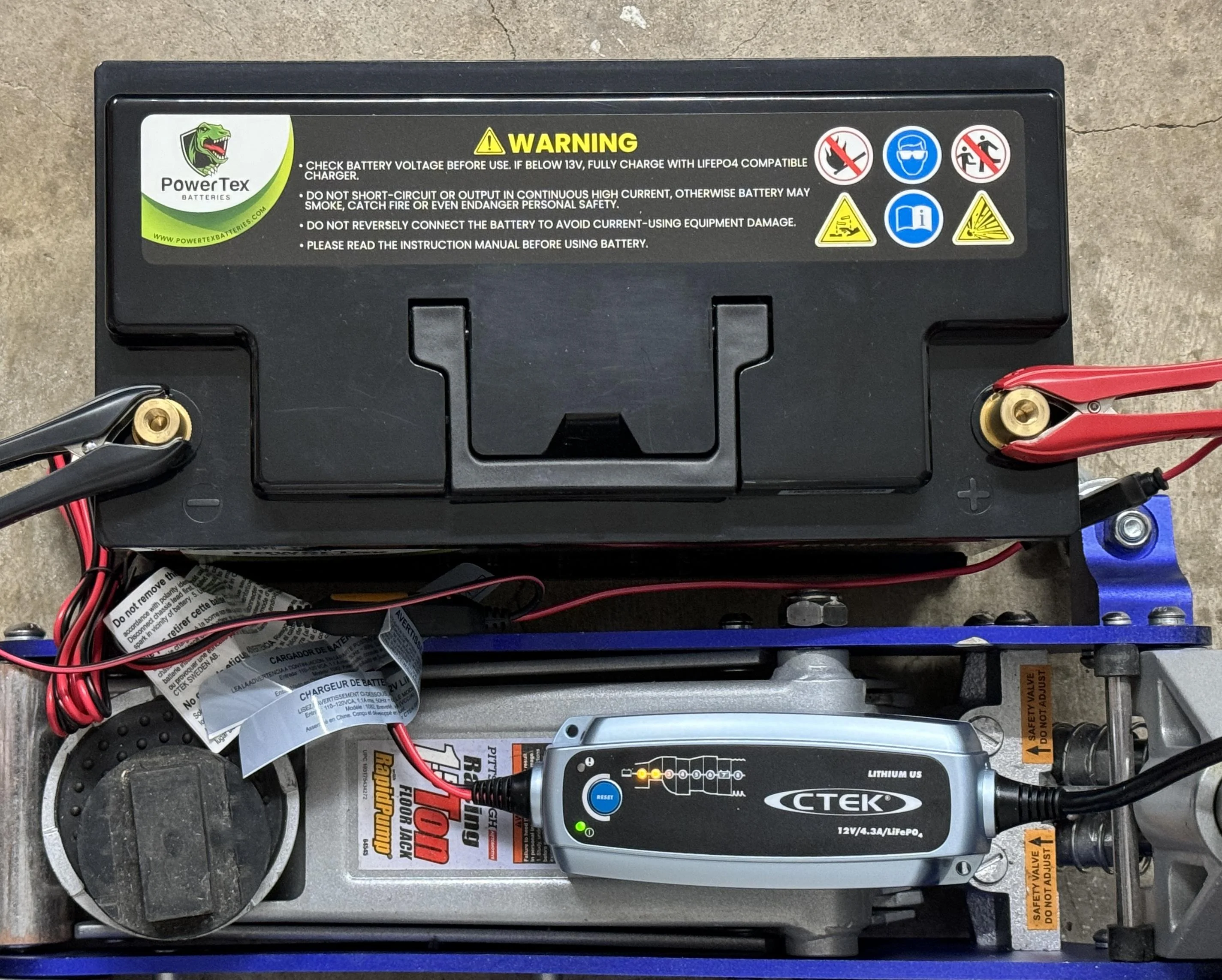

I did hook it up to the CTEK lithium specific charger which I purchased last week on Amazon and it did indicate only the first 2 LED lights meaning it had to go through some maintenance charging (1st photo). But after a few hours, it was fully charged (2nd photo).
I do know I'll have to code it in Bimmercode's Expert Mode (Front Electronic Module -> Battery Class, etc...) then register it in Bimmerlink before passing any judgement on it.
