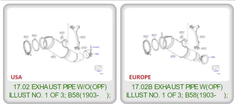

should point out that none of the downpipes listed fit EU cars, EU cars with GPF have a vband connection on the bottom instead of a slip on fitting.
