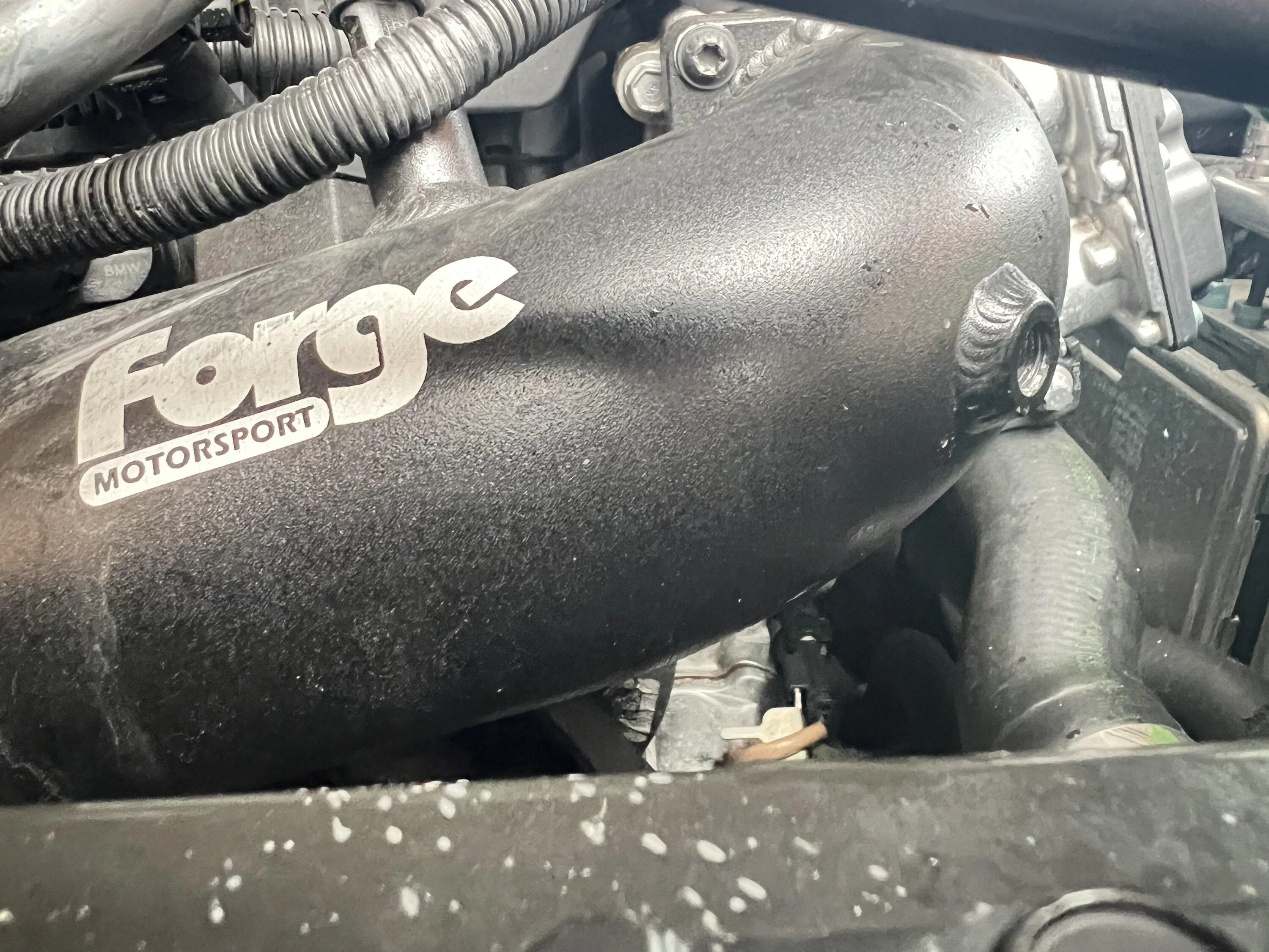

So, boost leaks you say…
Can’t believe it took so long to spot this because I’d never have thought about it but turns out the 1/8th NPT bungs in the chargepipe have fallen out! They were there when I installed it and for the previous dyno session but at some point around July/August they’ve gone missing!
Got another couple on order.
Looks like you forgot to connect that 200 shot. ?
