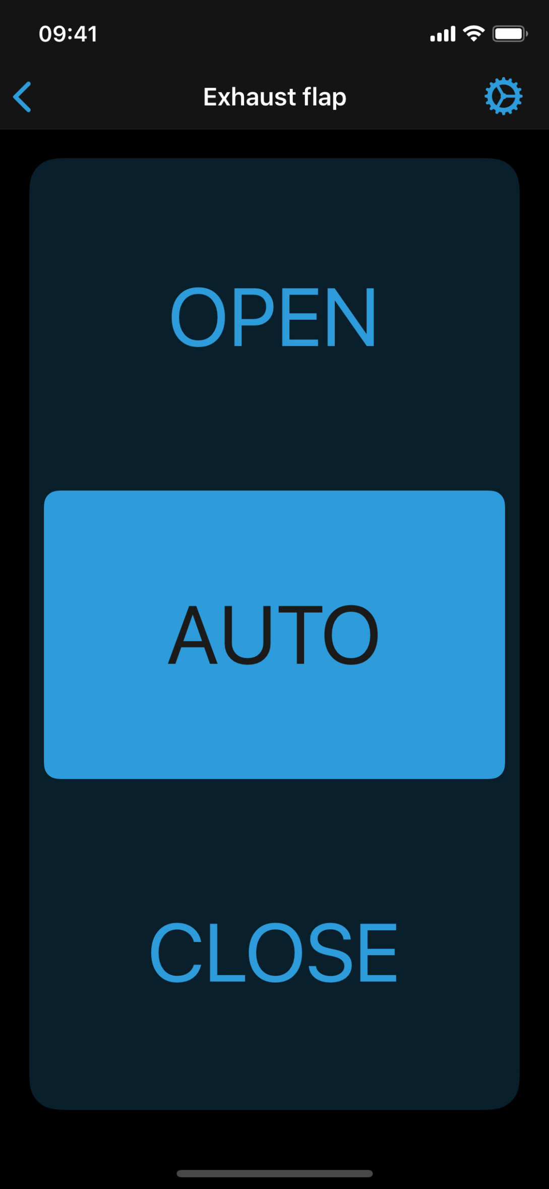

Wanted to check back in. My Supra remains very tame. No pops or gurgles on overruns. The dealer doesn't see anything wrong. It's like sport mode doesn't do much. I mean it does change the shifting but sometimes I don't even hear the valve open.
I think it was mentioned that MY21 still works with Bimmercode/link..
Again, Toggle manual valve open via BimmerLink and toggle back to auto.. not Code, Link.
Try if this works. I don't know what other app can open/close valve on command.
Also, then check if flap even opens, closes with the app. Did dealer confirm open/close??
https://www.bimmerlink.app/

I did use BimmerLink. So when I start the Supra cold, the valve is not open. It's pretty much always closed on cold start. It's about 50/50 on a warm start.
I also used BimmerCode and set the car to start in Sport Mode hoping that would help but it didn't.

Sorry, yes the app will open and close them without issue. Just not opening when in sport mode.

Just to validate this, the valve should open when Sport Mode is active? Regardless of warm or cold start?

i can confirm the same issue (but only when the car is warmed up)
cold engine i still get exhaust burbles
