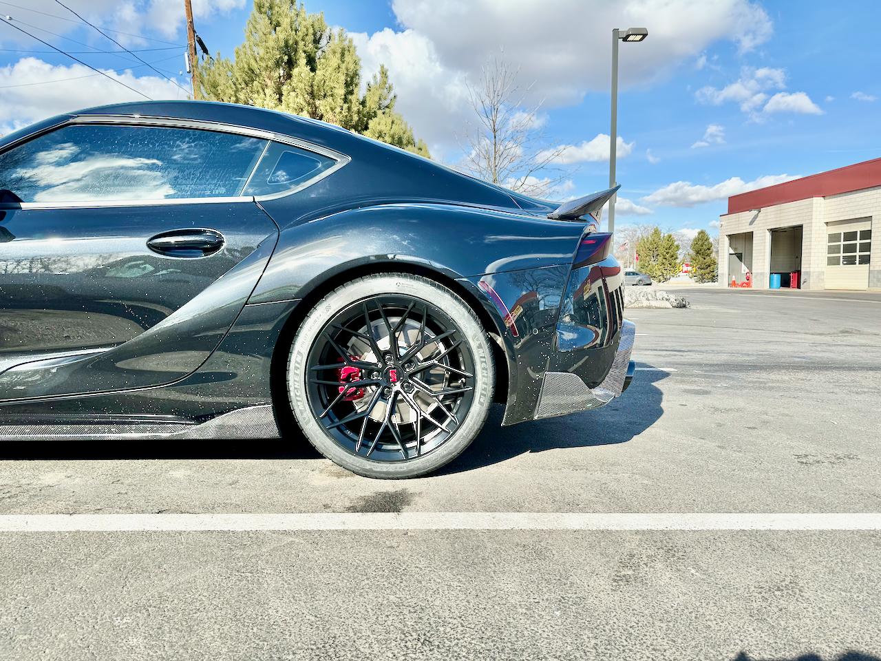

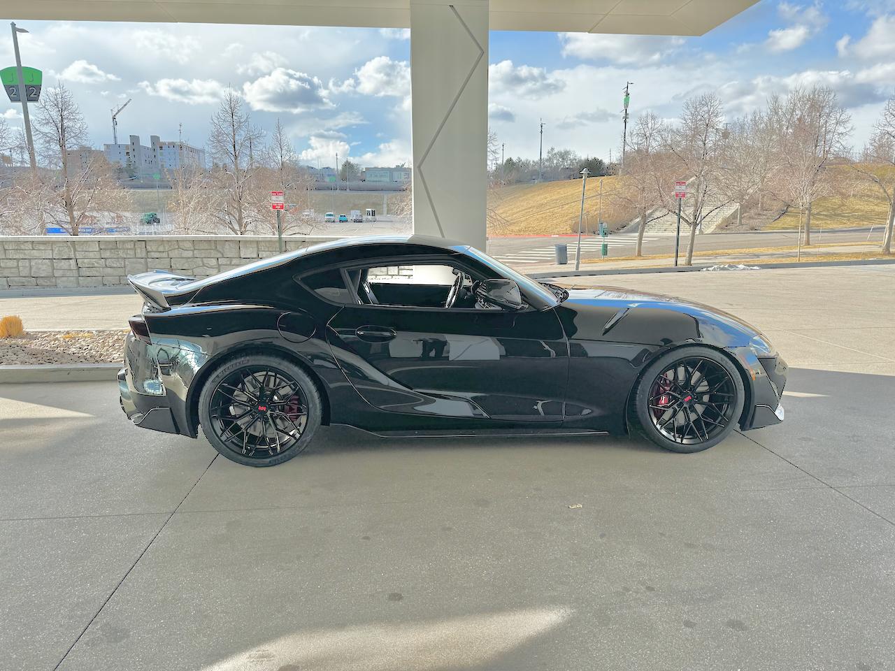

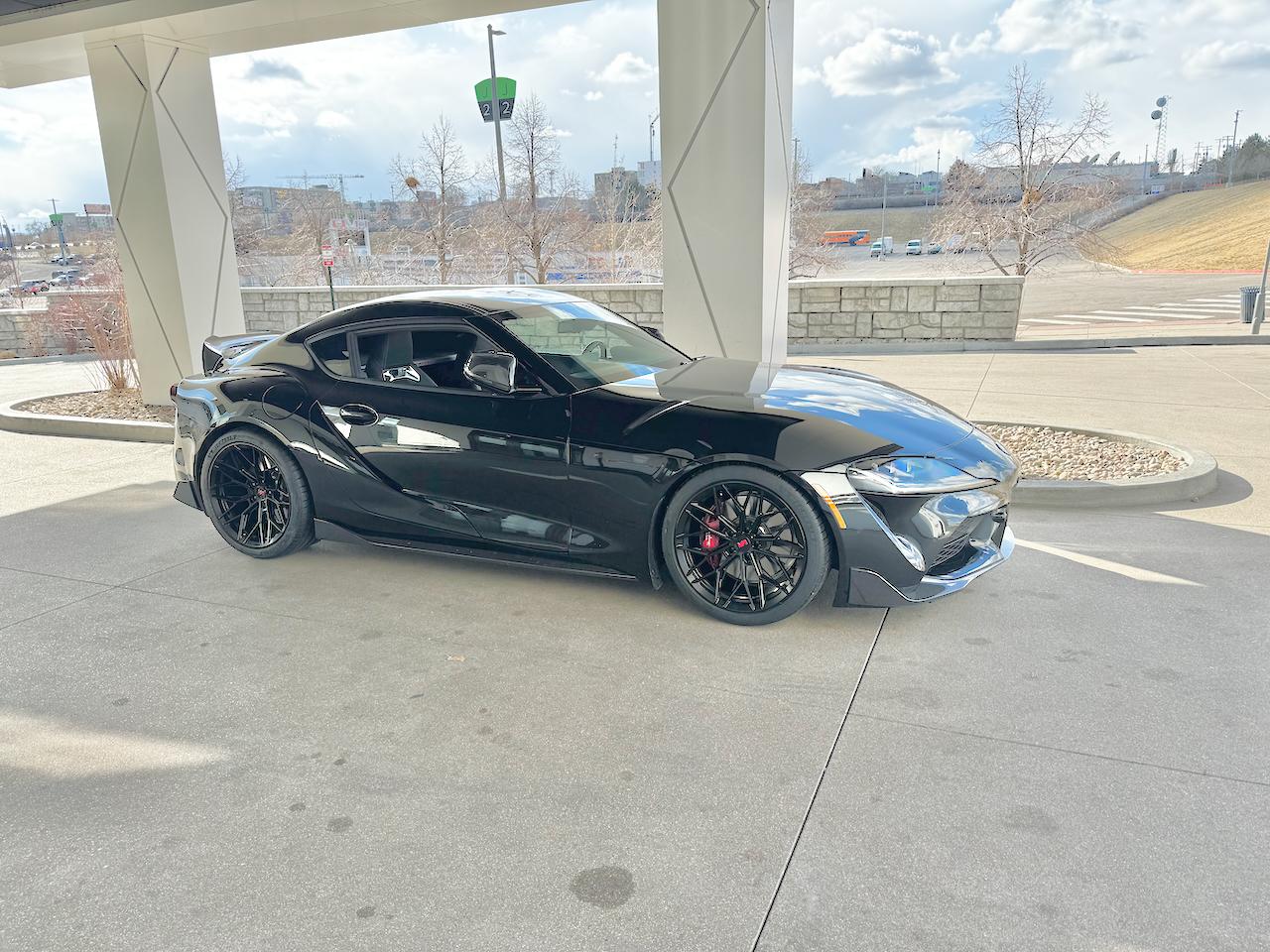

I had H&R lowering springs installed on my Supra today and while I am super stoked on the ride height at the front, I am not so stoked on the rear ride height. I know the springs are supposed to settle over time but I feel like the rears have a looooooong way to go if so.
The front seems dialed in right where I want them with a 1 finger gap between the top of the tire and bottom of the fender, but the rear still seems too high, almost stock ride height-ish. Like I can barely notice a change at the rear. There is a 2 finger gap at the rears.
Those of you that have H&R lowering springs, did you encounter this and are you happy with your ride height?All the pics of Supra's I've seen with H&R's looked really good! I feel like I did not get the same outcome.
Those of you that have lowering springs from other brands...did you feel like your rear ride height was higher than the fronts at first?
If these don't settle enough, I am going to swap them out for either HKS, Eibachs, or Swifts.
I'm just a little disappointed because I did a ton of research on here, youtube and the internet in general trying to find reasonably priced springs that I liked and everyone with H&R's seemed really happy and the pictures always looked good!

I ran H&R before coilovers and it should be sitting lower then that at the rear did you put them in the right way?
Double check, also check that the top hat of the rears is correctly seated.

A local shop installed them! I'll have them double check when I bring the car back to them next week.

Are the shipping spacers removed from the struts? This is not right. The tire should basically be at the lower lip of the quarter panel.
That is what I'm thinking. I've seen people post pics with fresh, non settled H&R springs and their ride height in the rear looks way better than this.
Yeah, I had the dealership I bought the car from double check and verify that all shipping spacers were removed.

yeah should fit better then that. I know having a 30 series tire makes it a little bit bigger of a gap then a 35 series but that still looks too big even if it is a 30 series tire. H&R with a 305/35 here and it fills almost perfectly.
Thatā€™s exactly how I want mine sitting although with a 30 like you said. Thanks, Iā€™ll have them take another look at it.

i have friends that are H&R and some have the same issues. im on Eibach and i think they are perfect
Daaaaaaamn those look good!
I'm going to need to know what wheel and tire setup this is!?
