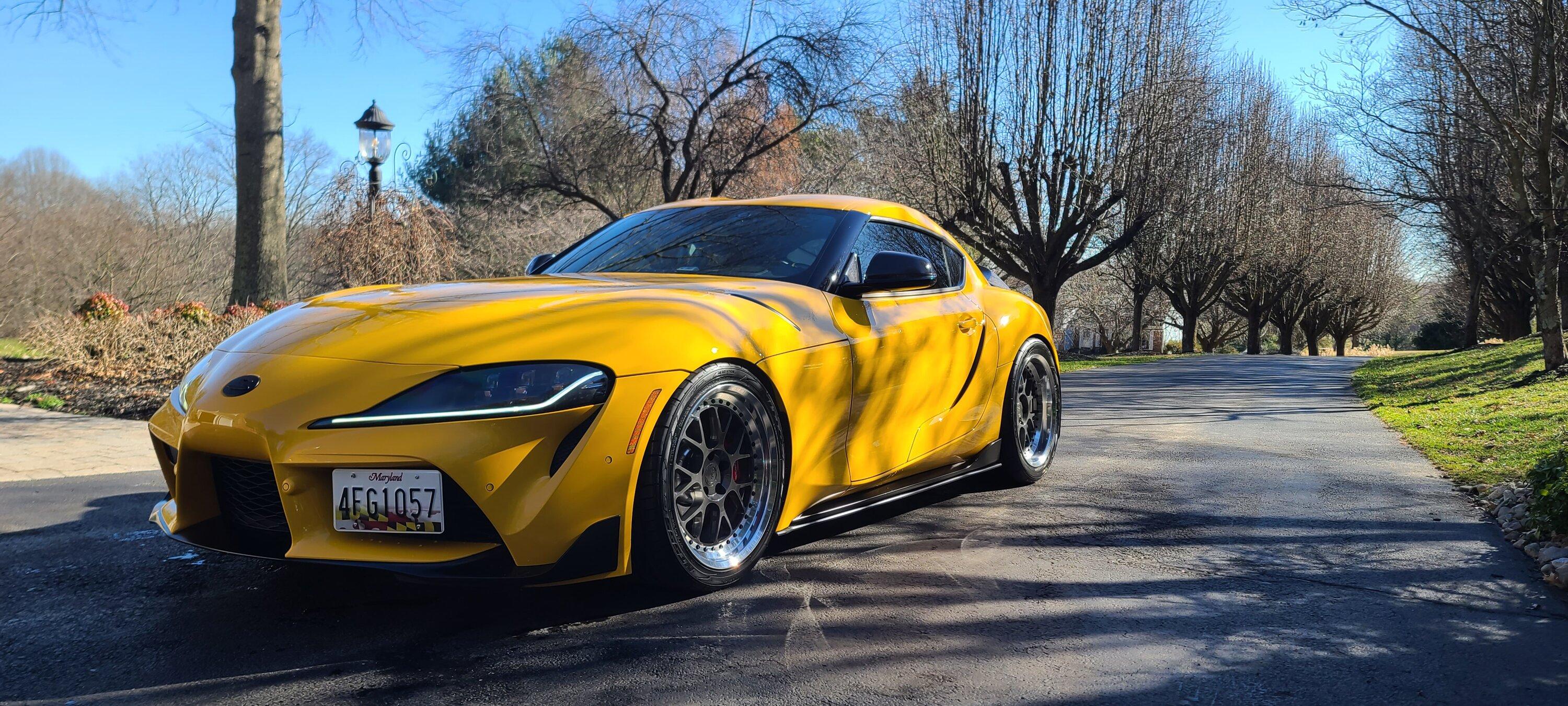

Hey Tim, here’s a side by side. There’s a tiny drop but I definitely don’t think it’s 0.7” like it’s supposed to be. Probably same story with the H&Rs as eibachs kit not lowering as much with MT cars.
I mean, it looks awesome but I would want it a tad lower. Like I said, I am torn between Whiteline, RSR down, or even the Eibach Euro kit. H&R is out for me!

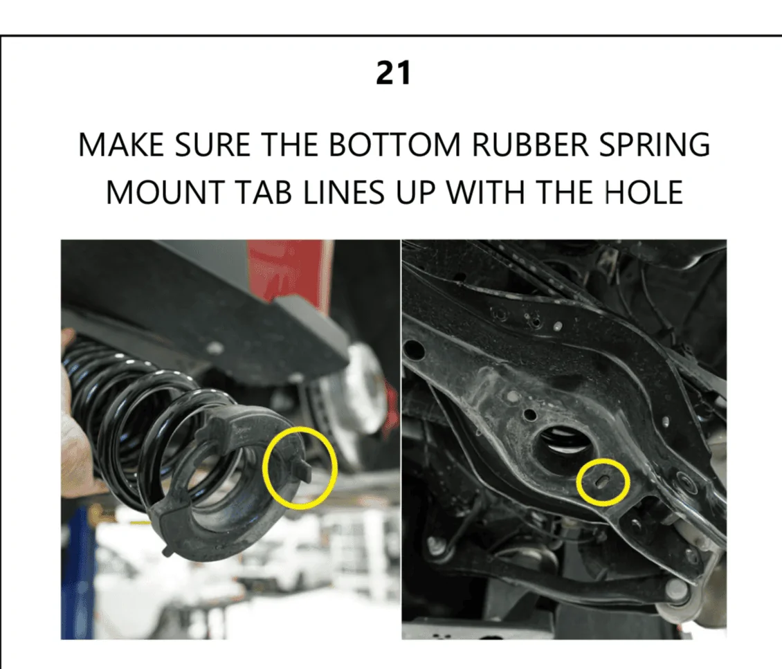

There’s a rubber piece on the bottom of the rear springs. Don’t know what it’s called but it slots into the control arm very specifically and only one way. There’s actually an alignment hole it slides into. I would make sure that is seated properly.

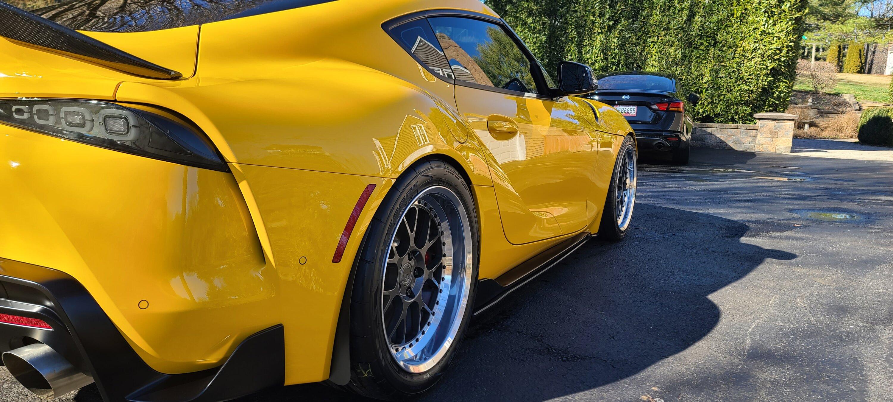

Yours looks off.
H&R springs. Rear: 19×11. 305/35, Front: 19x9.5 265/35.
Just bought a set of KW DDC p&p from METAL on here. They're going on next week, triple7 hood vent and Adro kit.
Got those stormy taillights too
You have an auto though, right?
