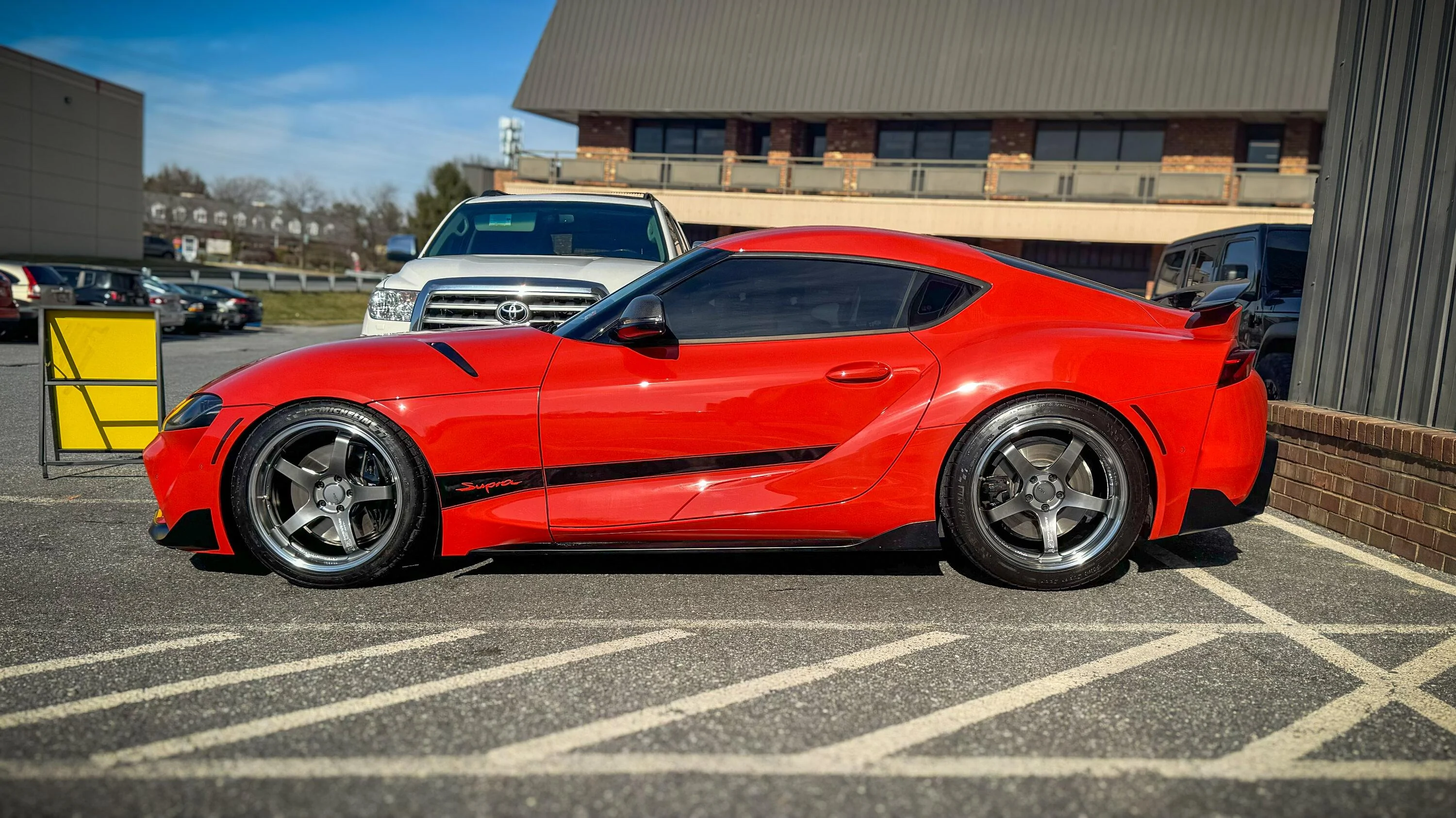

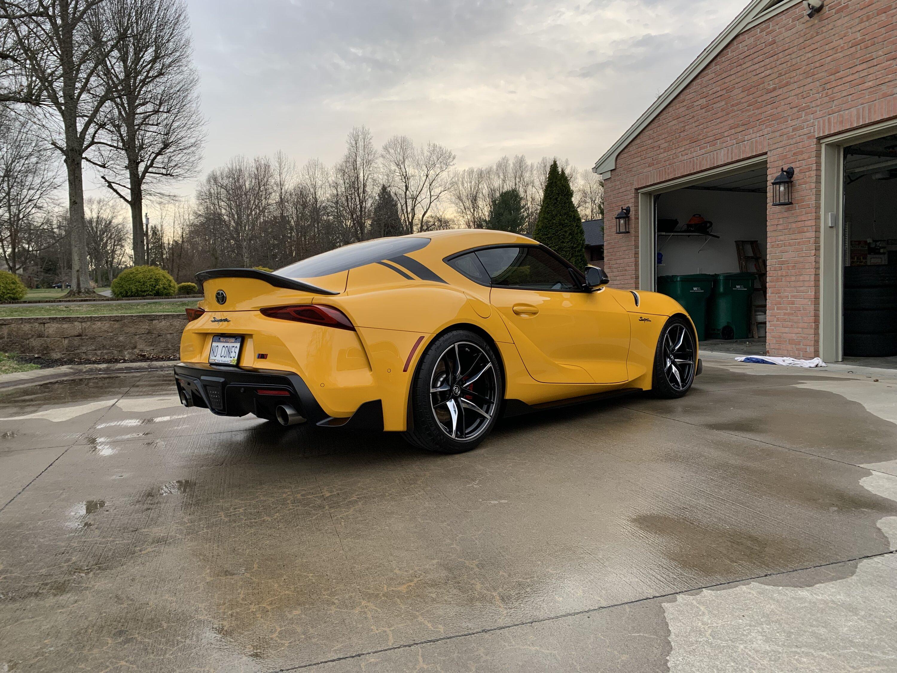

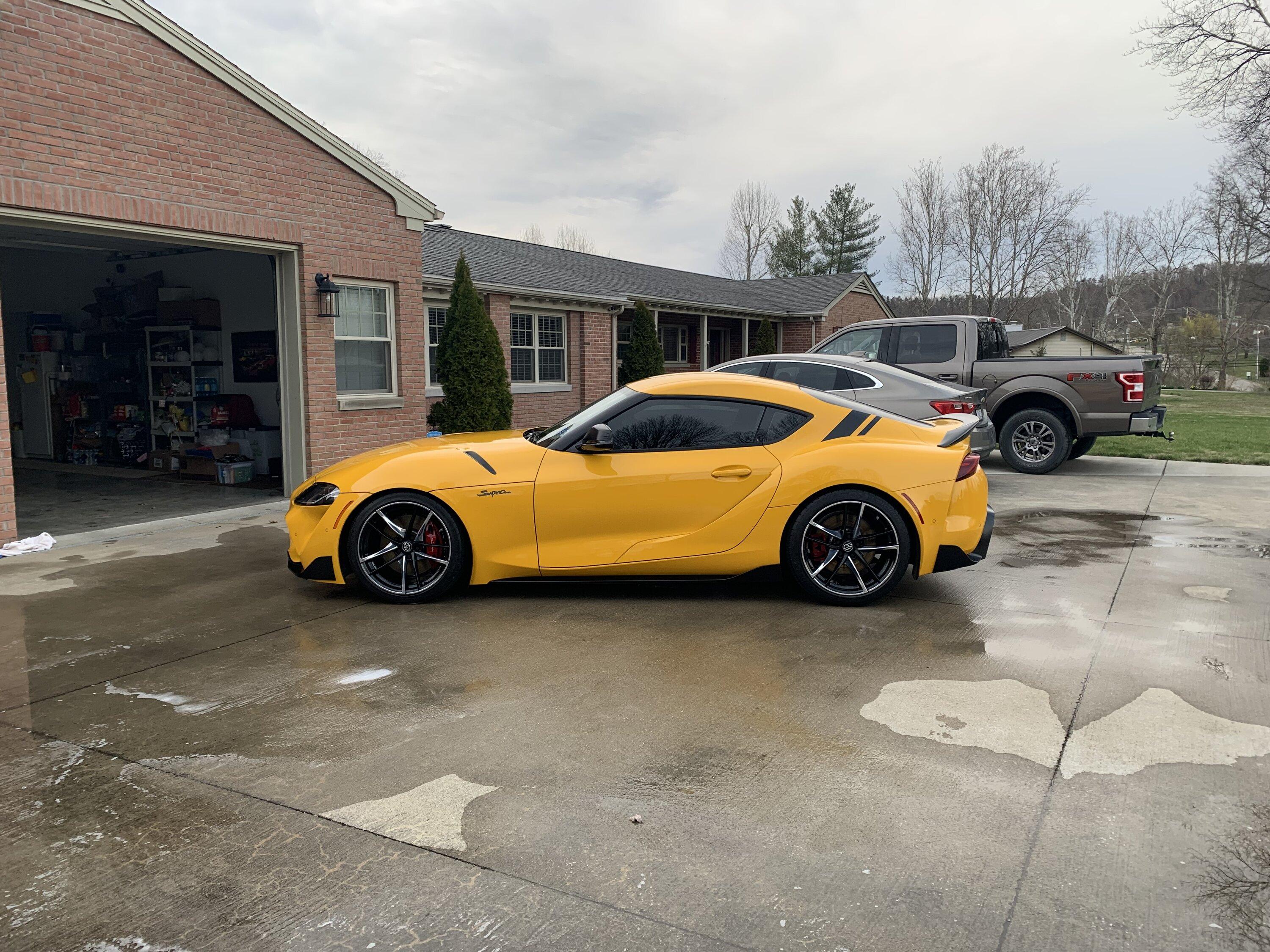

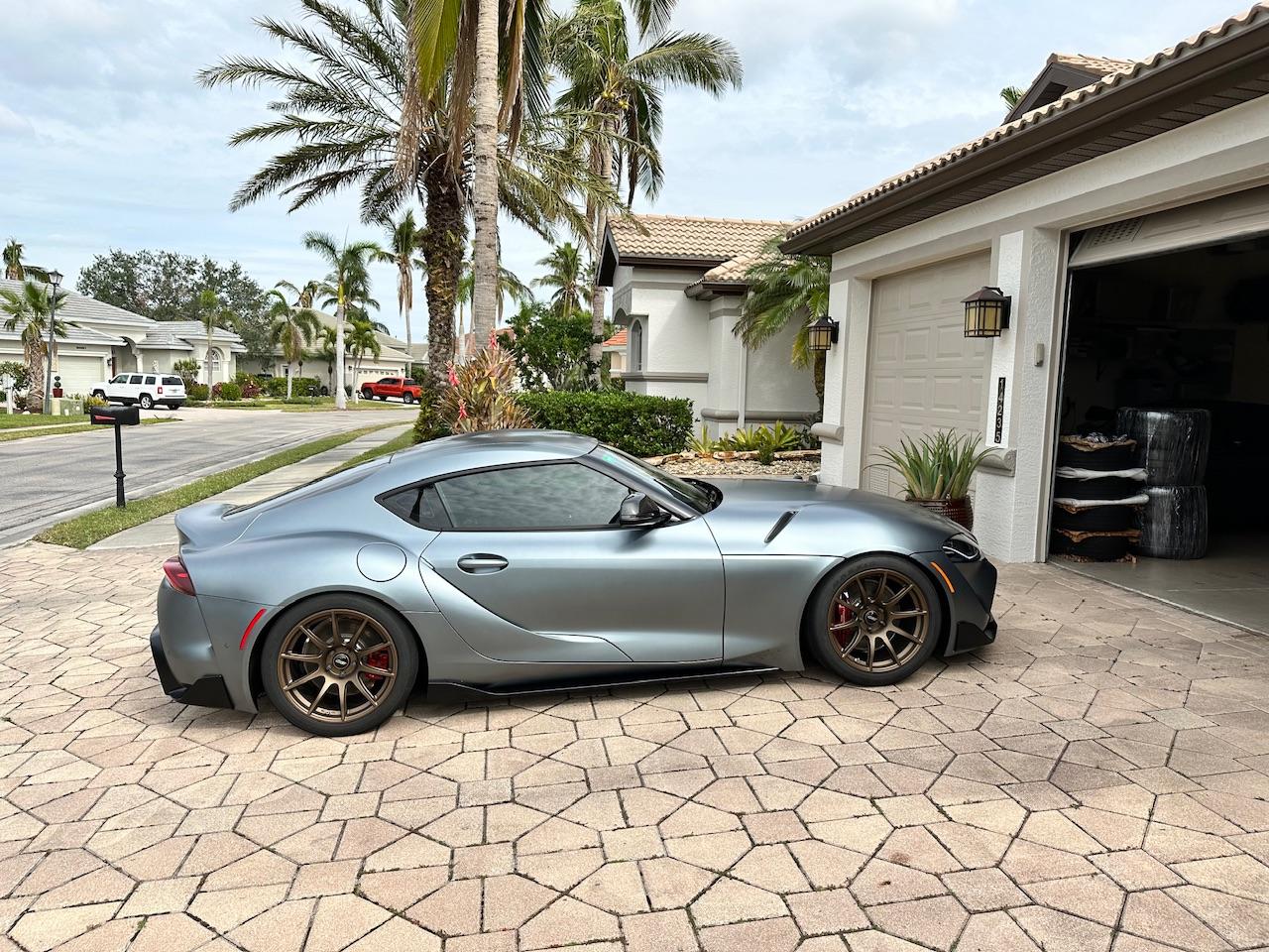

I’m going to throw another vote in for whiteline springs. All of the Supra guys I know in Tampa and myself all run them. Close to stock ride quality so it won’t punch you in the kidneys all day and the gap is just perfect with no rubbing.
stock launch edition rims
13mm front spacer
10mm rear spacer
275/305 combo
13mm front spacer
10mm rear spacer
275/305 combo
Thank you sir, may have sealed the deal for me on Whiteline! Looks fantastic.

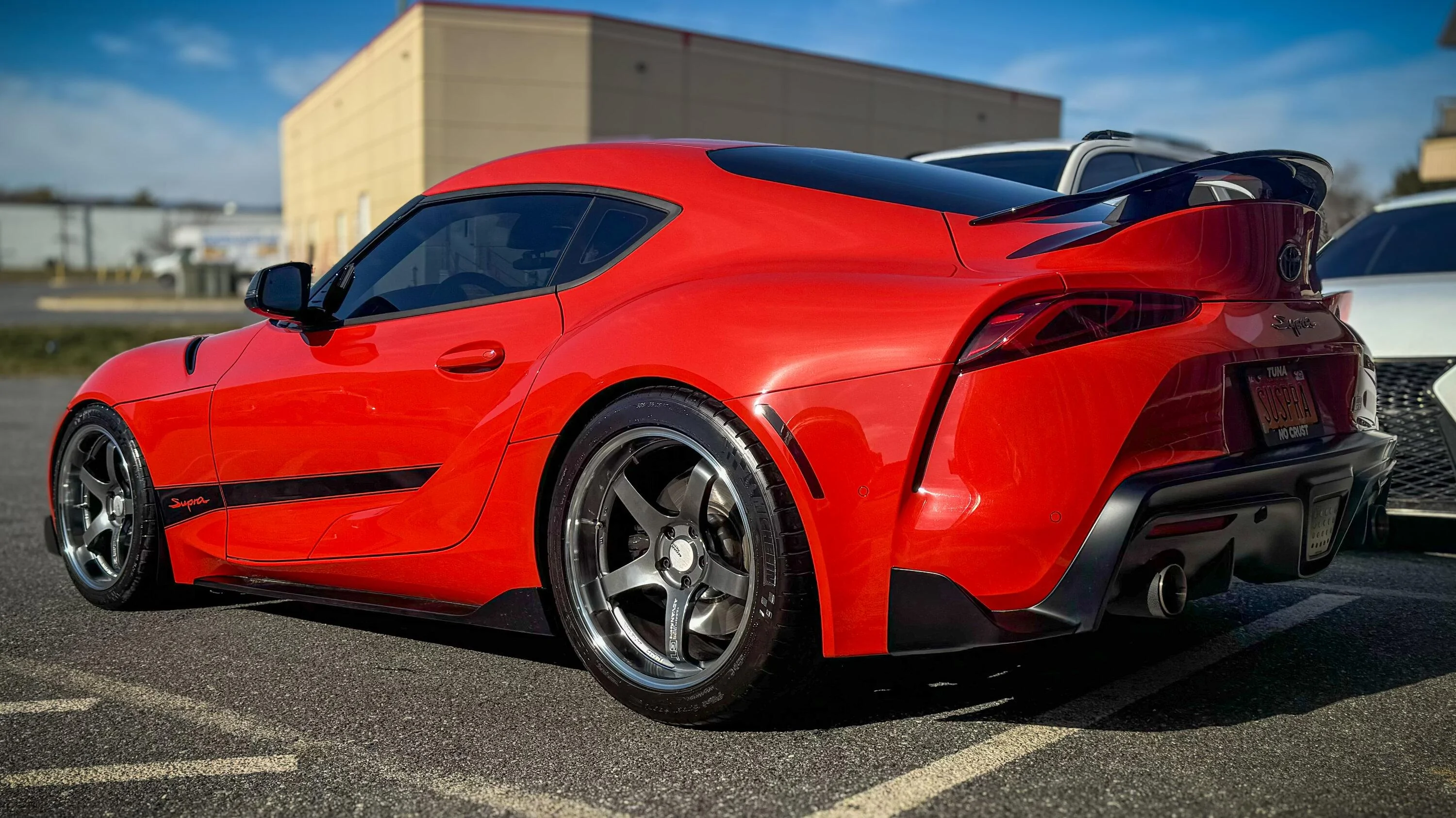

One last vote for MSS Height Adjustable. They can adjust from stock height to 35mm from stock height, front and back. Not the cheapest, but worth every dollar. Much more sportier spring rates than most that make it feel like a proper sports car, but also a slightly softer than stock ride in comfort mode due to the triple rate rear springs. They also don’t make any weird noises, no rubbing, no drama.
Since I like suspension travel, and not scraping on everything, I’ve only lowered the rear a modest 15mm, and the front only 20mm. So it could still be lowered quite a bit more if desired. For me, not desired as I am shooting for best of all worlds, daily driver, drag strip and auto-X. A little rake does this car well.
What size wheels/tires are you running?

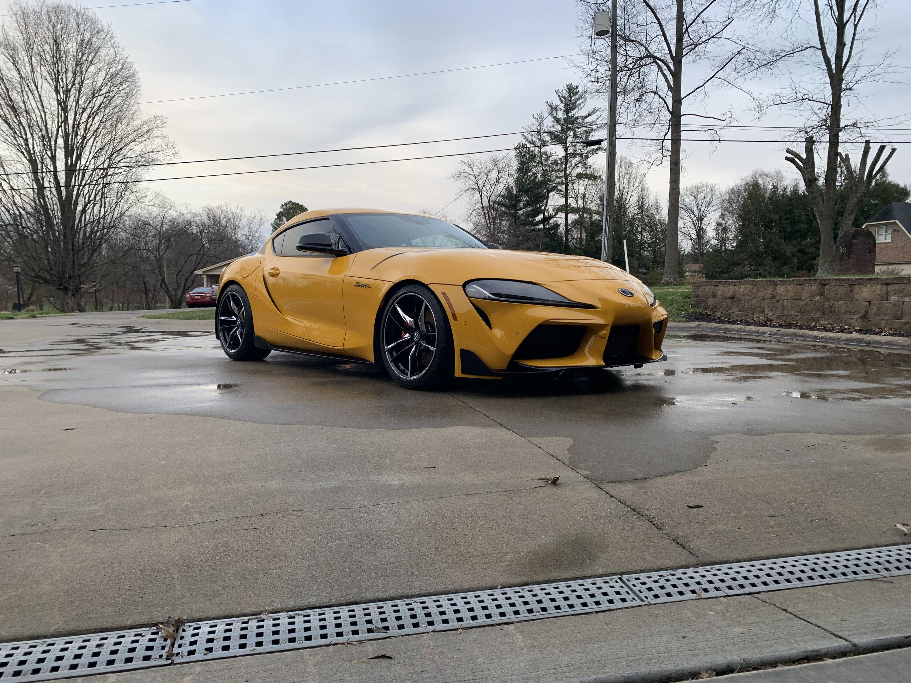

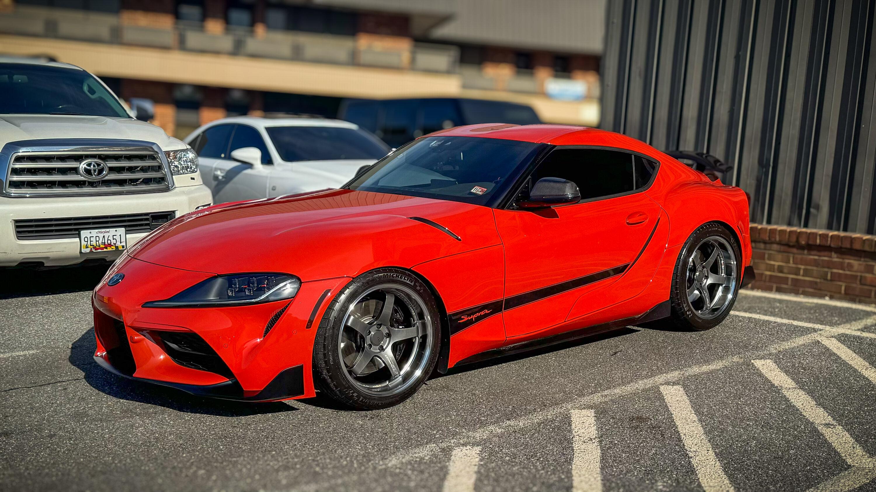

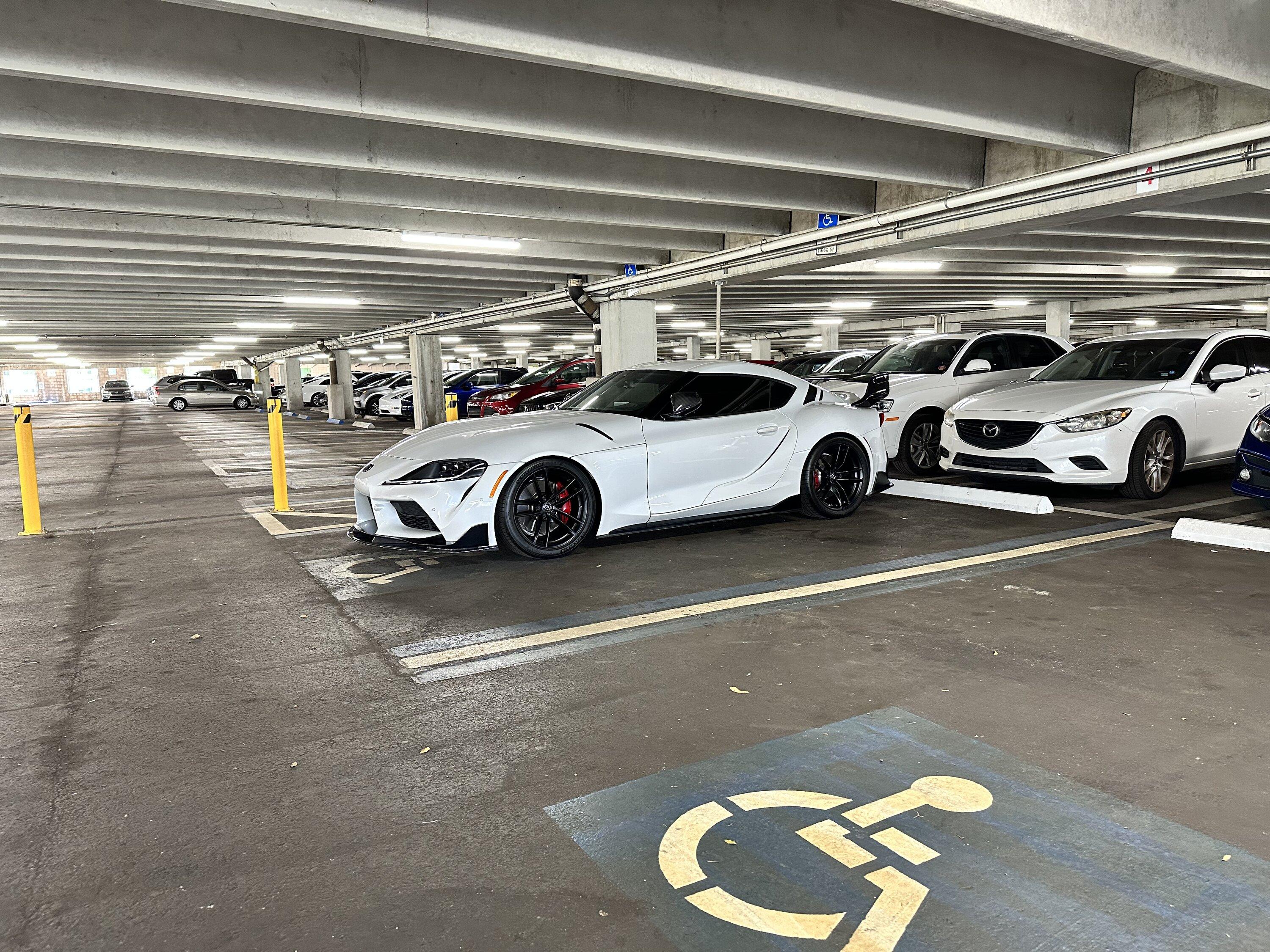

I did not adjust the HKS - I just installed it straight out of the box
HKS adjustable springs + camber plates on stock wheels, stock tire size
HKS adjustable springs + camber plates on 18x10 wheels, 275/40/18 square setup, 5mm spacers on the front

Did you even bother to check that they were adjusted to the same points?
