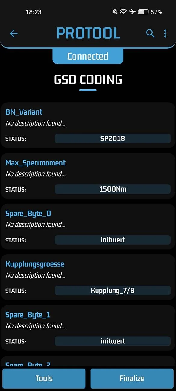

The values I have posted are from a 6MT. It would be interesting to see the values for an 8AT.
I would be quite happy if I could get the diff in my car to behave like an 8AT.

What are the values available when you go into “Max_Sperrmoment” ?

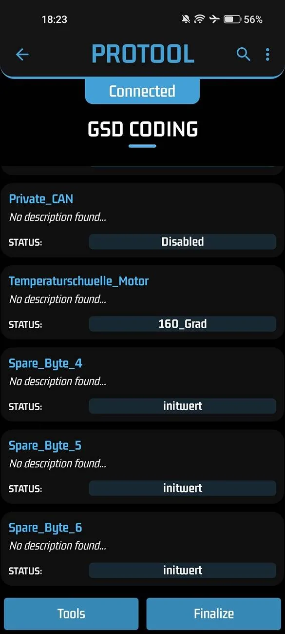

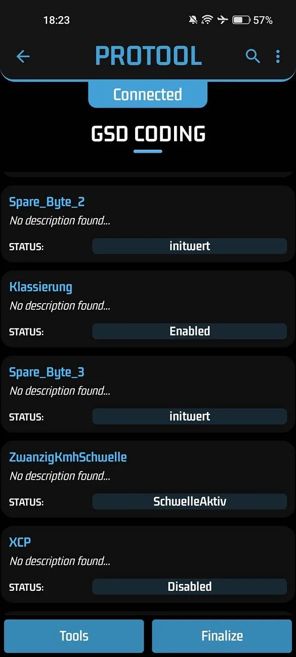

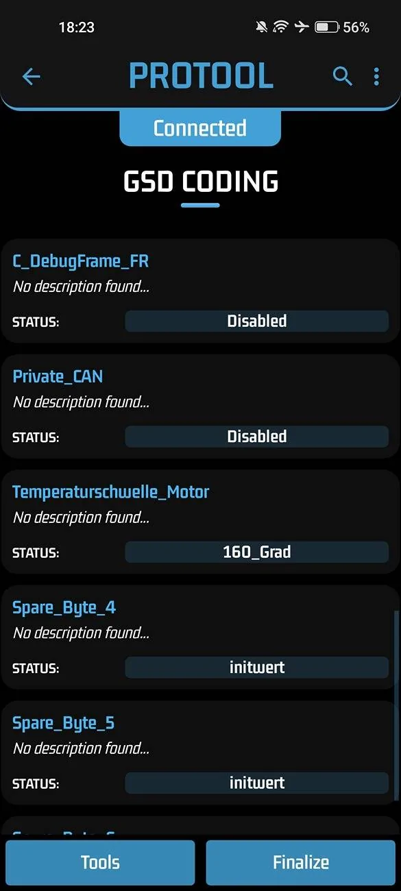

Thanks for sharing the information. Not sure what I am looking for or where to look for it. :)
I asked Super Grok to analyze and interpret your 4 photos.
Table: Parameters from PROTOOL GSD CODING (Based on Provided Images)
ImageParameterStatus/ValuePotential Relevance to Locking Engagement
1ZuwanzigKmHSchuelleSchuelleAktivLikely a 20 km/h threshold, possibly affecting locking activation
1KlassierungEnabledUnclear, may relate to system configuration
1XCPDisabledLikely unrelated (diagnostic protocol)
2Private_CANDisabledUnlikely related (communication bus)
2Temperaturschwelle_Motor160_GradMotor temperature threshold, not directly relevant
3C_DebugFrame_FRDisabledLikely diagnostic, not relevant
4Max_Sperrmoment1500NmControls locking force, not timing
4KupplungsgroesseKupplung_7/8Clutch size, possibly fixed but relevant to capacity
Seems to me the key things to adjust
ZuwanzigKmHSchuelle (set lower to have the LSD engage earlier - Grok thinks it doesn't engage until going faster than 20 km/h - this would help with J turns, donuts, gymkhana, auto cross, etc )
Max_Sperrmoment (set higher to have the LSD engage with more clamping force, would help with all of the above and more)
Of course just reaching out to the dev team at protool for guidance is ultimately the best solution here. But if you are willing to play around with it I'd start with the two settings above.

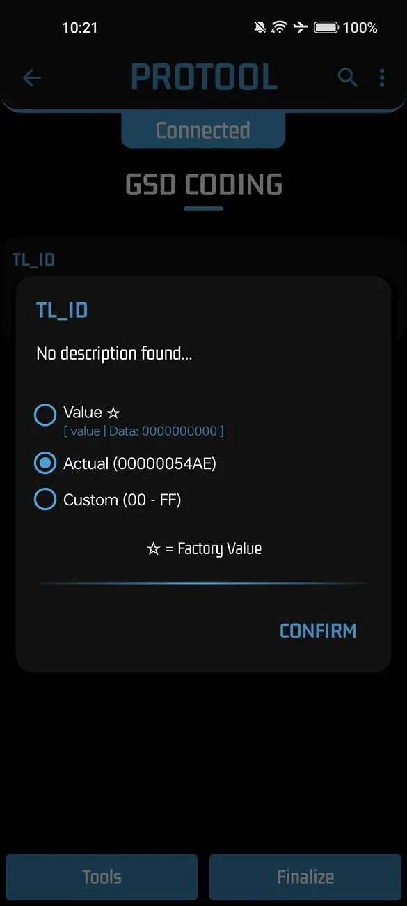

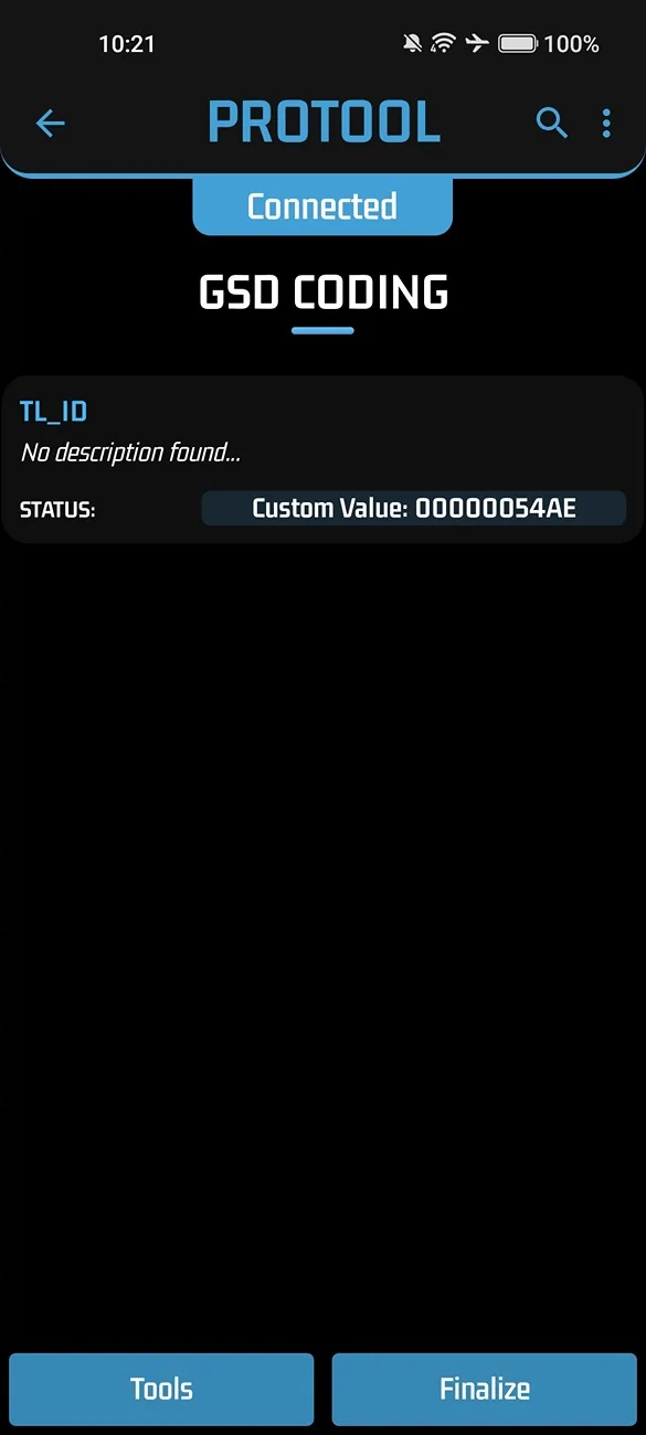

I have this value in TL_ID, which is not the factory value as per protool. . Any idea what this might be about. Thanks
This is what Grok says:
  • TL_ID Meaning: "TL_ID" likely stands for "Teilnummer ID" (German for "Part Number ID"), a common term in BMW and Toyota Supra ECUs (given the Supra’s shared platform with the BMW Z4). It identifies a specific component, such as the differential hardware, firmware, or software configuration.
  • Custom Value: 0000054AE: This hexadecimal value (54AE) is a unique identifier, possibly tied to the differential’s part number or a software version. Such IDs are used in automotive systems to ensure compatibility between hardware and software or for diagnostic tracking.
  • Compatibility with Coding Profiles: If you’re applying a coding profile (e.g., a GTS or CS profile from BMW models) to adjust differential behavior, the "TL_ID" ensures the profile matches your hardware. A mismatch could cause errors or prevent the profile from being applied.
  • Diagnostic Use: When working with a tuner or community (e.g., SupraMKV), providing the "TL_ID" value can help confirm the differential’s configuration, ensuring any coding changes are appropriate.
