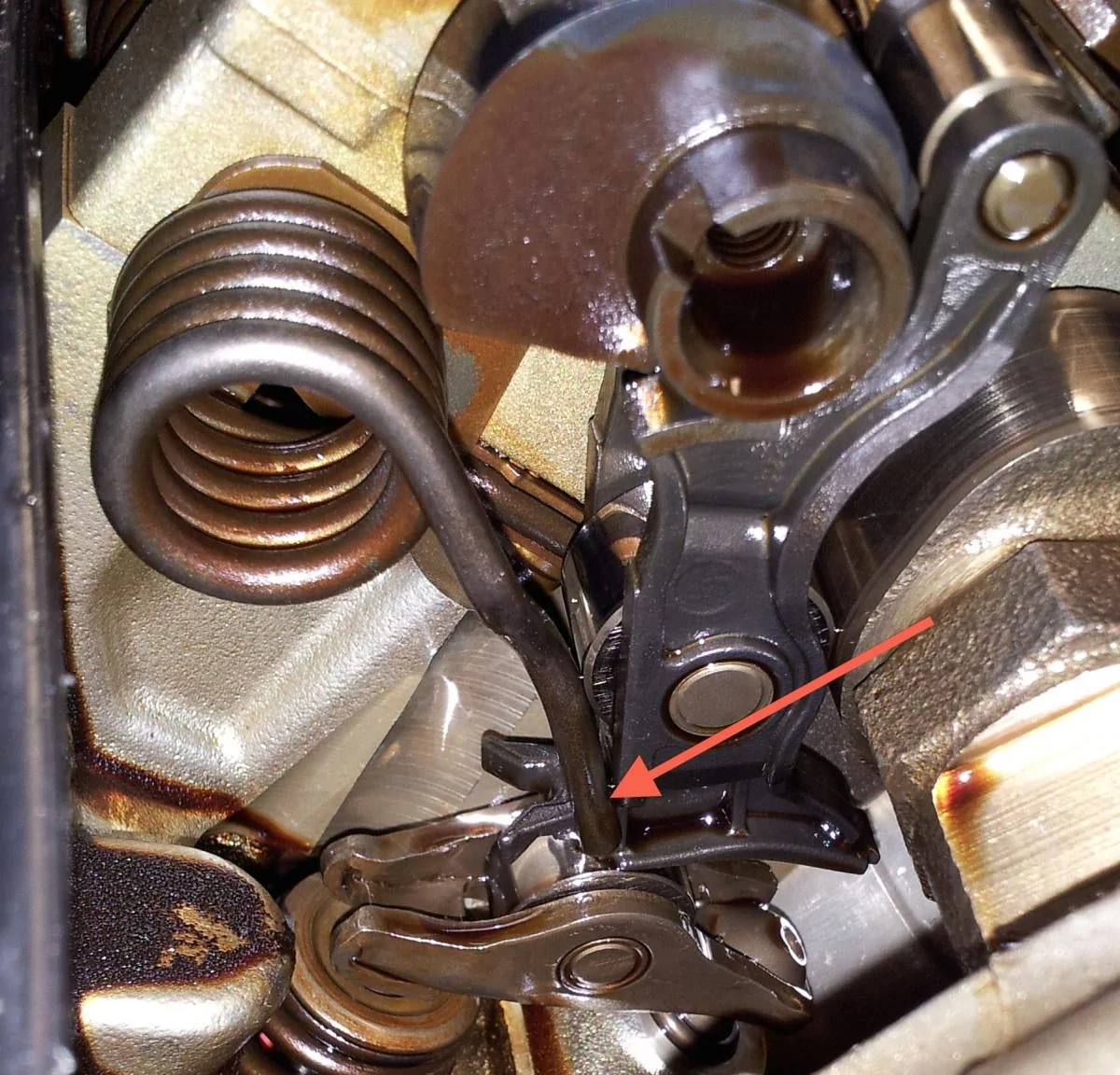

As great as the BMW valvetronic system is, the aftermarket companies still haven't caught up. That's why aftermarket cams on this engine typically only get you a half mm more Maxlift.
The intermediate lever is the limiting factor, and as far as I know, nobody makes a replacement. If you stick on a cam with too much lift, you essentially just run off the tip of the intermediate lever. You need to upgrade both the main cam and intermediate lever (a.k.a. SwingCam) to truly get higher lift. Then the torsional spring (which also has no aftermarket replacement).
Interesting! Thanks for the explanation!
