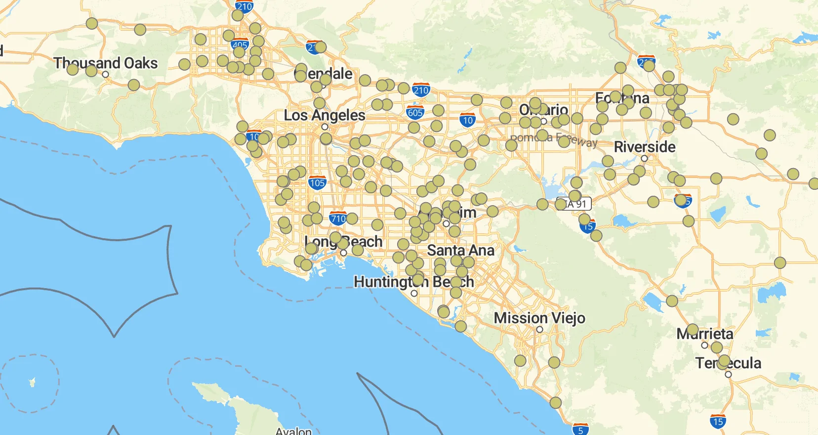

Or.. just.. buy fuel by the barrel, which is incredibly easy.
There are a good amount of E85 stations in California though so ordering isn't necessary. Especially in the Los Angeles area where the OP is.
It doesn't matter though because they stated they aren't interested in alternative fueling.
