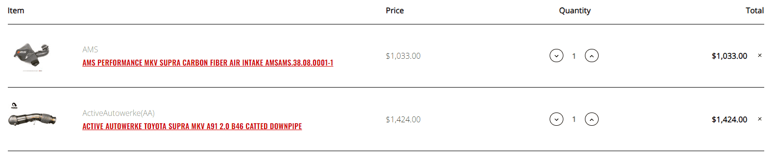

okay I'm back
these are going to be my first mods. Doing this before any type of tune. Any experts out there care to weigh in if I'm missing a little something else that connects to these that could help in the long run?
8,717
17,079
okay I'm back
Spending $1,000 on an intake that doesn't do anything. But if you don't care, it's your car. :)

Yeah man, I would pop an AFE intake and JB4 for that amount of money instead of spending 1 grand on an intake.
okay okay it's overkill. I'll look at other options!
intakes are a waste of money if you are going for performance. Also there's much more cost effective downpipes.
I would personally do a cheap catless downpipe and a jb4. It's the best bang for buck upgrade you can do.

https://studiorsr.com/products/afe-...29257&pr_ref_pid=7701581496489&pr_seq=uniform
The prof 5R filter (blue color) provides more CFM than the dry filter. Make sure its for 2.0L the dyno sheet on this one says 2.0 but I don't see it in the description anywhere else. You can also get it directly from AFE. There website is giving issues right now.
are there any issues with these open type filters compared to the enclosed ones? Does one have more durability than the other?
stormgreysupra
Sep 26, 2020
1,638
1,917
Budapest, Hungary
www.oemplusdesigns.com
GR Supra A90 Edition
Open filters most of the time just hurt performance due to heatsoak. The best you can do is a replacement panel filter.
