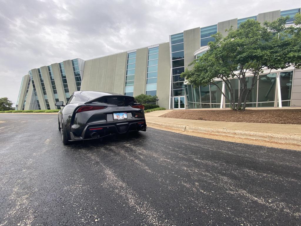

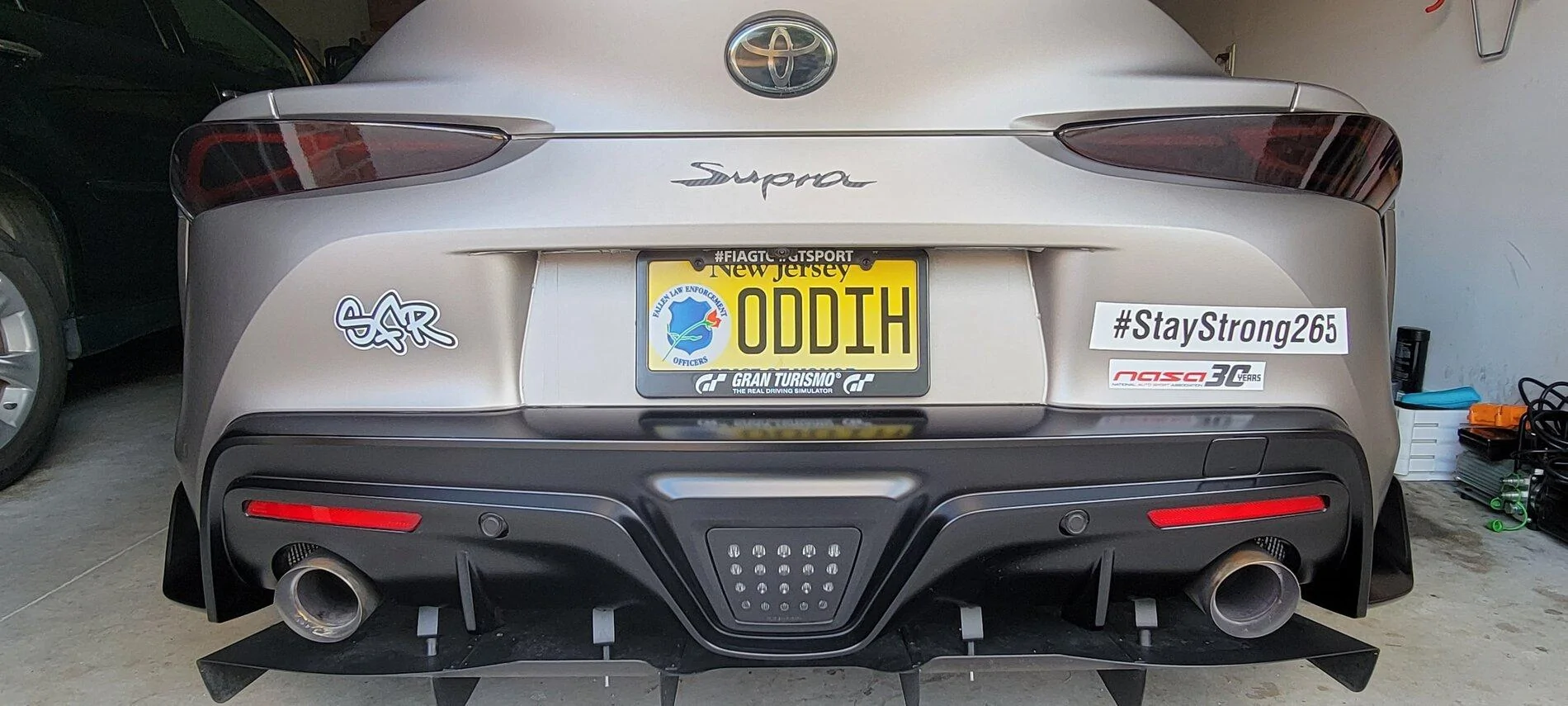

instead of saying it's not correct, say what not correct.
Sorry, I wanted to make sure you were not running rake before commenting. It was early, apologies.
So, the front of the car side looks like it's probably properly installed, but the fins on the bottom should run parallel to the ground, lifting the tail up a bit. The rear corners should align with the factory rear spats.
Sorry for the photo, it's the best I have right now. That's the same Verus diffuser. My guess is that your diffuser was installed using the same length spacers for all for of the rear most points, when the outside two should use smaller spacers to pull the whole thing up. This will provide the most downforce possible.

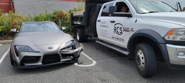

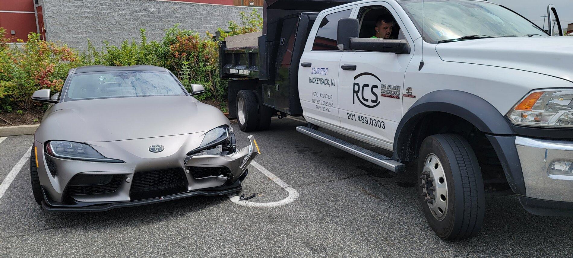

Freakin people need to learn how to park! This is why I never take my Supra anywhere except for work. Cant trust anyone these days. Sorry to see this.
