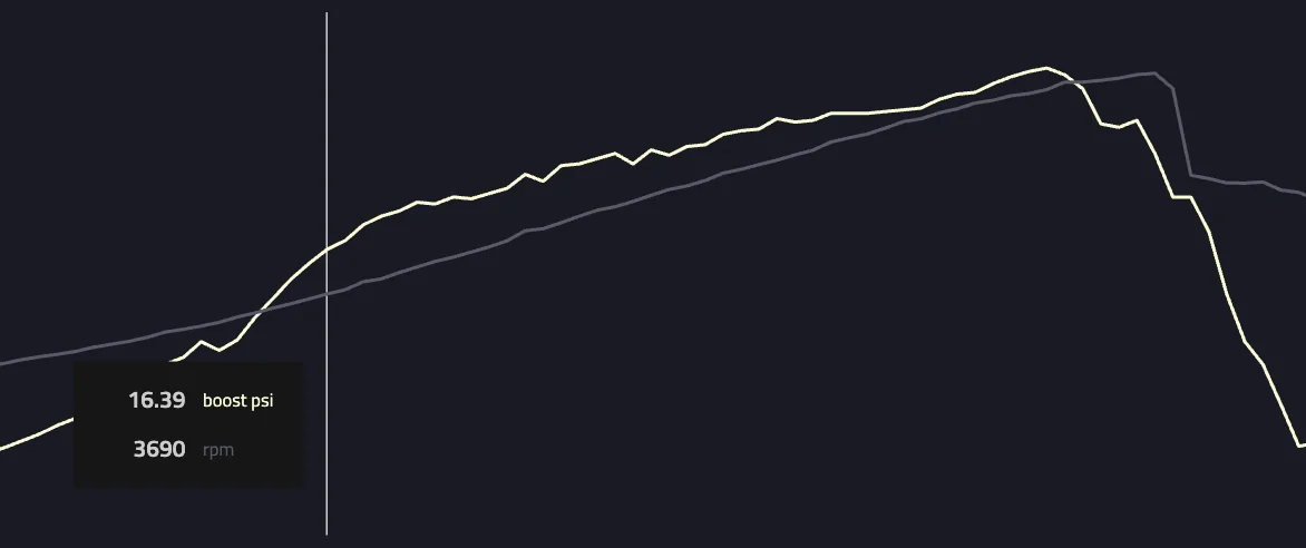

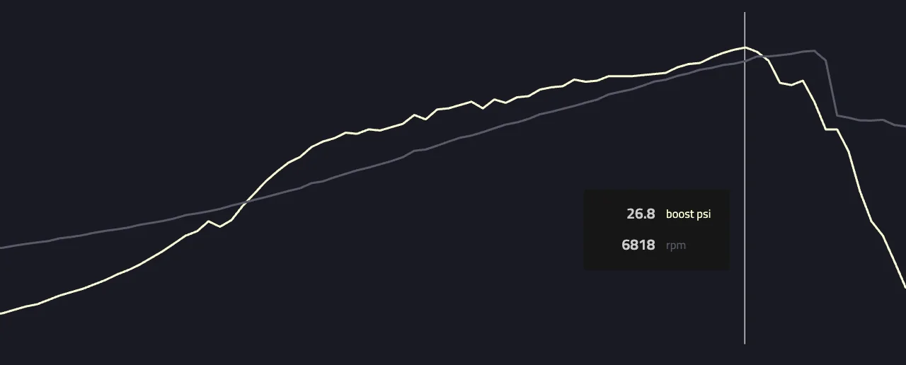

It's all in the tune, you can tune the OEM turbo to feel like a lazy big turbo too. This is actually a key part of tuning larger turbos (and even the oem turbo) on the stock fuel system with ethanol blends. You have to ramp the boost in in the low/mid range to avoid maxing out the oem HPFP.
Below is a good example of a Supra I am currently tuning. Pure800, 100% oem fuel system, 33% ethanol. You can tune the boost curve basically however you want it. This curve is by design to make sure the OEM HPFP doesn't max out with ethanol. There is still some room for more boost down low. Tune isn't finished yet. I've also used a curve like this before to help with traction as well. You can even tune each individual gear with a different boost curve.

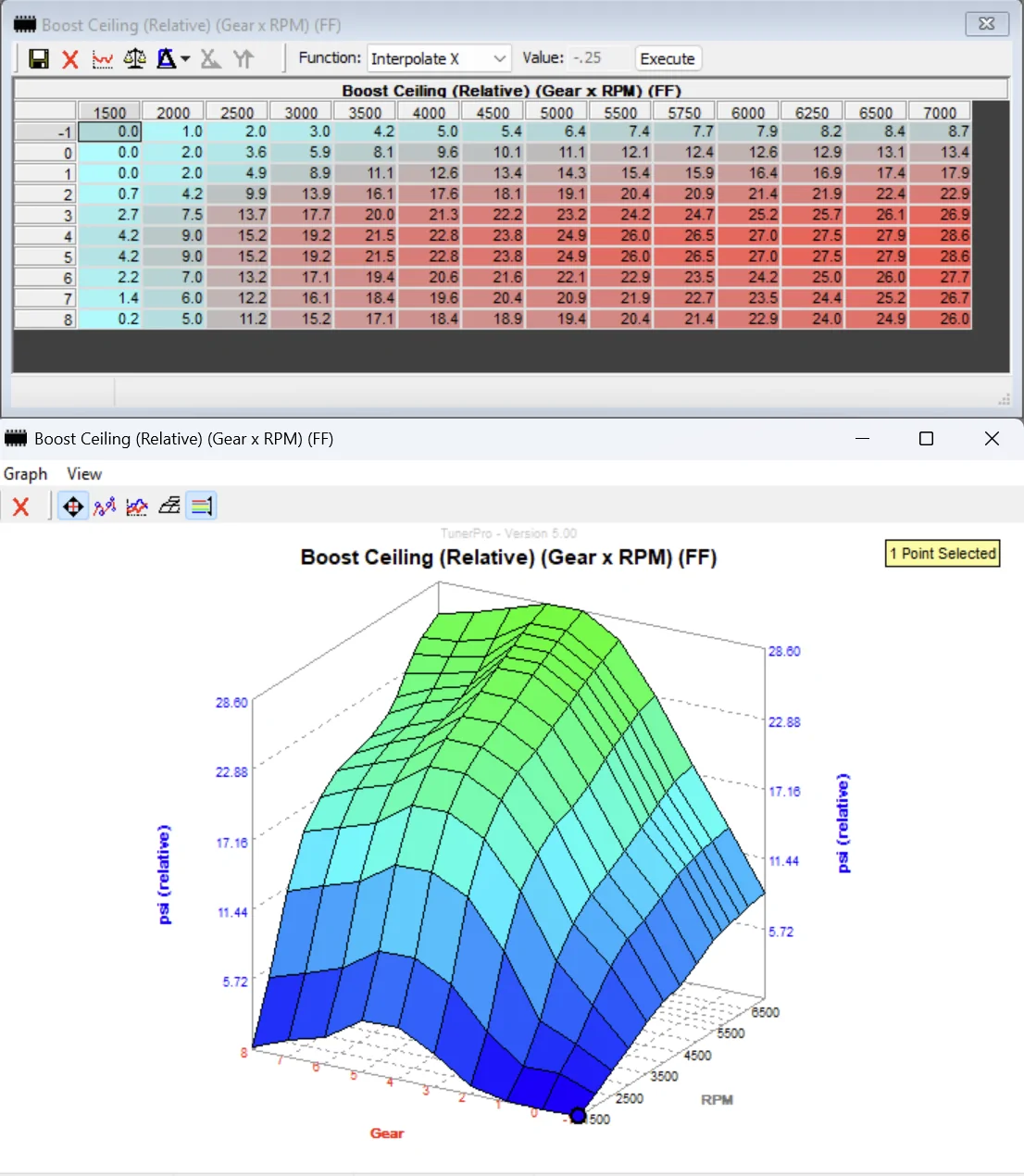

Here is an example of custom boost curves per gear. Lower in the lower gears for some hope of traction and you will also notice that the shift to 6th gear drops in boost right in the RPM range of where 6th gear hits if I am shifting at redline in 5th. This is to help my transmission last a little while longer. ;)

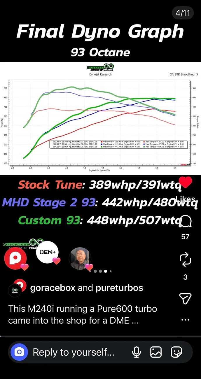

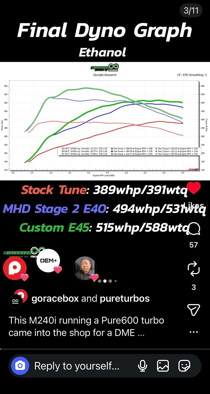

Found this page trying to get more info on the Pure 600. Not too much info out there, but seems like 93 will get about 440-450 whp.
The stock run is also with the Pure600.
Another benefit of the Pure600 also seems to be the power holds/peaks until redline, whereas the dynos I’ve seen with stock turbo the power drops after 5500-6000 rpm’s.

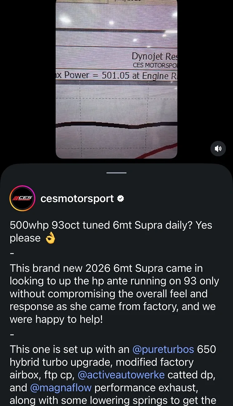

To answer OP’s question of getting 500 whp on 93, seems like you’ll need at least a Pure650
