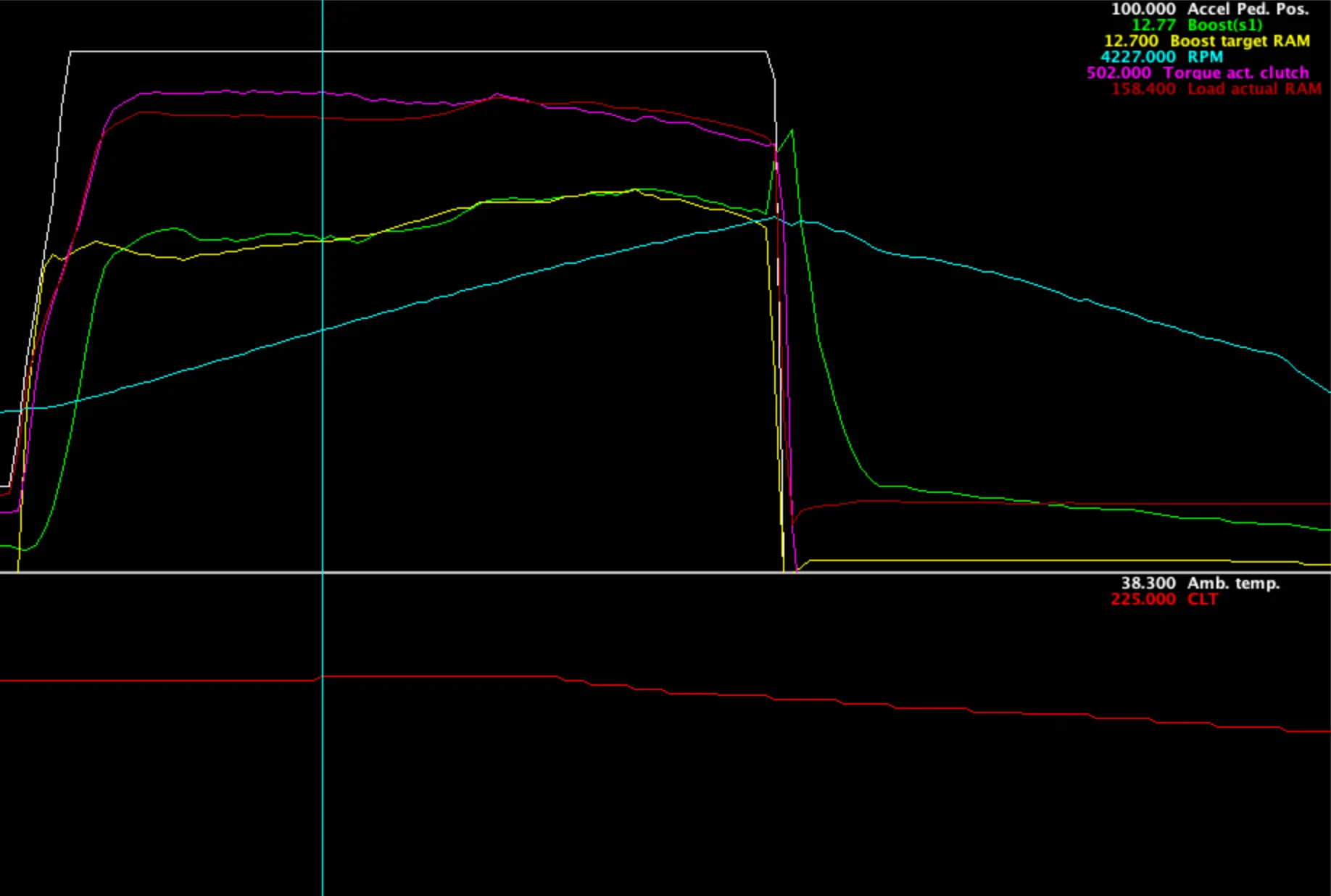

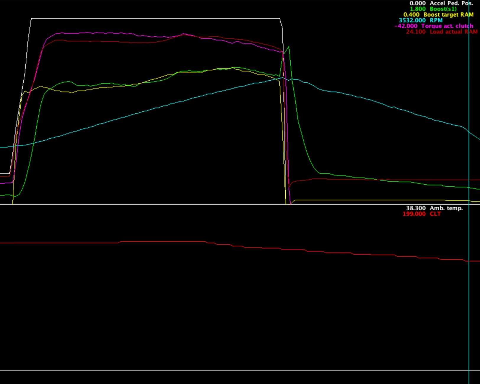

Here is my bone stock 2023 M240i dropping 26F coolant temp from a single gear pull. The drop is more drastic on the M lites because they have shutters in the front that cover the cooling stack in normal cruise mode. So this is a combo of the shutters opening PLUS the coolant escalation mode happening. Also why coolant was 225F to begin with in 38F ambient. ;)

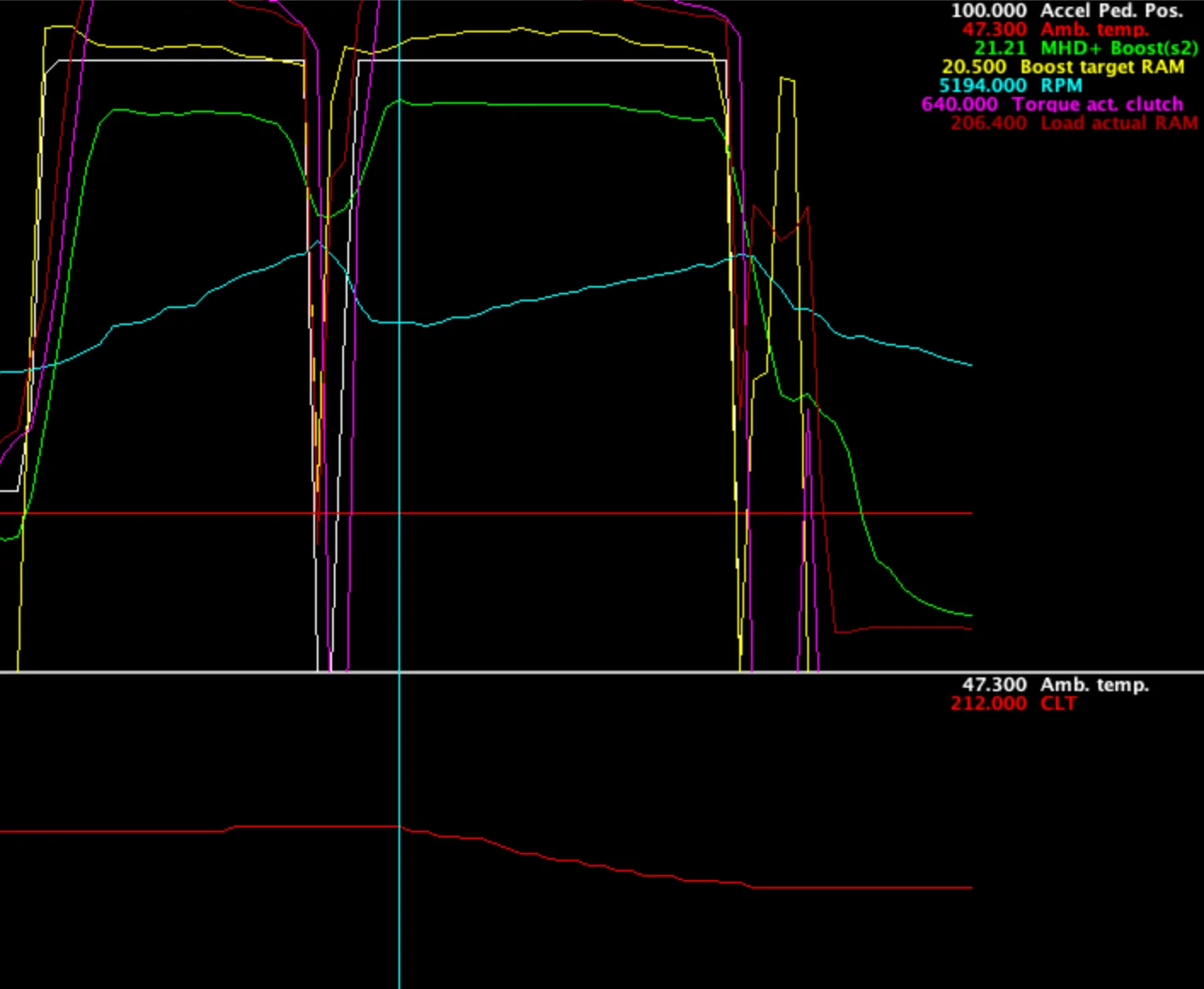

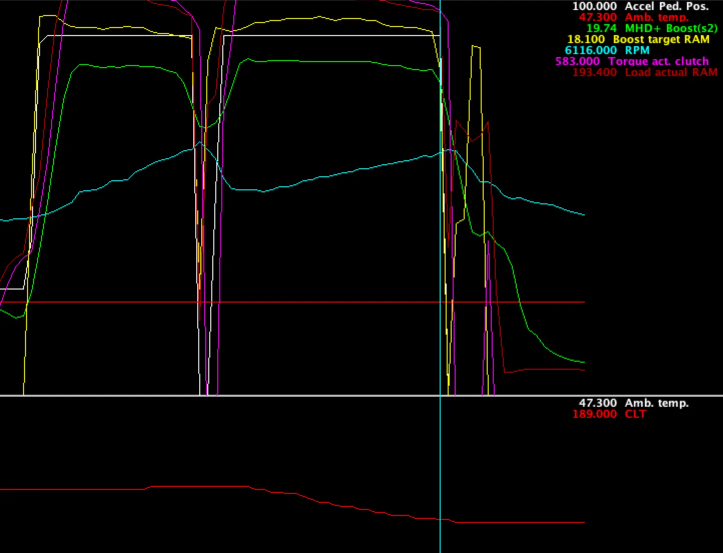

Here is a tuned on E30 manual Supra dropping 10F over a multiple gear pull. You can actually see the DME initiate escalation mode here at the end of 3rd gear and coolant temp drops.

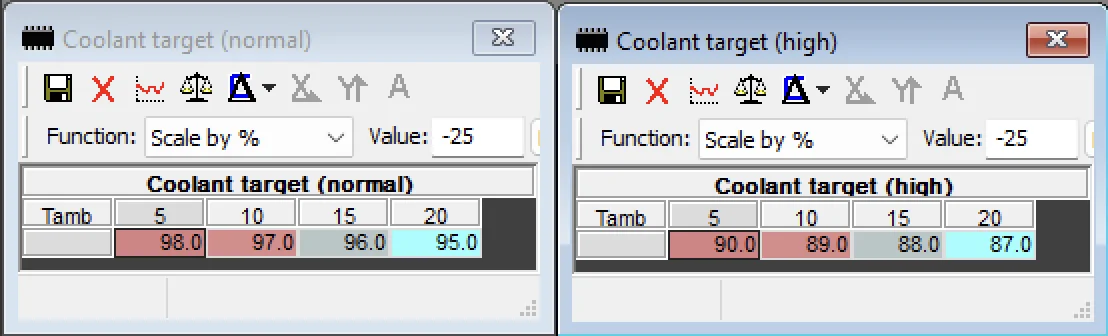

Here are the two DME tables. On the left is normal coolant setpoint. On the right is escalation mode. You can see it targets a coolant drop.

There are also fan control tables that ramp up the cooling stack fan duty cycle significantly.

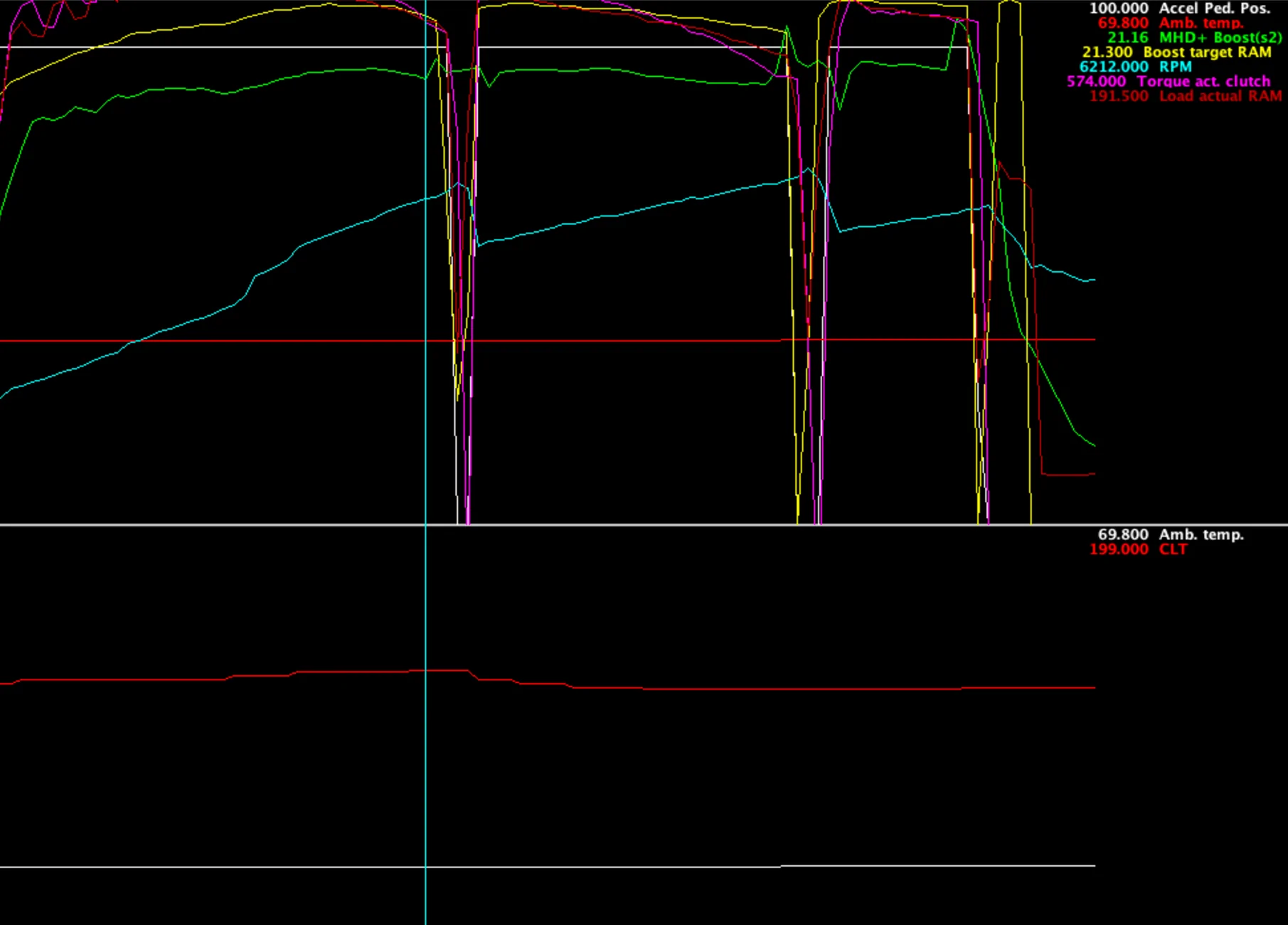

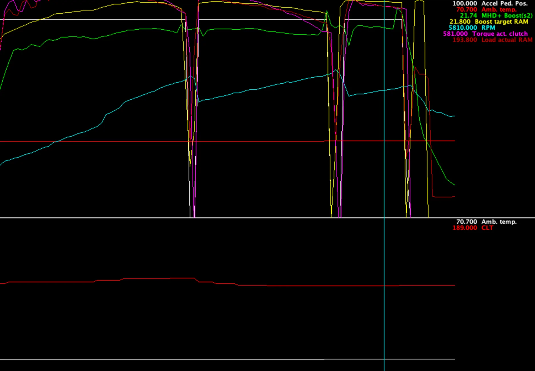

Here is another log from that E30 Manual supra in cooler ambient temps dropping 23F
