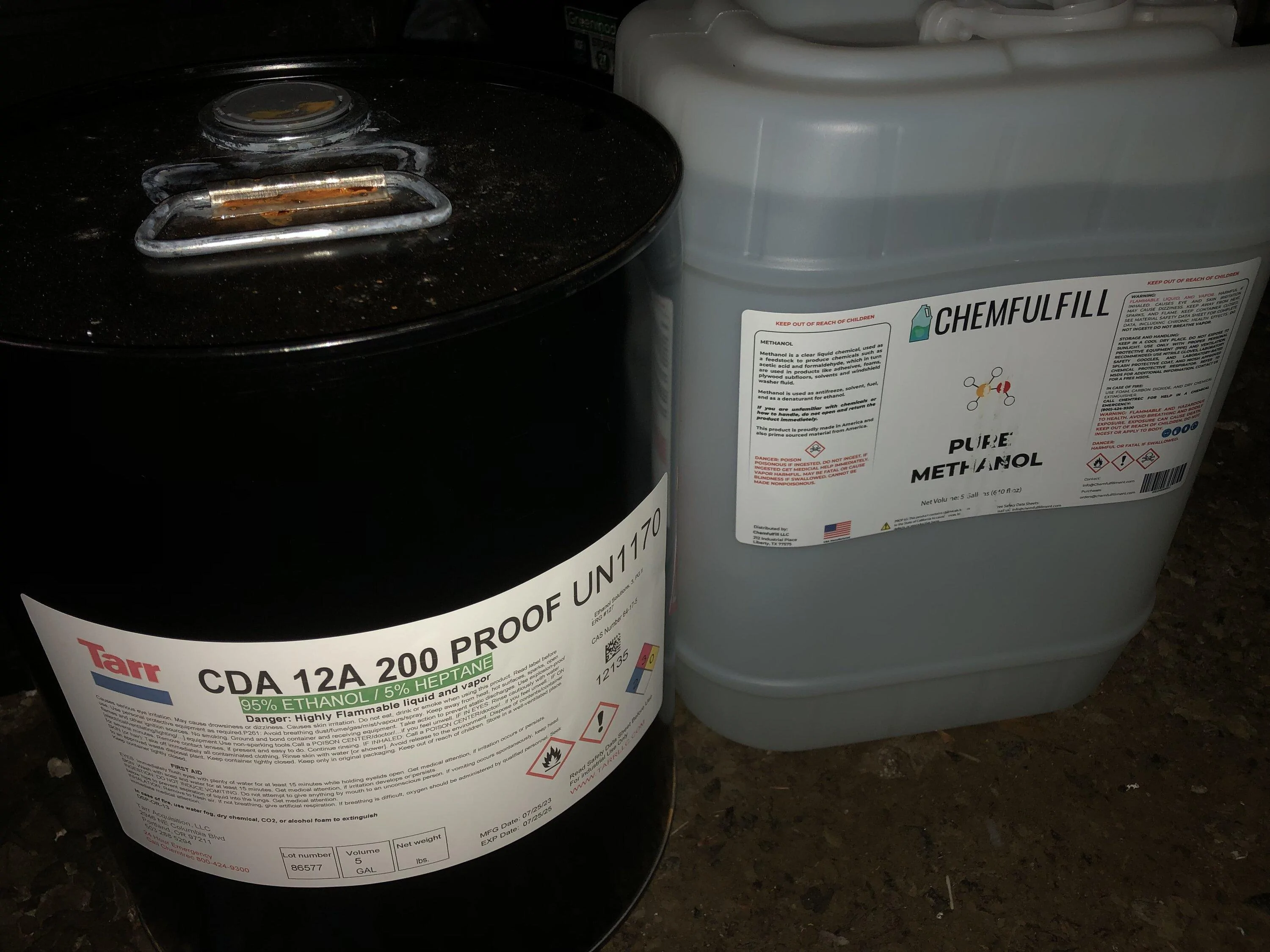

Ok so there is no ethanol or e85 fuel anywhere near me. I have the flex fuel kit and my ethanol/fuel ratio guage is my torque guage on my display.
My question is can I buy straight ethanol and add it to my fuel? You can buy 200 proof denatured ethanol in 5 gallon jugs for $200 or a 55 gallon drum of E85 for about $500. Honestly the more I think about it a Pure800 might be the best bet.
All opinions and recommendations welcomeā€¦.

$9/gal for E85 is steep as hell. For reference, it's typically less than $3/gal in CA.
Agree with you that getting a 93 tune with a turbo is a better route.
Wouldn't recommend trying to add Everclear to your tank

I went with CTS and no E85 is anywhere around. Already had water meth. Now I'm in process of going flex fuel PI. Find a local chemical supplier and denatured ethanol should be about $11 a gal delivered. It sucks but better than straight pump gas.

Iā€™m definitely leaning towards the Pure 800. Right now with exhaust and a tune Iā€™m at 440whp on 93. Just wanting a little more. On E40 or 50 the car makes 500. Iā€™ve been kicking the idea of denatured ethanol but Iā€™m a little apprehensive. Ok a lot!
Yes the $8 or $9 a gallon for E85 is crazy but itā€™s just not available here.
