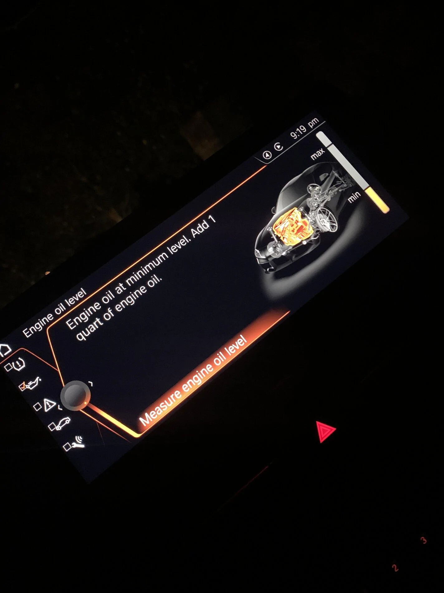

Lmao so I took the car into Toyota today and waited for 2 hours only to be told that a case has been opened up with Toyota and to come back in 1300 miles.
Ok. Cool.
Well I had mistakenly assumed that the Toyota tech filled up the oil and that they were gonna measure it over the course of 1300 miles but guess what awaits me when I get home? Guess I’ll be calling them tomorrow.
Ok. Cool.
Well, if you drive it with the oil level that low for 1300 miles, you WILL DEFINITELY need a new motor when you go back to the dealership. Lol
Lmao I brought that up when I initially scheduled today’s appointment and the service advisor basically shrugged it off and said “I mean that’s what the warranty is for right.”
sorta...the warranty book also states that the consumer has to maintain the car so if there's warnings like these that get ignored long enough that becomes negligence and voids applicable warranty haha.
days ago i checked my level it was at down 1/2 quart (middle between min/max). I took it to an autox/skidpad event...checked it there after some runs - showed full. Came back home and checked it twice (two days apart) and its sitting at 1/4 under max.
so maybe you'll have. a min reading for a day or two and the following days it'll be fine? haha.
