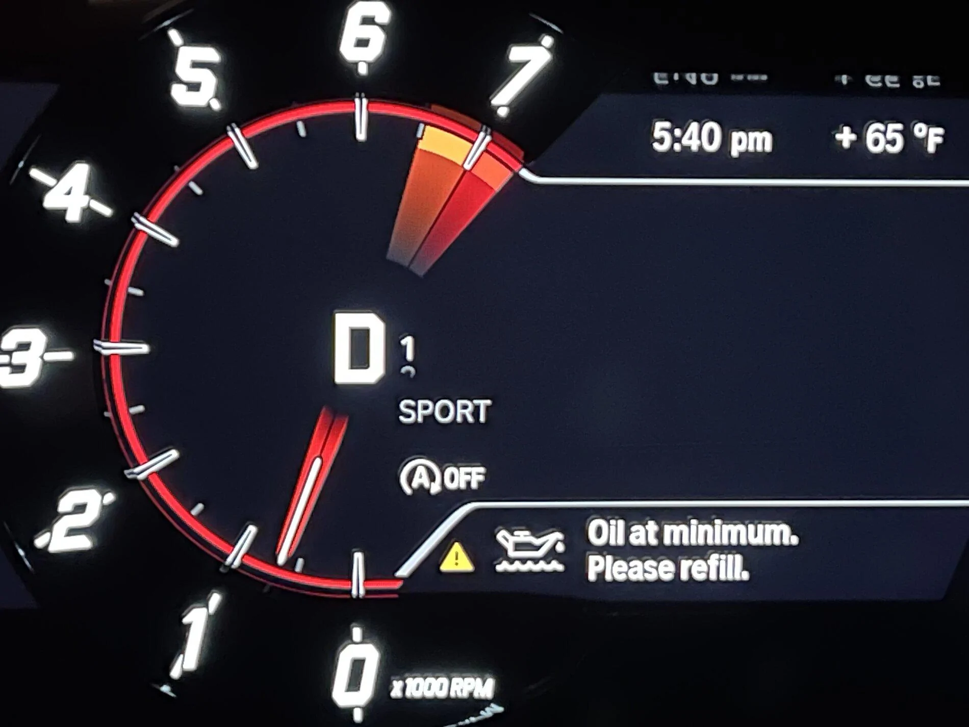

Short question. Got a quart of oil in my trunk. If the "add a quart" message appears, how far can I drive, and is there a speed limit for that time? Can't find any information on that in the manual.
You should drive reasonably but not for 2 more weeks. If you have the liter in your storage area add half and then measure again. Some owner see this message and add the half and its full again. Take it slow, add a touch, re measure. Their is some variance in the system, ensure you are on flat ground and the motor is warm. Its just adding oil. Ive never had the warning appear as I measure weekly.

Thanks for the tips, I will do it the same way. But I was thinking of something else. For example, I'm driving about 500 miles tomorrow. If the message pops up and I have about 100 miles to go before I get home and to my toyota dealer, what should I do? Keep driving and go straight to toyota or stop and refill? I'm just wondering where the line is between keep driving and better refill. And of course how fast I can still drive without accelerating too much.

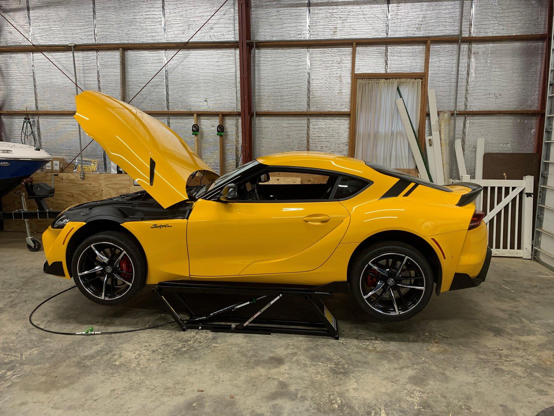

Did the after AX season oil change, recall scheduled for Tuesday, then off to sleep until March. :sleep:
Changed the oil last March at 1500 or so miles and this time at 6700 miles. I did not do a precise measurement but around 6.5 to maybe 6.75 quarts came out. Pretty pleased with that. Still using 0W20 Castrol Edge. Car has measured full at every check.
