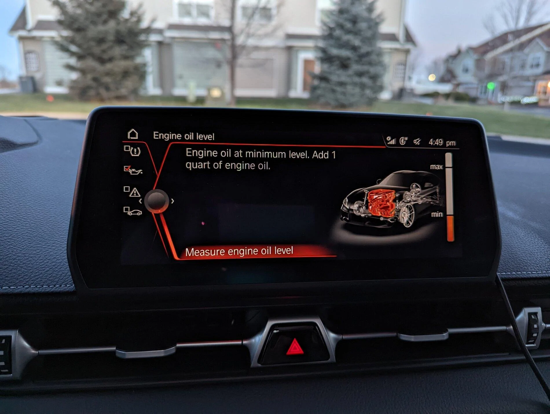

Well, well, well...
After 4k miles I have the infamous message.
What makes it dubious is the car has been in winter storage for 3 weeks and this was the reading back then.
Where did that oil go? There's no leak in the garage. Cold starting it? Or sensor/marker on the screen is very arbitrary?

The oil level reading in our cars is not infinitely variable. It drops in quarter increments. What you saw three weeks ago was not the exact level. It was the level that was closest to the last quarter mark. It was probably right on the border between the one quarter left increment and the at minimum/add quart increment. Three weeks later the reading is ever so slightly lower but now rounds down instead of up and you get the level at minimum/add quart result. Or, if you measured in a different location, it may not have been exactly as level as the other. You also had to drive a minimum amount before another measurement is possible and that could have dropped it just enough. Either way, not a big deal. Add a quart and don't lose any sleep over it!

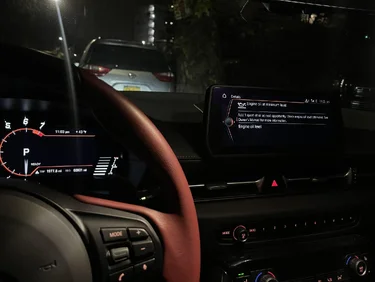

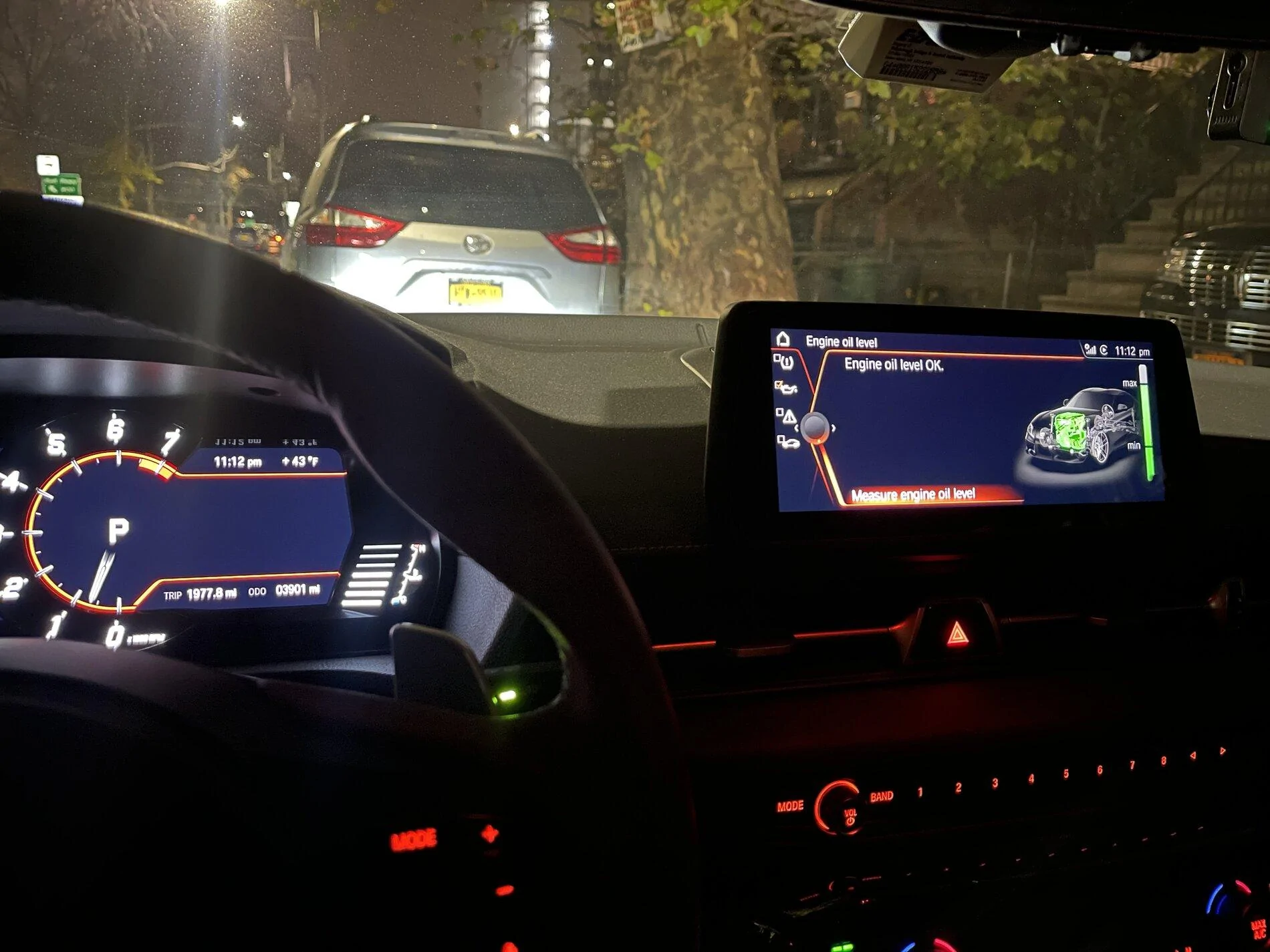

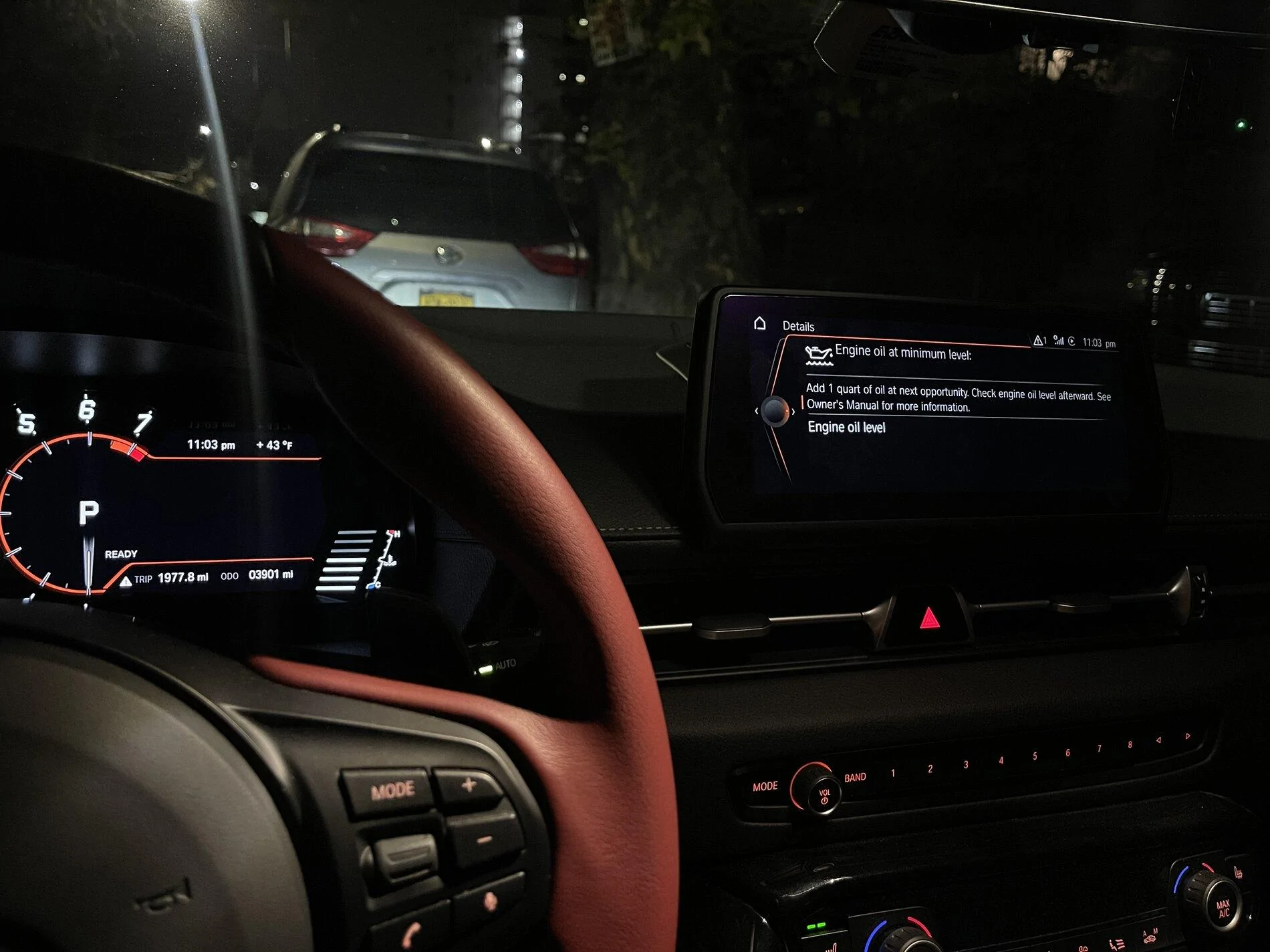

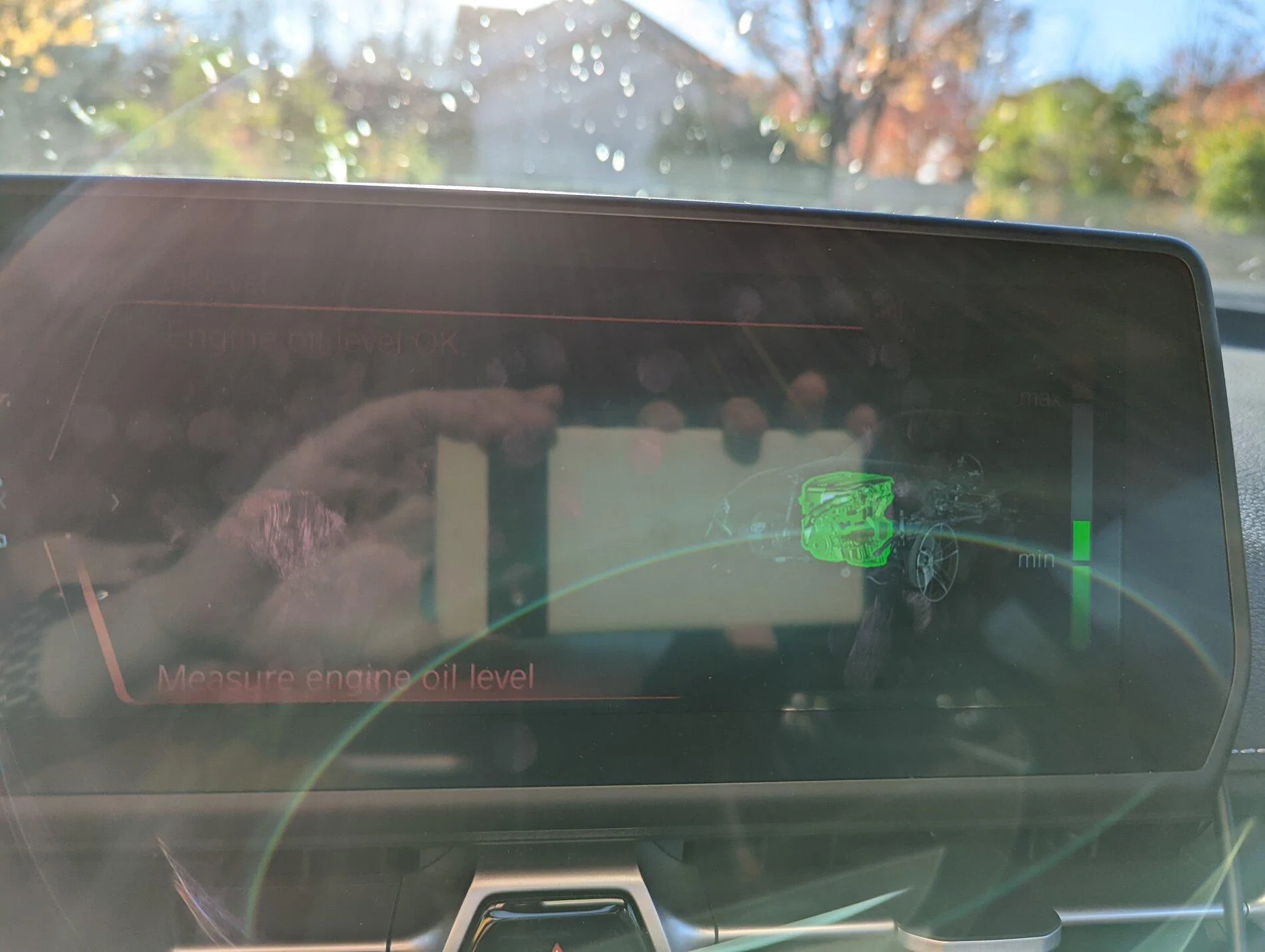

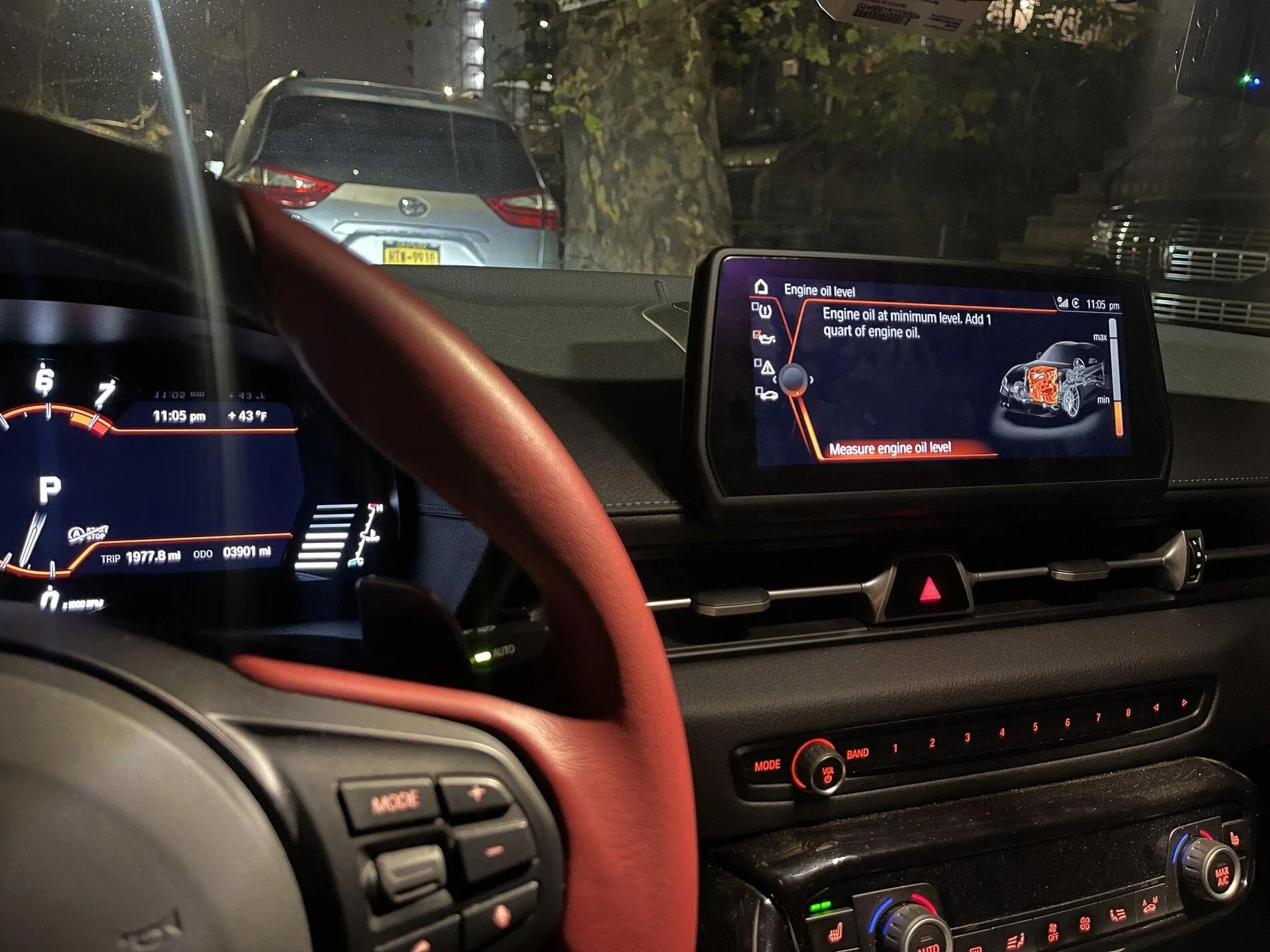

First time I had low oil was 2100 miles (MST intake installed at 1.2k miles). I added a QT and took it to Toyota the next day. They said no issue, and to ‘watch my oil on road-trips’ (the road trip in question was going to upstate NY from NYC). Second low oil warning at 4k miles about ( Catted Downpipe installed at around 3.2k miles I wanna say). I carry a QT in the car so I added another and opened another case with Toyota , said they will call in the next day.
what’s odd is , I was at the minimum level, added 1 QT and now I’m almost full? Does that make sense?
Also one thing in common, this happened when I drove 1.5 hours to NJ from NYC, and then on the 2hr drive back I had the low oil warning. Was driving Normal mode a lot but also definitely pushing the car alot on those empty highways. Would appreciate any input!
