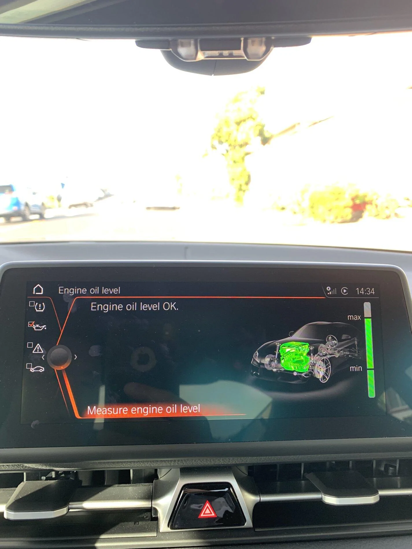

1,000 miles since my last oil change and my oil is still at the full mark. I hope it stays there : ) I burned a quart through the engine break in phase so hopefully that was it. My engine is at 6700 miles now.
This seems to be a normal consumption rate. Mine burns a quart every 4,000 miles.

I took some more data points and learned some things, I really don't know where I'm going with this I'm just enjoying collecting the data. Maybe debunking the myths about the oil sensor being bad? Anyways here's some info, and check out the data in the spread sheet.
1. A quart of oil equates to ~11-13mm from the perspective of the oil sensor
2. I did not measure my car's oil immediately after a dealership change so there is a gap, but I think it's safe to assume my oil level was between 94-96mm post change. This is very interesting because after hitting the min marker, we can see that one quart puts my oil level at 100% but not at dealer spec, so how much oil is actually in the car? (You bet I'm gonna measure as soon as I do an oil change, but winter is coming so might not be until April)
3. If the dealer put 6.9qts (6.5 liters) in my car, the iDrive marker for 100% does not drop to 75% until I lost about a quart from total oil. Now this is not a sensor issue, the oil thresholds for iDrive are just not aggressive. They sit low.....if the dealer overfilled, tbd. So in this situation, iDrive did not warn me about low oil until I had lost ~1.5 quarts. Not thrilled about that, but not an engine ending scenario. An easy fix would be, just put a quart in when iDrive hits 50% instead of min.
4. I REALLY want to change my oil and see what exactly 6.9 quarts reads, if we know what that max is, we can know when is most appropriate to put a quart in.

First off, I put this in Google sheets so it's more readable:
Google sheet
I'm not going to waste my time trying to measure out exactly 6.9 quarts. Seven quarts reads full. I will 99.9999% guarantee you 6.9 does as well. I would have said 100% but I've learned nothing in life is ever 100% guaranteed. ;-)
You are seriously overthinking this. Put in 7 when you change the oil. Add a quart when you get the notification. And enjoy driving the snot out of it.
Good advice. One point. Put a touch less in given the variance with measurement. If it needs 1 litre or qt put half and re-measure and add if needed.
Also with the numbers your seeing OP Chadwell - I would have the dealer change the sensor. Its the driver for what you see on the screen. Members have changed it and been not in the pool for oil monitoring.
