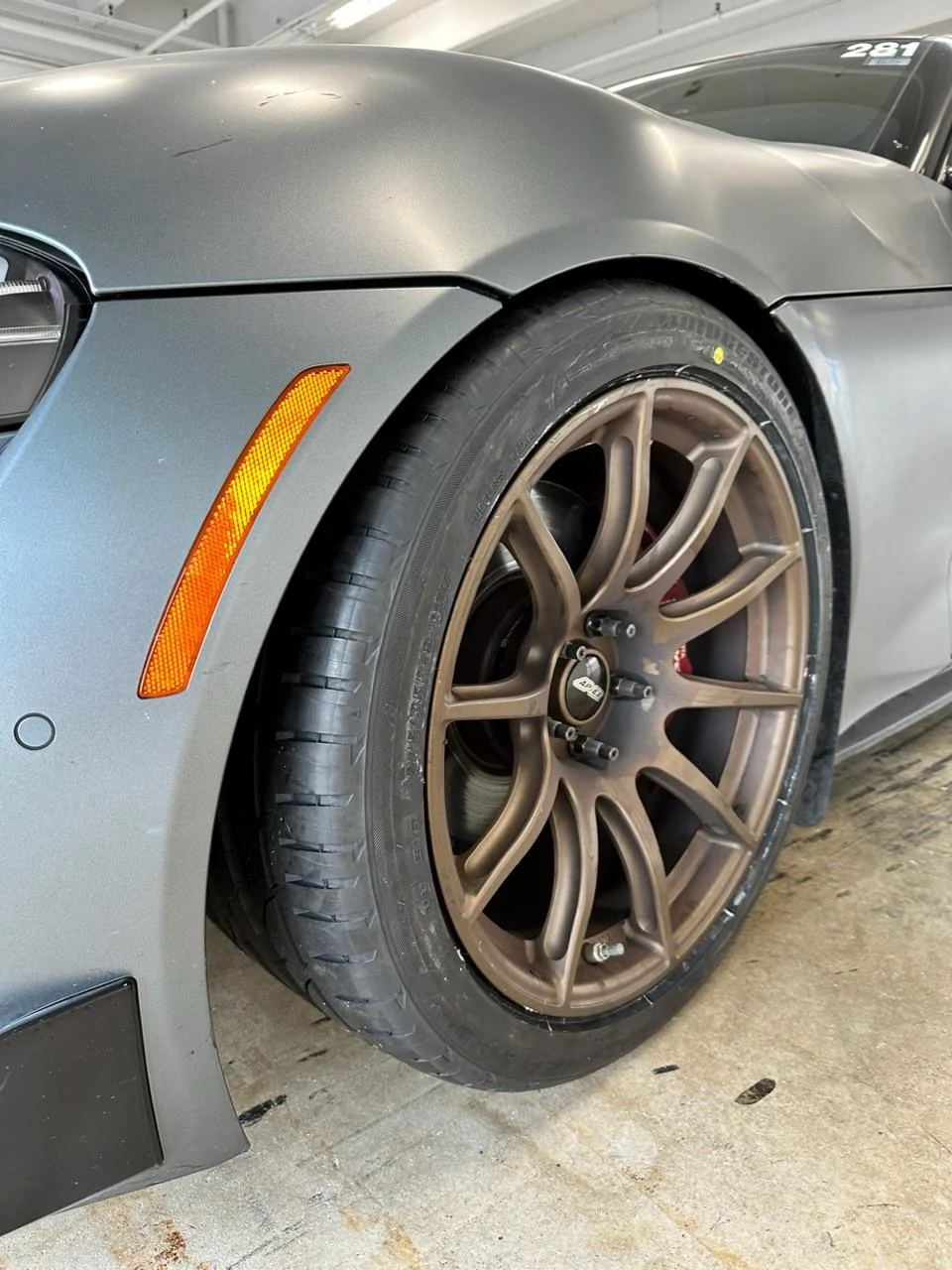

Ohlins are in route. I got the last “in stock” ones from Turner MS for under $3k, the RSR cancellers from Jackie PHD, more tires from Maxxis (way too much rub on my low height Eibach US spec springs) and Hawk DTC 60 brakes pads. Really ate up the Paragon pads. Could have been from the extensive rub.

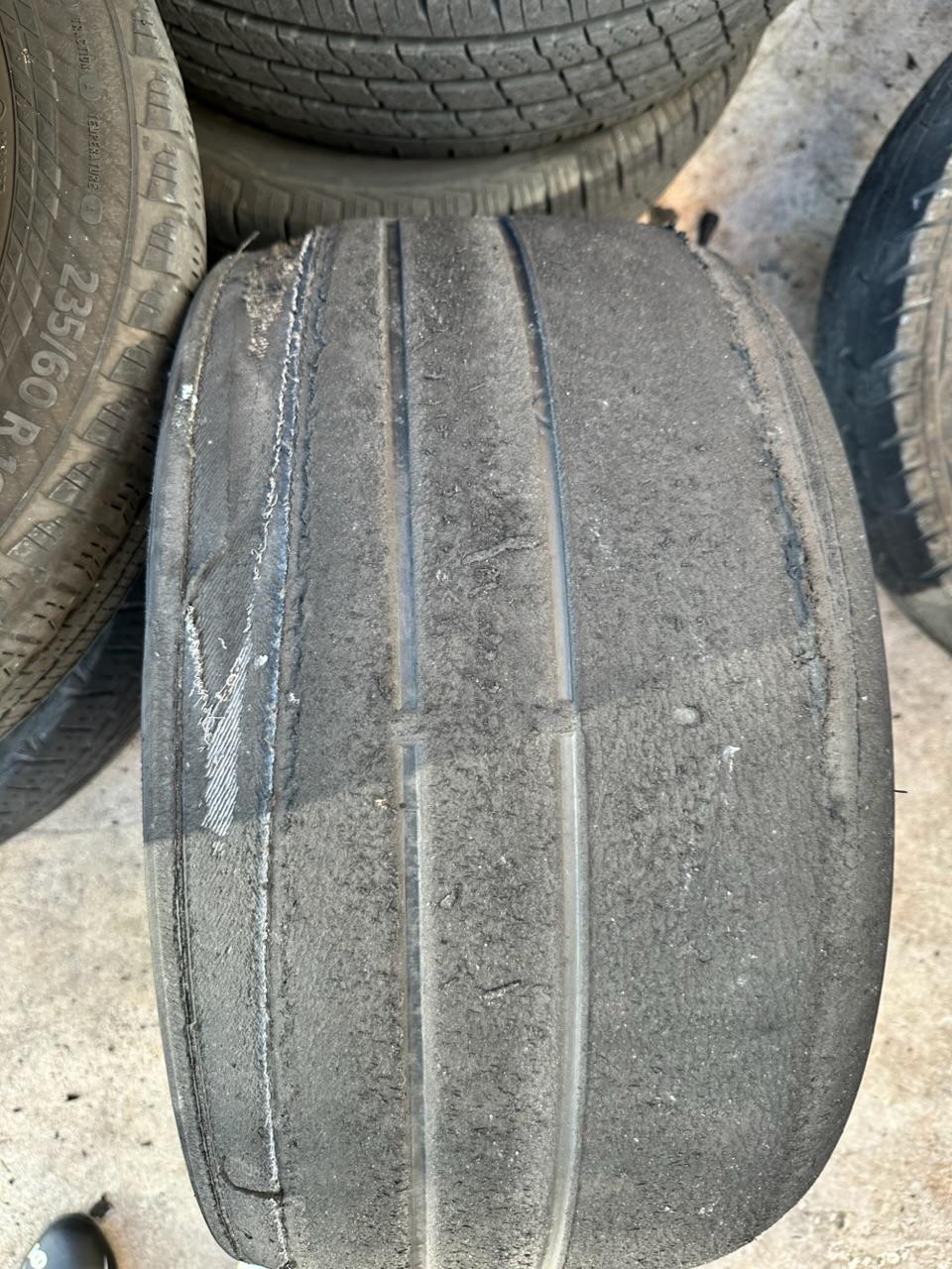

Those tires are wasted!

So wasted I had to buy an emergency replacement to get home ?. At least I’m on my way to having a nice set of “rain” tires, backups… I definitely need more clearance and ability to adjust the height with this square 275/35-18 setup. Was going faster/quicker around the track this last trip.

So wasted I had to buy an emergency replacement to get home ?. At least I’m on my way to having a nice set of “rain” tires, spares, backups, you name it… Hence my wife is looking at buying a truck (bronco) or I’ll get a little track trailer from Harbor Freight to tow some track goodies, such as tires. Guess going faster around the track finally got me to this state. I went a whole 3 seconds quicker than my last trip to Homestead. Push her much harder. I definitely need more clearance and ability to adjust the height with this square 275/35-18 setup.

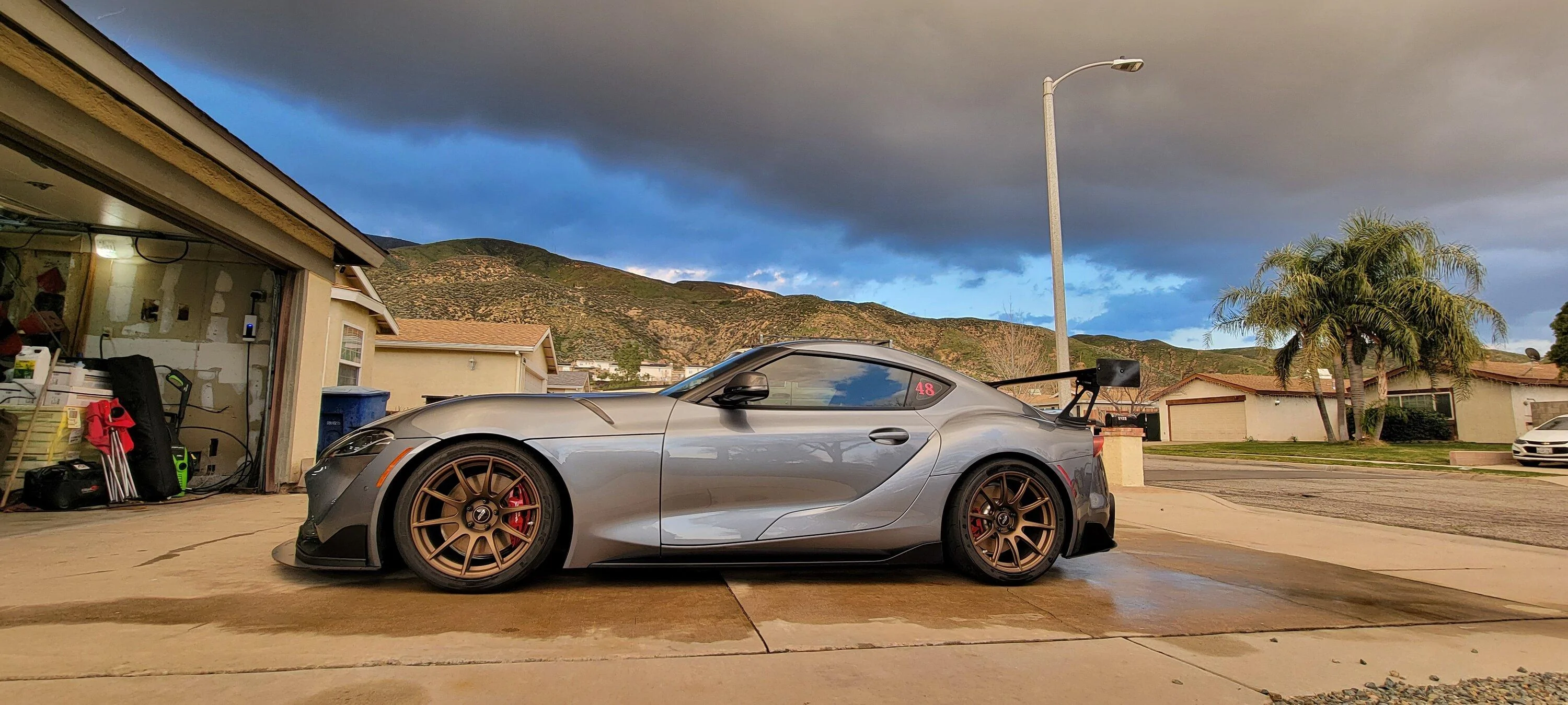

Your car looks so sick ?? Are you on an 18 square setup? And if so, which springs did you go with? Thx @Evolution
Yep 18x11 square on 315s. Stock Ohlin springs.
