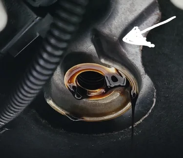

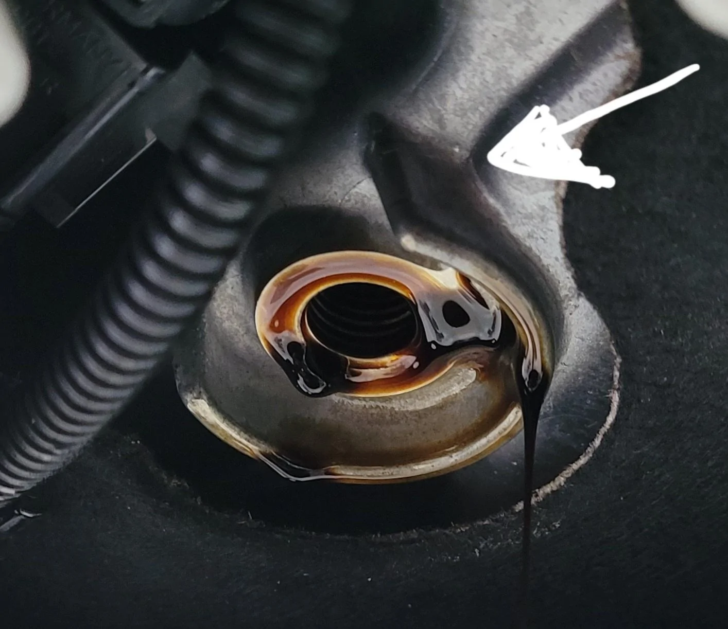

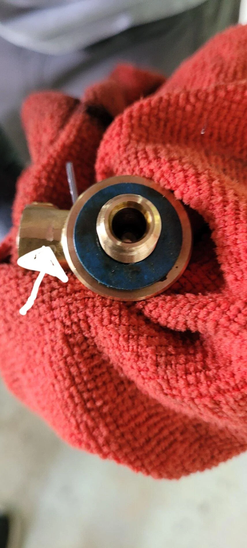

I attempted to install the F-139 drain valve yesterday and it looked like it would be a good length for fitment above the splash shield, but on the last turn or two it began touching the pans protective lip around the plug. I tried with the supplied washer and then an OEM crush washer and neither provided enough clearance. I sent an email to the Fumoto support describing the issue and asking for any recommendations.
I am extra cautious when it comes to brake fluid lines and anywhere oil needs to be sealed in. The only options I see possible are 1. notching the valve where it touches (but it might compromise the structure of the expanding and contracting valve due to heat cycles) 2. grinding down the lip (personally never an option) 3. double up washers to make up the gap (probably can work but prefer something else) 4. make a 3 or 4mm threaded spacer of the same metal, slightly larger in diameter than the crush washer, and loctite onto the valve and use an oem crush washer. The only option of those Id be remotely willing to do would be 4, but even then...still would lean towards not using it.
We'll see what Fumoto says and if they have any proven methods. If their initial recommendation is something like 4 or they have an adapter, I will try it, but with 100% skepticism leaving the splash shield drain cover off and inspecting for leaks often for the first few weeks.
