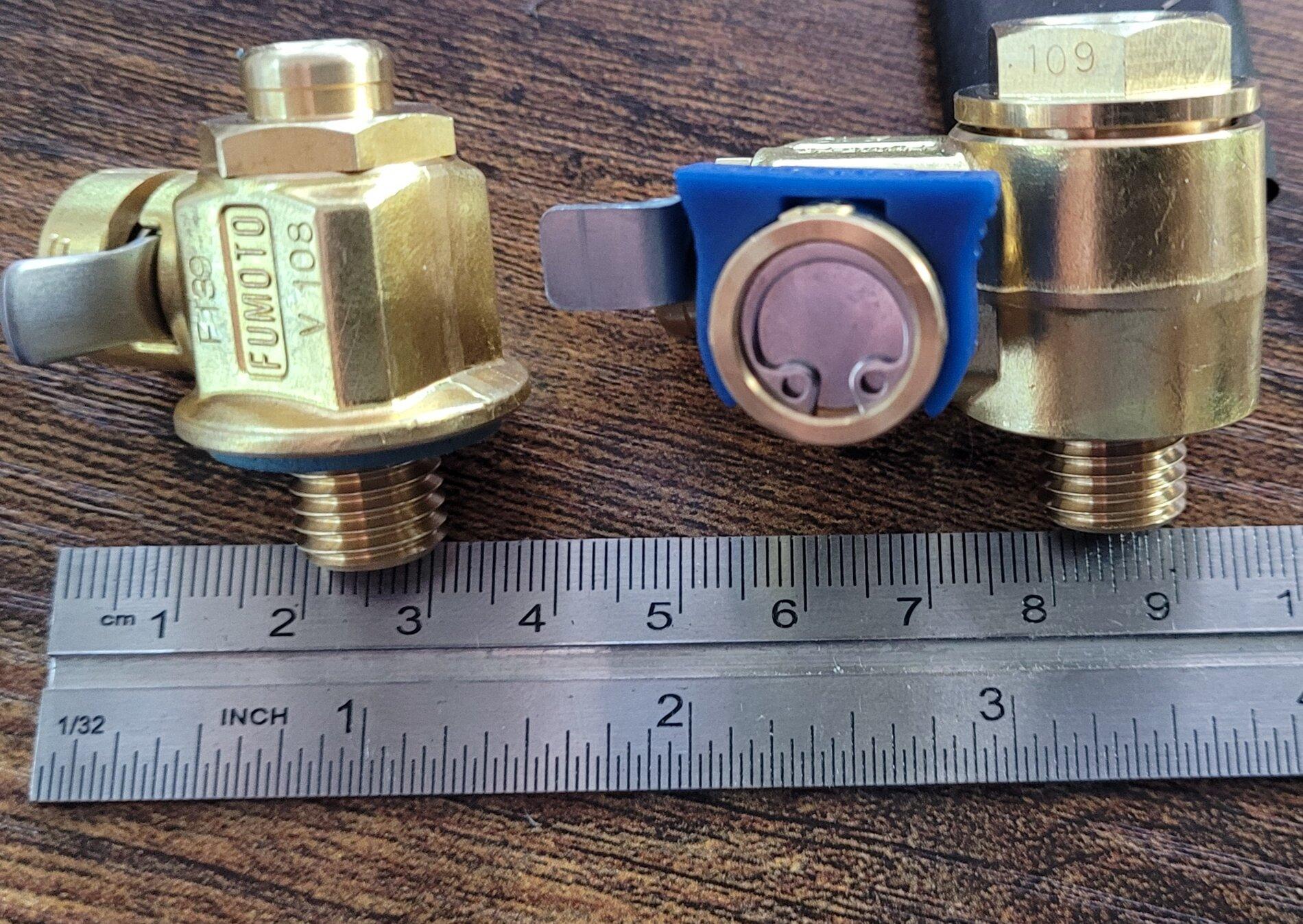

Fumoto got back to me promptly and they were super nice and helpful. They're sending me the F109SX to try with a prepaid envelope for shipping what doesn't work back. If it can fit in that gap in the lip around the drain and only drops down to roughly the same height as the valve without the stubby nipple, I think we got a winner.

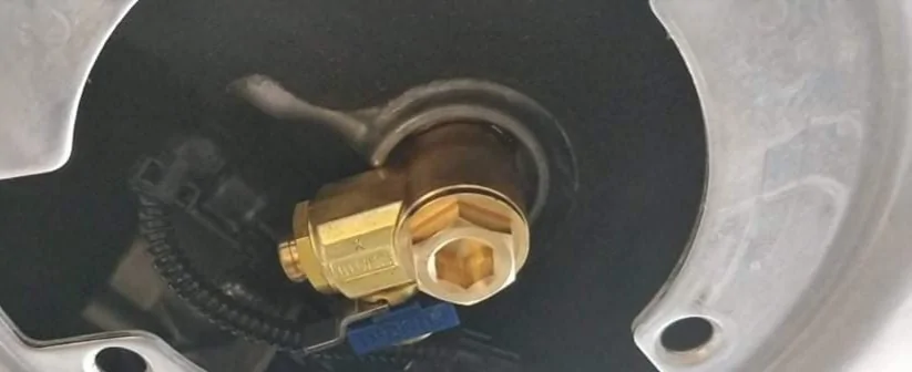

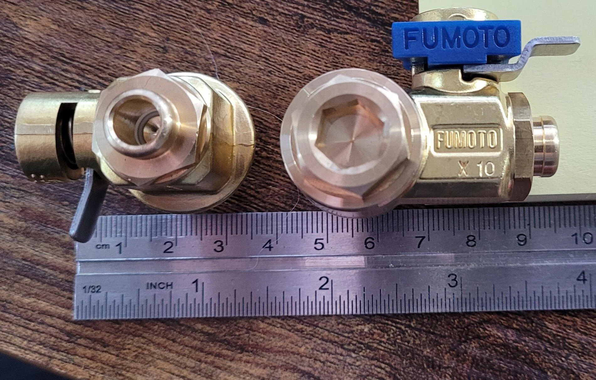

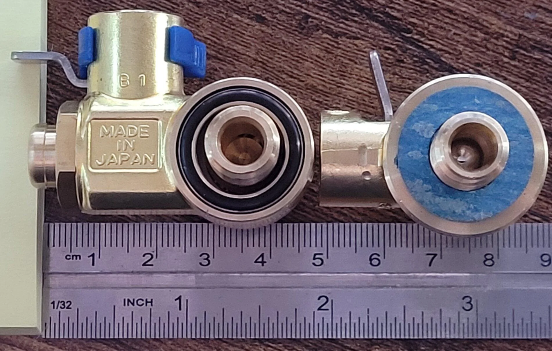

Here is a pic of the replacement valve I got from Fumoto. I already changed the oil when I went to install the first time, so IDK when Im going to try this one on. Probably when I get an "add a quart" warning if I get another one and switch to a 5w-30 for my climate. My concern right now is the opening in the lip surrounding the drain plug being wide enough for the horizontal valve of the F-109SX vs the vertical of the F-139S. Wish I wouldve measured it now.
*one or two of the pics look a little distorted but the ruler starts at the beginning of the brass main body*

Any updates on the correct Fumoto and fitment with the oil pan's drain lip and plastic cover?
