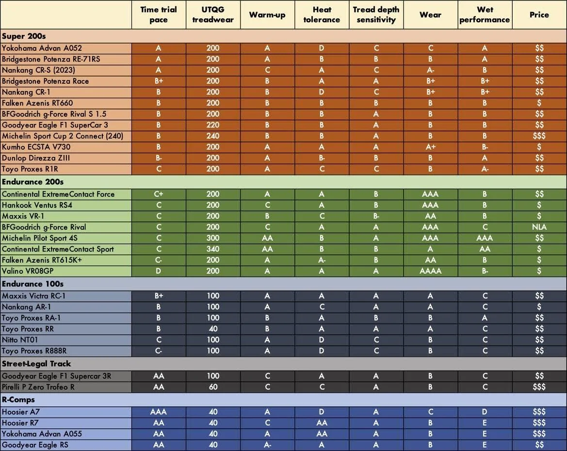

I'm on advan ad09 right now (supposedy an enduro 200tw like an Hankook RS4 but I don't actually like them, or I need more seat time before I can heat them up properly), I'm strongly considering the ECS02 as a seat time tire with consistent grip loss on track, not a hotlap / laptime tire. PS4S I've used on my BRZ and they chunked with heat, felt pretty solid though. I had ECS02 on a NA 93 Miata (~2300lb ~100hp car vs ~3400lb ~400hp supra lol) and I liked them, anyone have any downsides about the ECS02 or can comment on PS4S for track on supra?

Yessir. Glad to hear you’re enjoying it more! Track time that is. Eventually you’re going to want a more dedicated track tire, such as a super 200 or endurance 100
If you can feel the car going sideways, know when to lightly back off the gas, never brake too hard, correct that snap oversteer, roll back on throttle, not needing your ears to do so, time and time again - pull the trigger on one of those endurance 100s or Super 200s categories above ☝ Maxxis Victra RC-1 my fav bang for the buck. Nankang CR-S another fav of many HPDE track rats. Night and day compared to any daily ”summer” tire.
Misnomer you can’t drive on these in the wet. You absolutely can! Very slowly lol. But seriously
 it will make you more confident, safer and faster. It’s a great experience for learning those dry high speed breaking points at much lower speeds. On track. If you don’t want to change tires when you get home, for in town driving, just go extra slow and stay off highways. I used to change them every damn time. Now I don’t have to during track season (six months out of the year).
