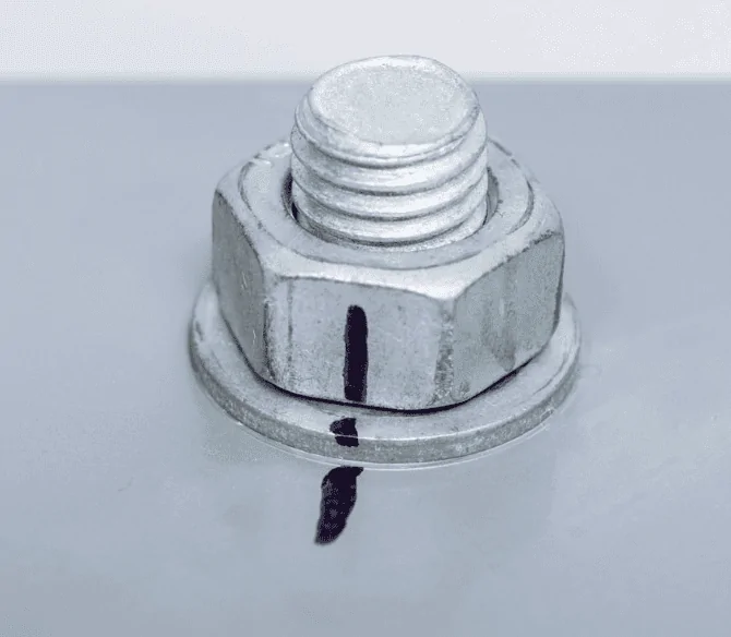

Pro tip:
Mark your suspension bolts with a white paint pen. Mark a line from the bolt to the surface below it. That way you can quickly look over everything between/after/before track days to see if anything has shifted or come loose. It has def helped me over the years.
Like this but with a white paint pen:
