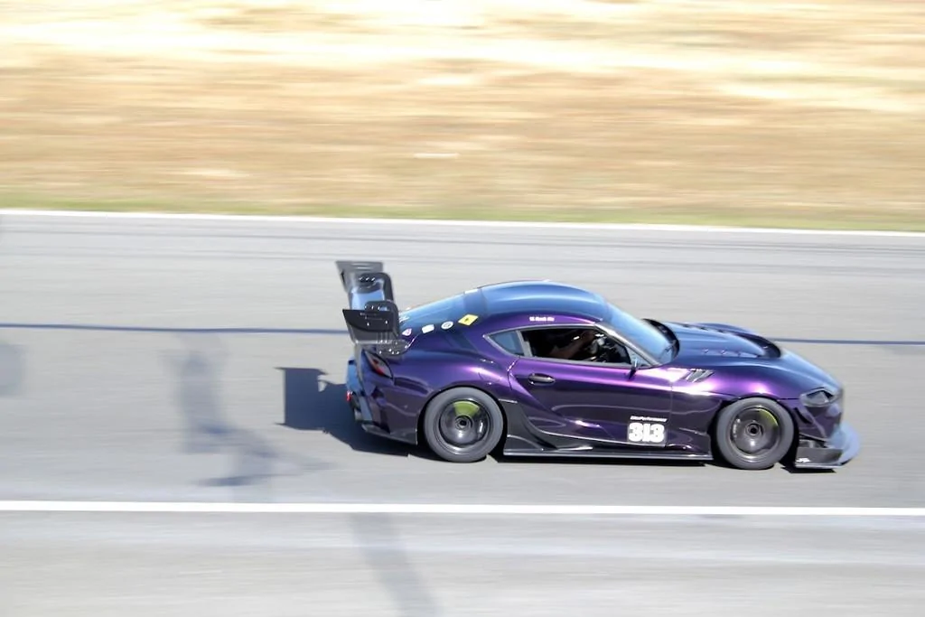

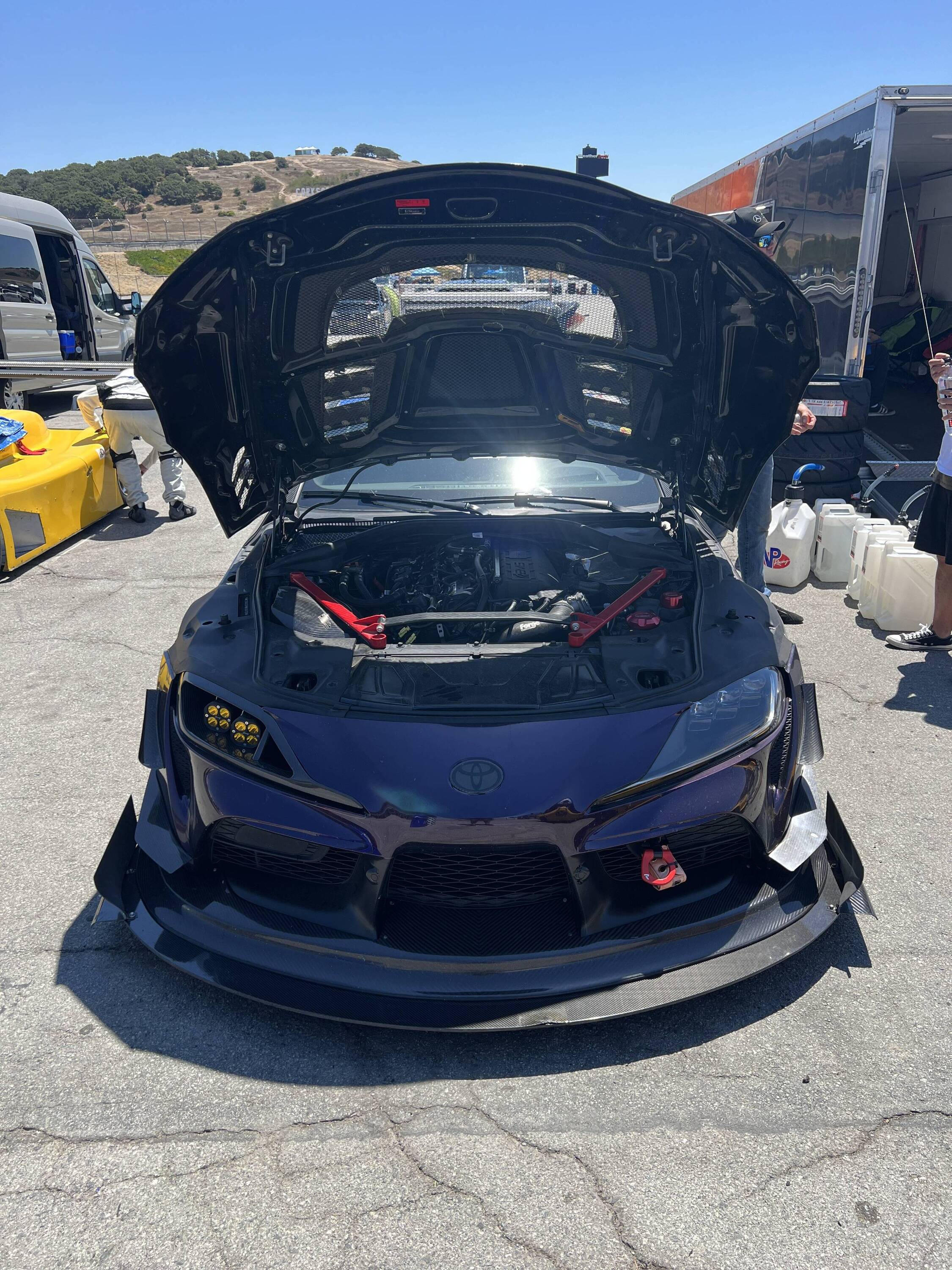

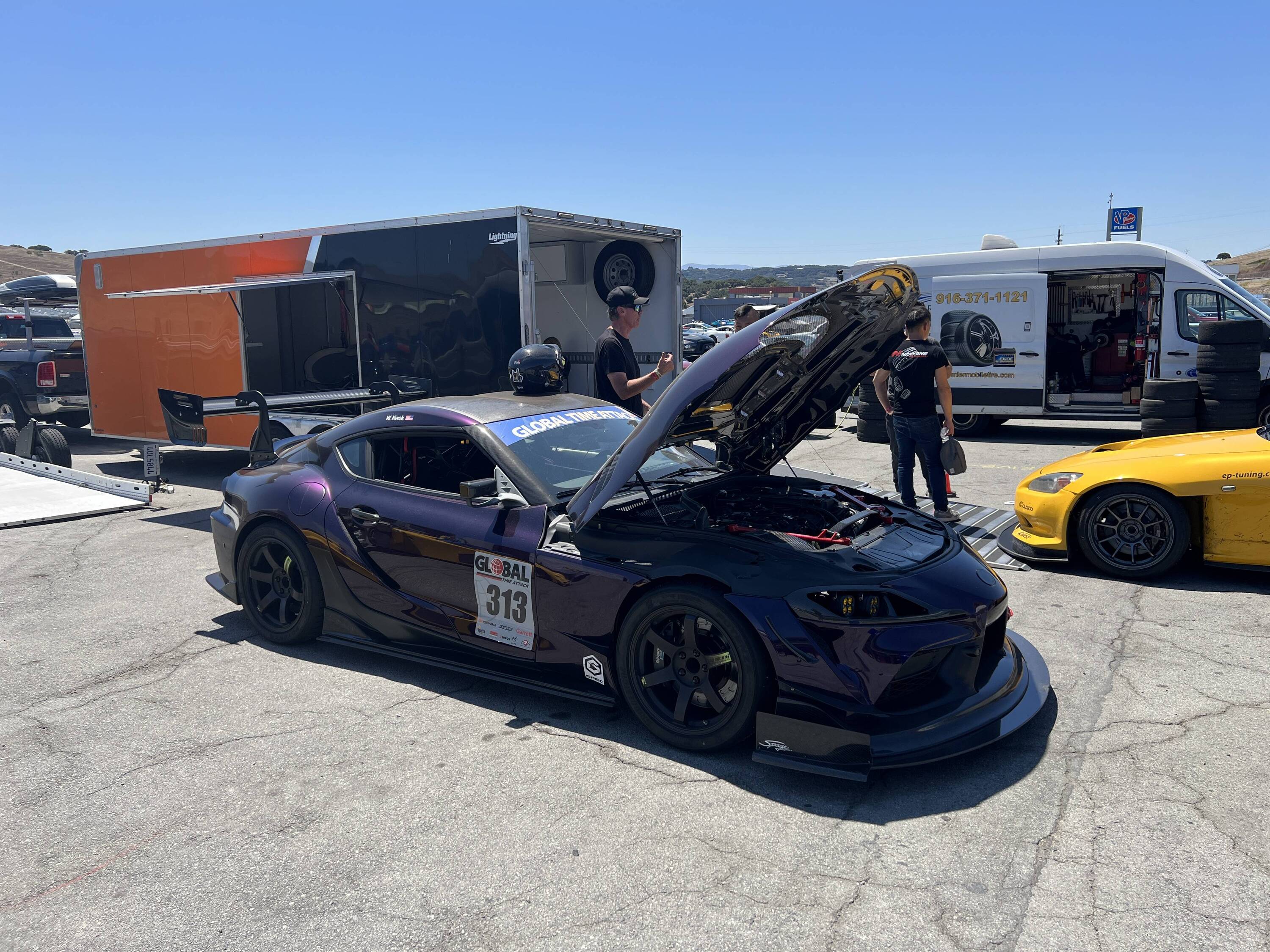

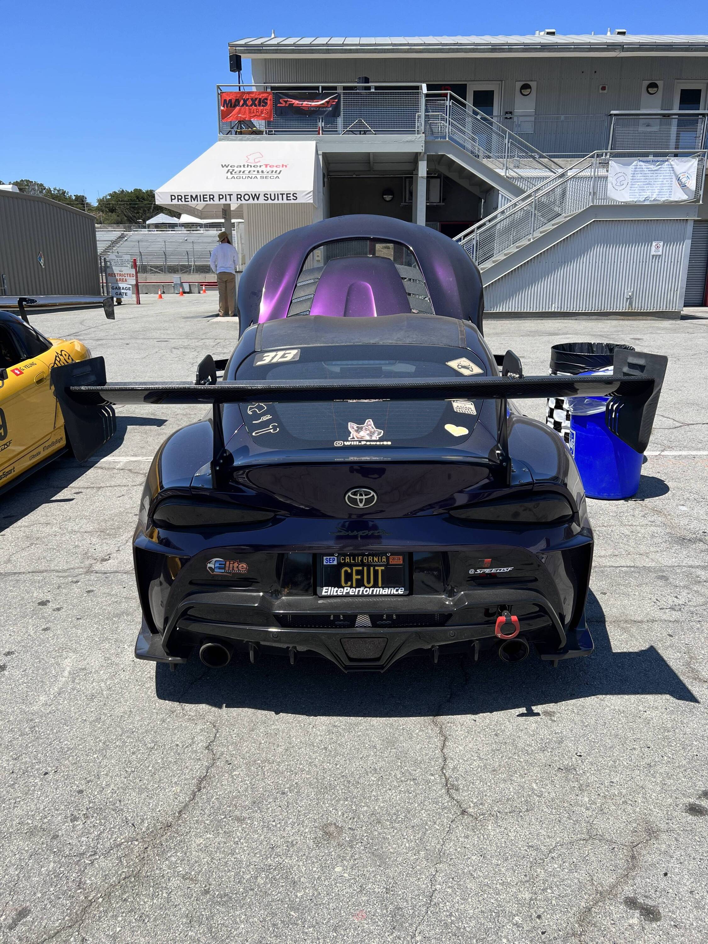

08/06/2023: Finally got to take it to the track again.
Been a long time since I've had the opportunity to take her on track because well... I guess my life has been kind of crazy. But hey, we're not here to talk about that. We're here to talk about the car.
Mods since we went out last time:
- Fixed fueling issue
- Installed Recaro podiums
- Installed Willans 6 point harness
Next up:
- Removing all the SPL stuff and installing all verkline subframe / suspension components
- Oil cooler kit
Took her out to Laguna yesterday on 08/06/23. She doesn't really have any fueling issues anymore but with the additional power, the car is overheating again. Trying to work with Doteki right now to see if we can get a oil cooler kit going to help keep things cool.
Aside from that, the car is just stupid fast. I ran OP2 and basically got stuck in traffic doing 1.40 flat all day. Buddy ran OP1 and did a 1.32 with traffic. So... sub 29's is definitely possible. Just nuts that sub 40's used to be fast and these days, sub 30s is within reach.
