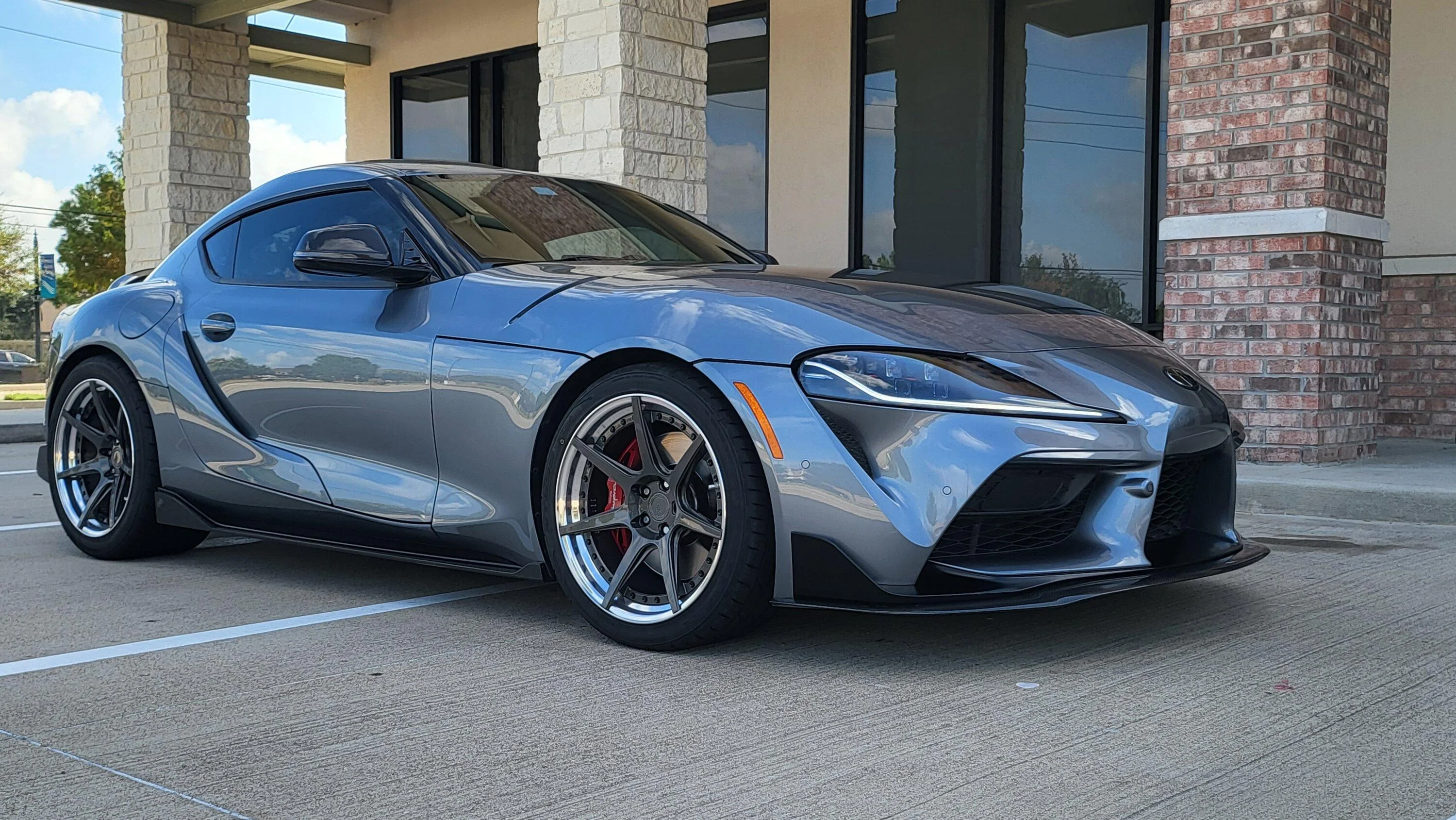

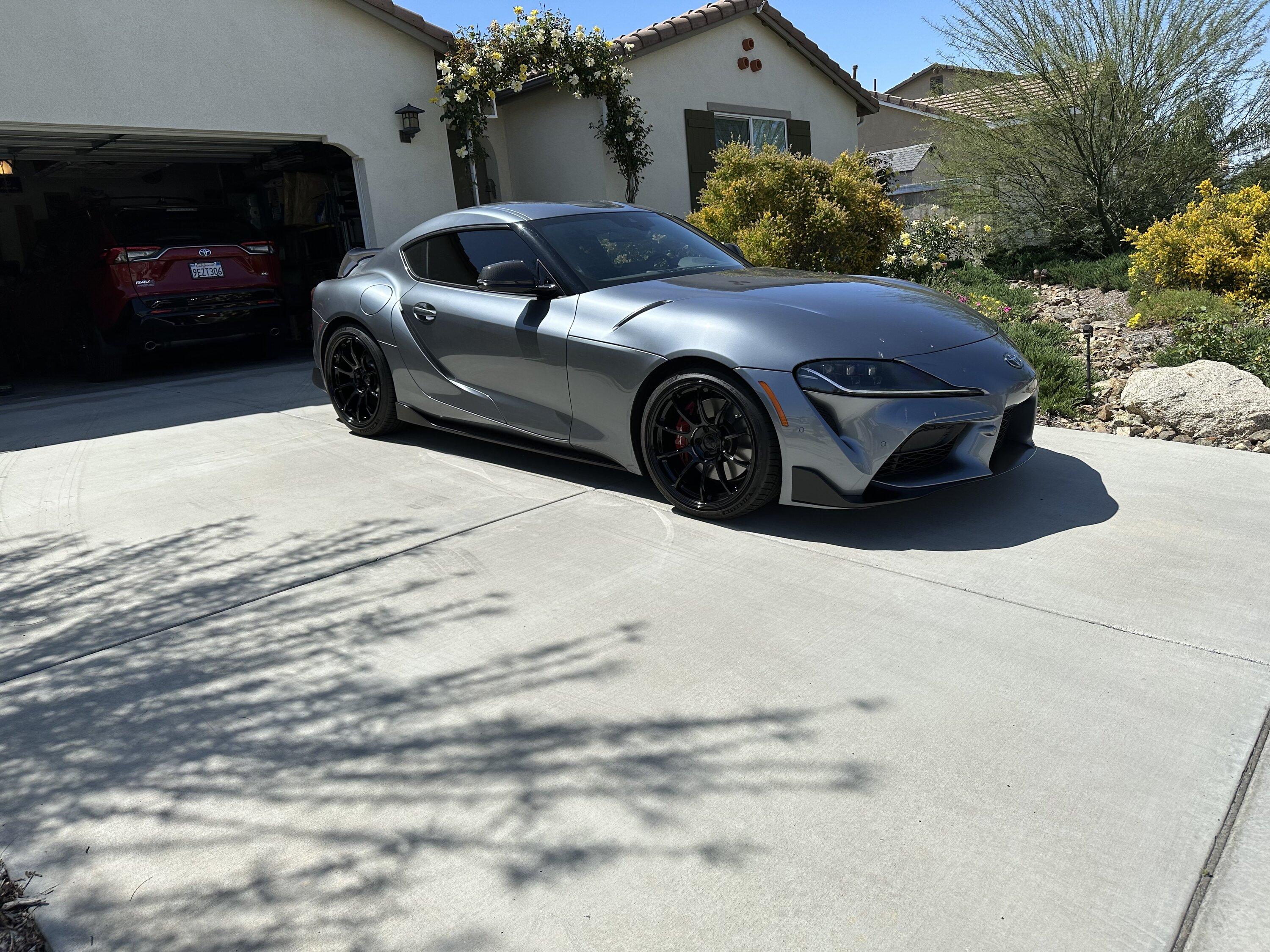

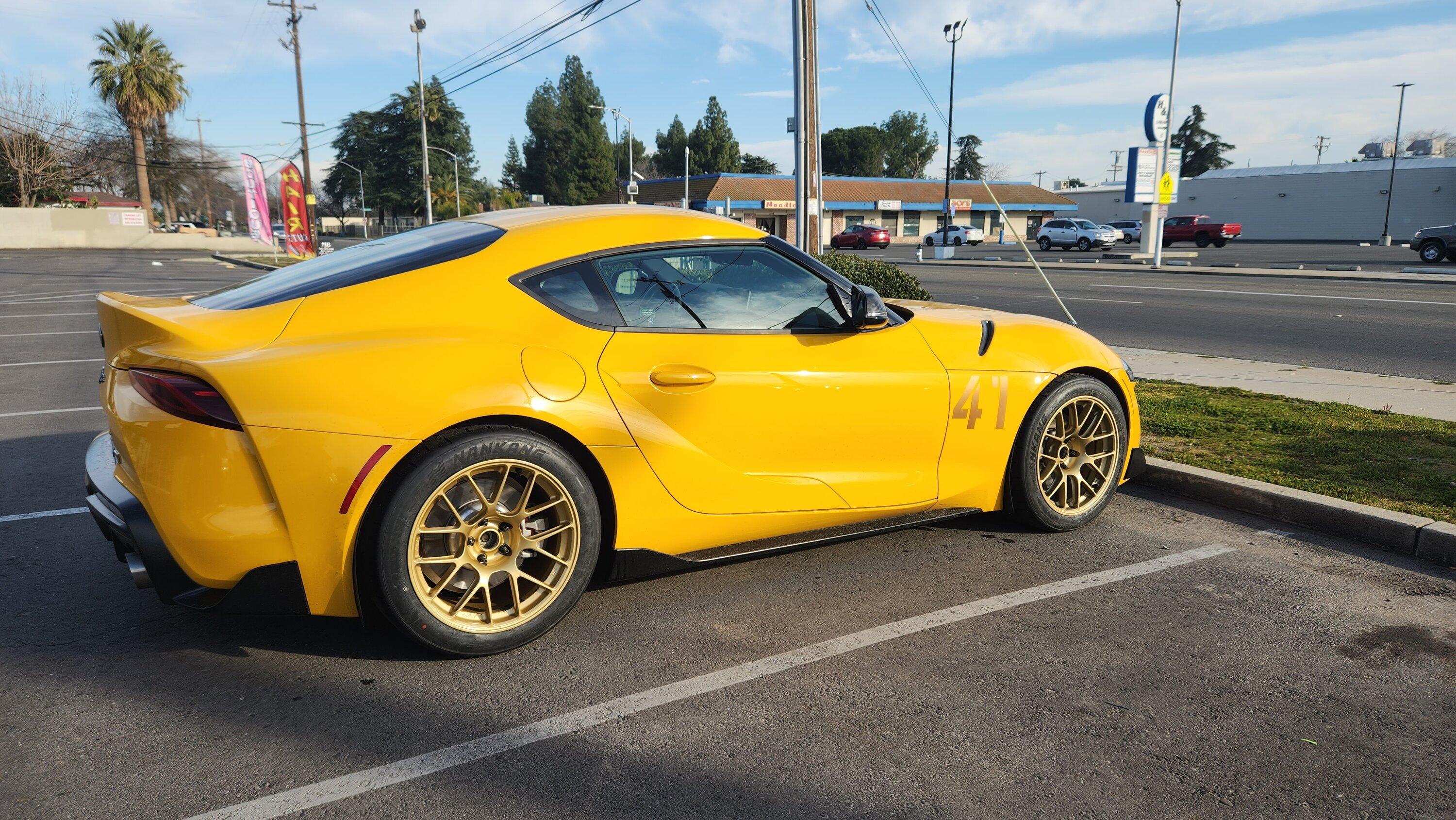

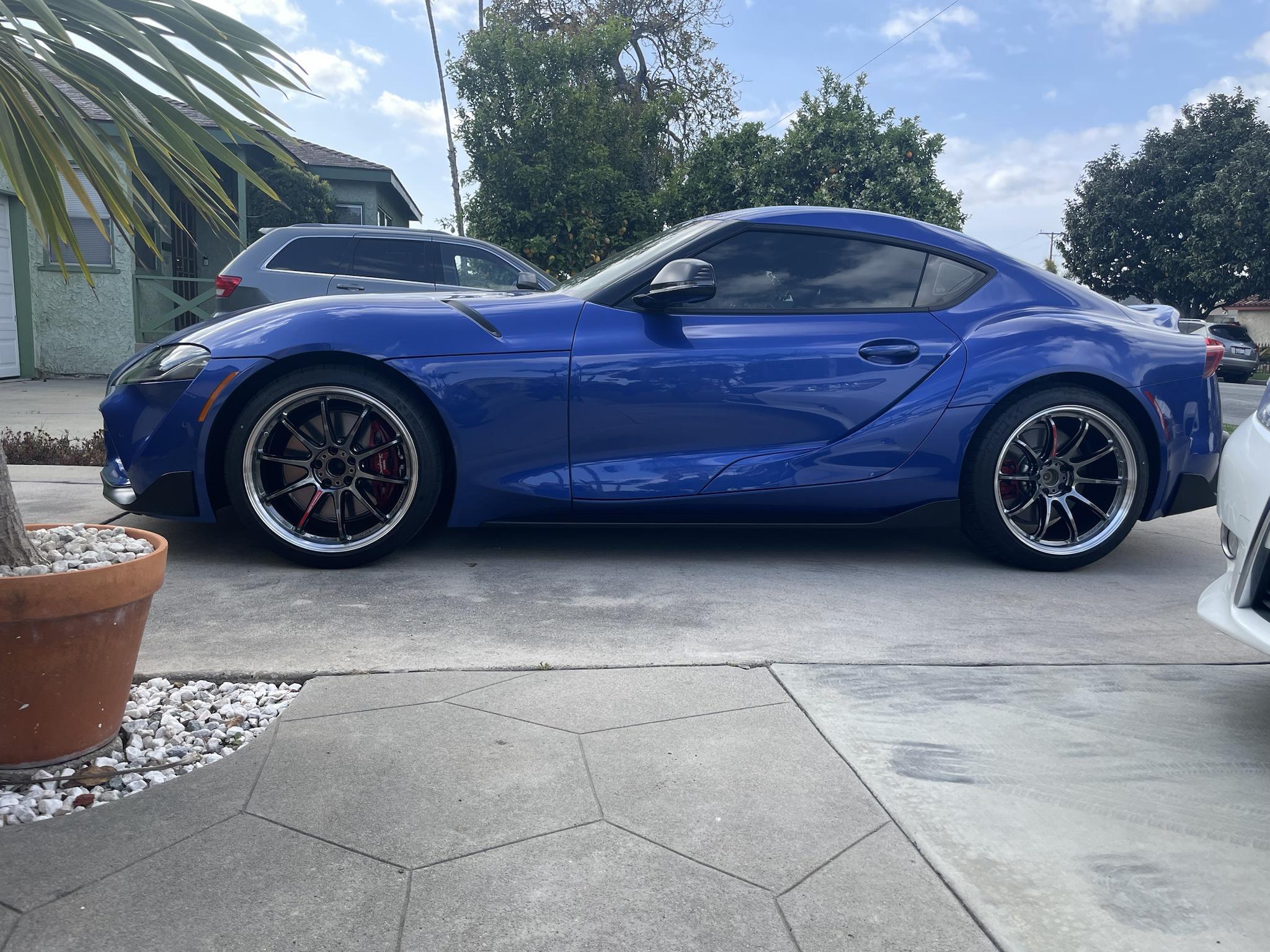

Stock suspension. 19" Work ZR10
I will be lowering soon.

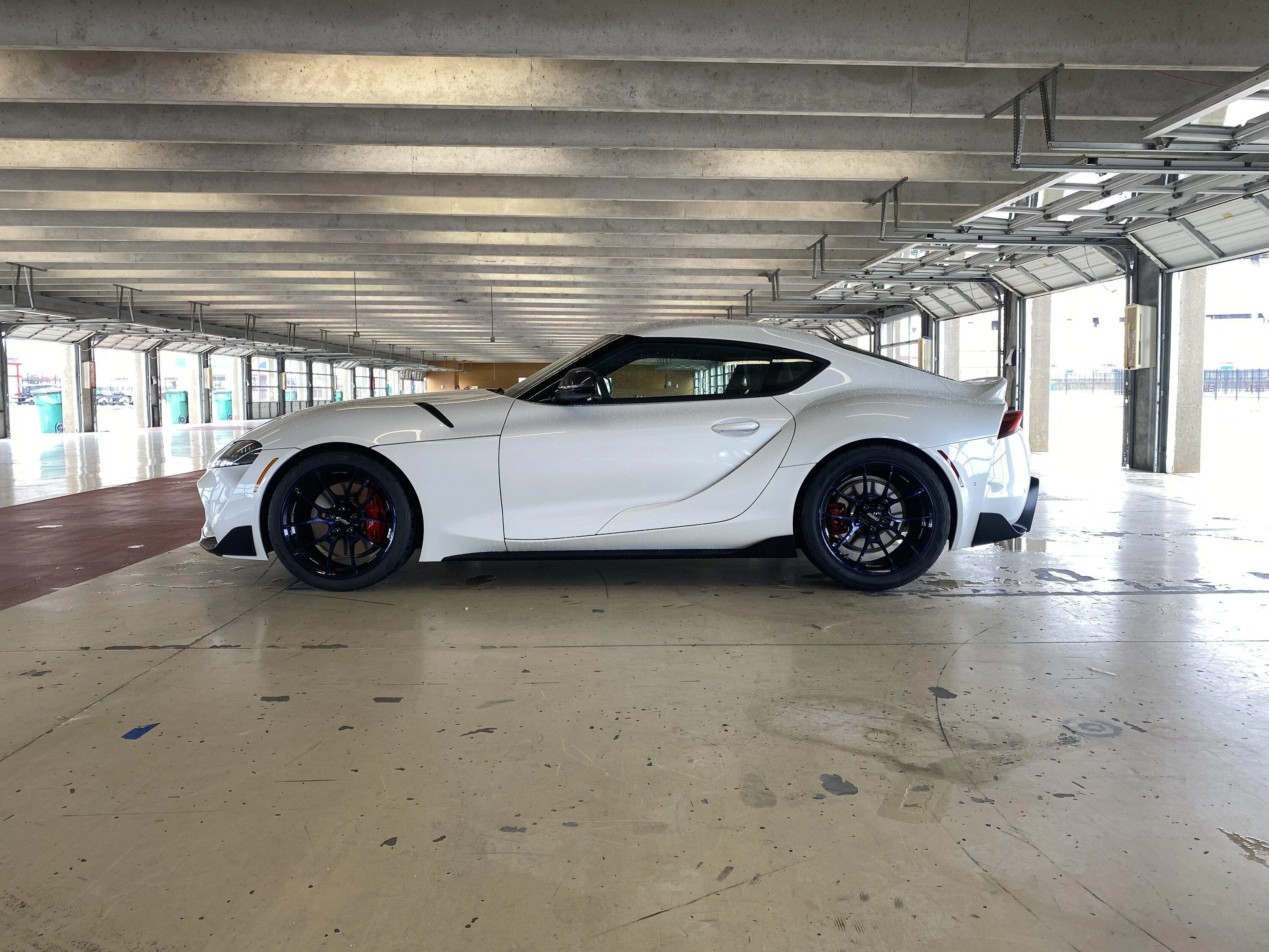

2022 Supra 3.0 Premium, 2019 Honda Civic Type R

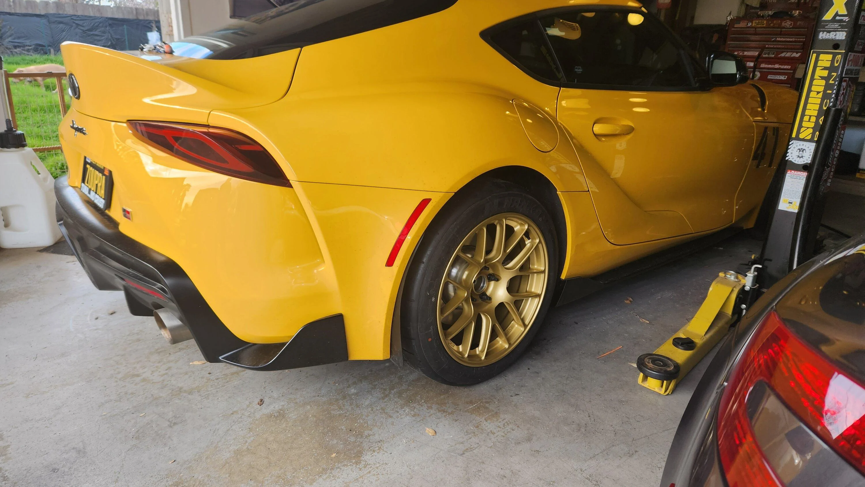

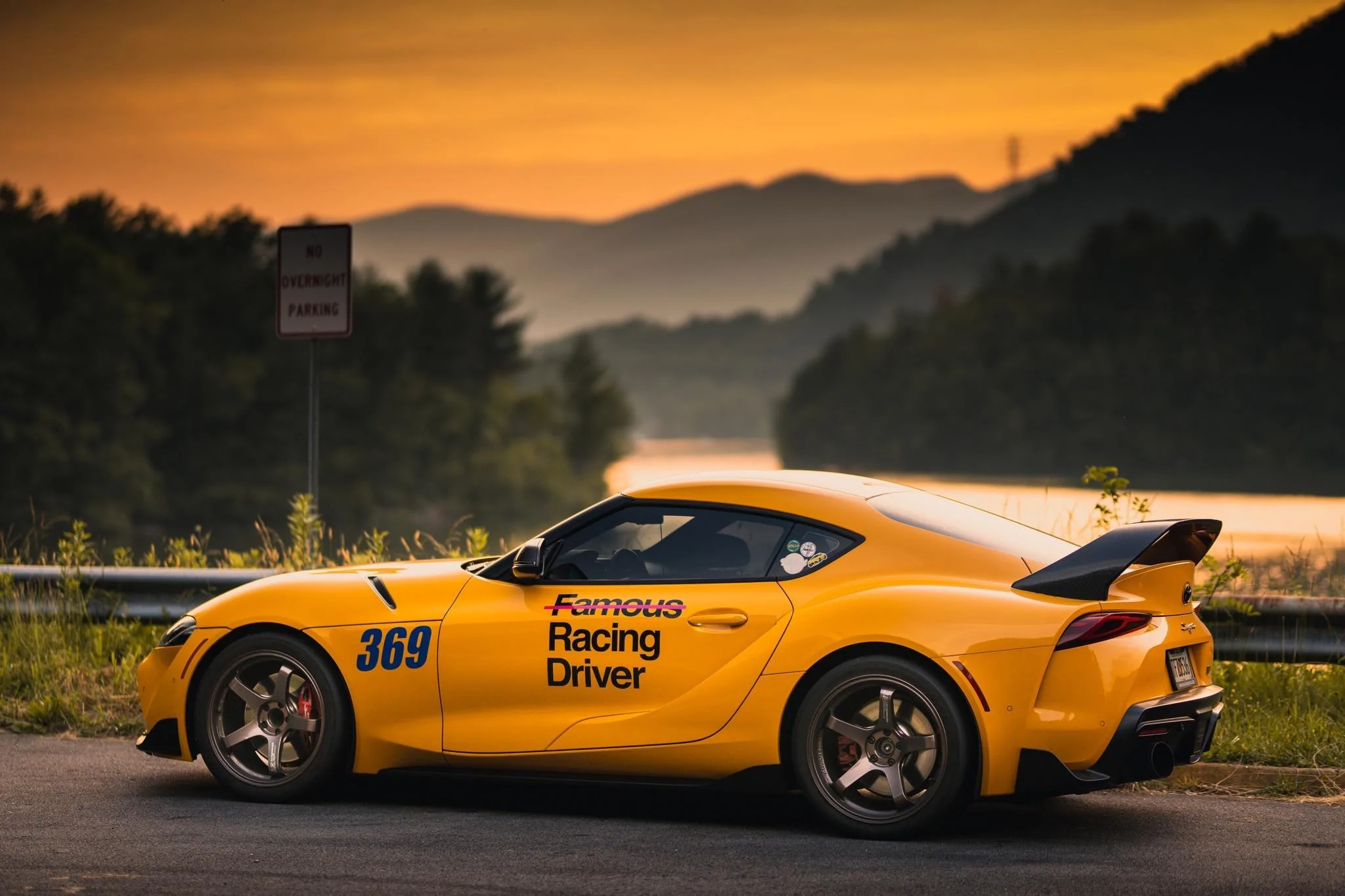

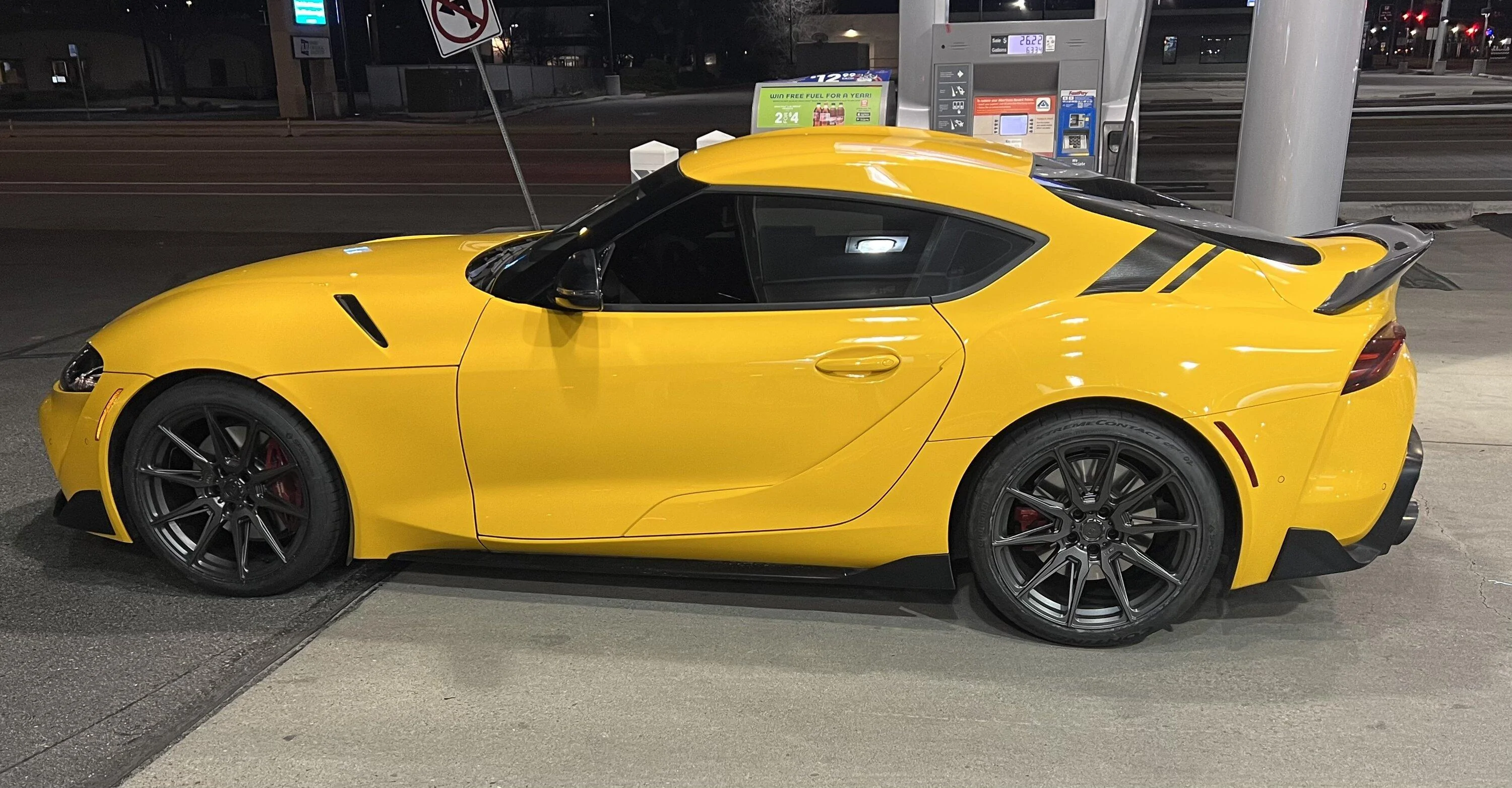

Stock suspension
ZE40 - 19X9.5 +22 / 19X10.5 +35

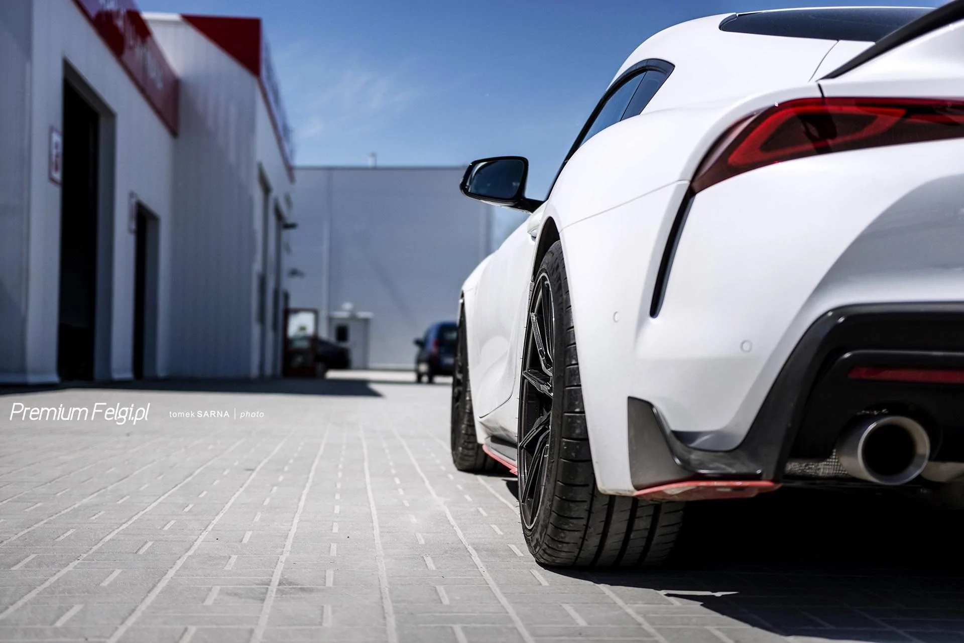

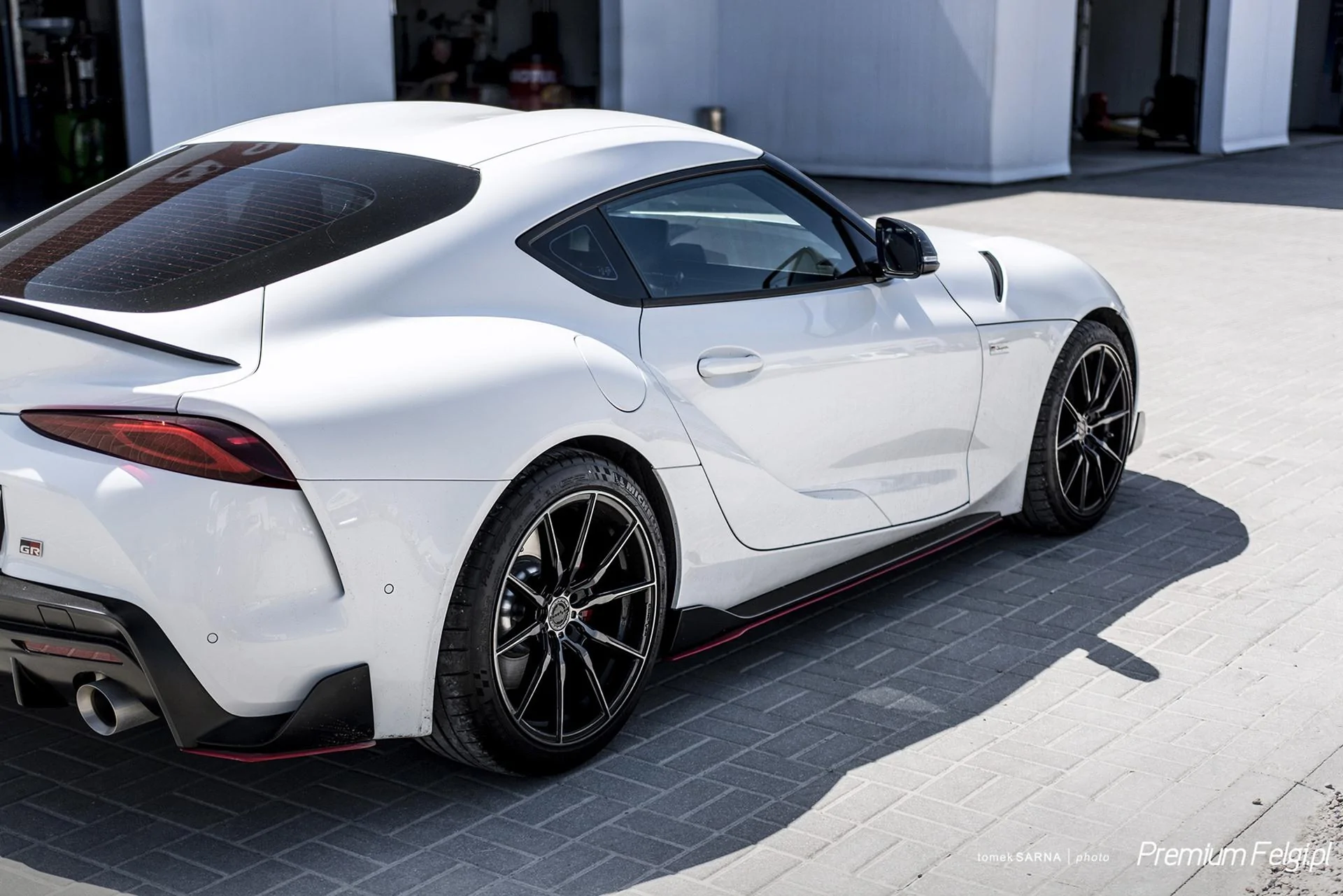

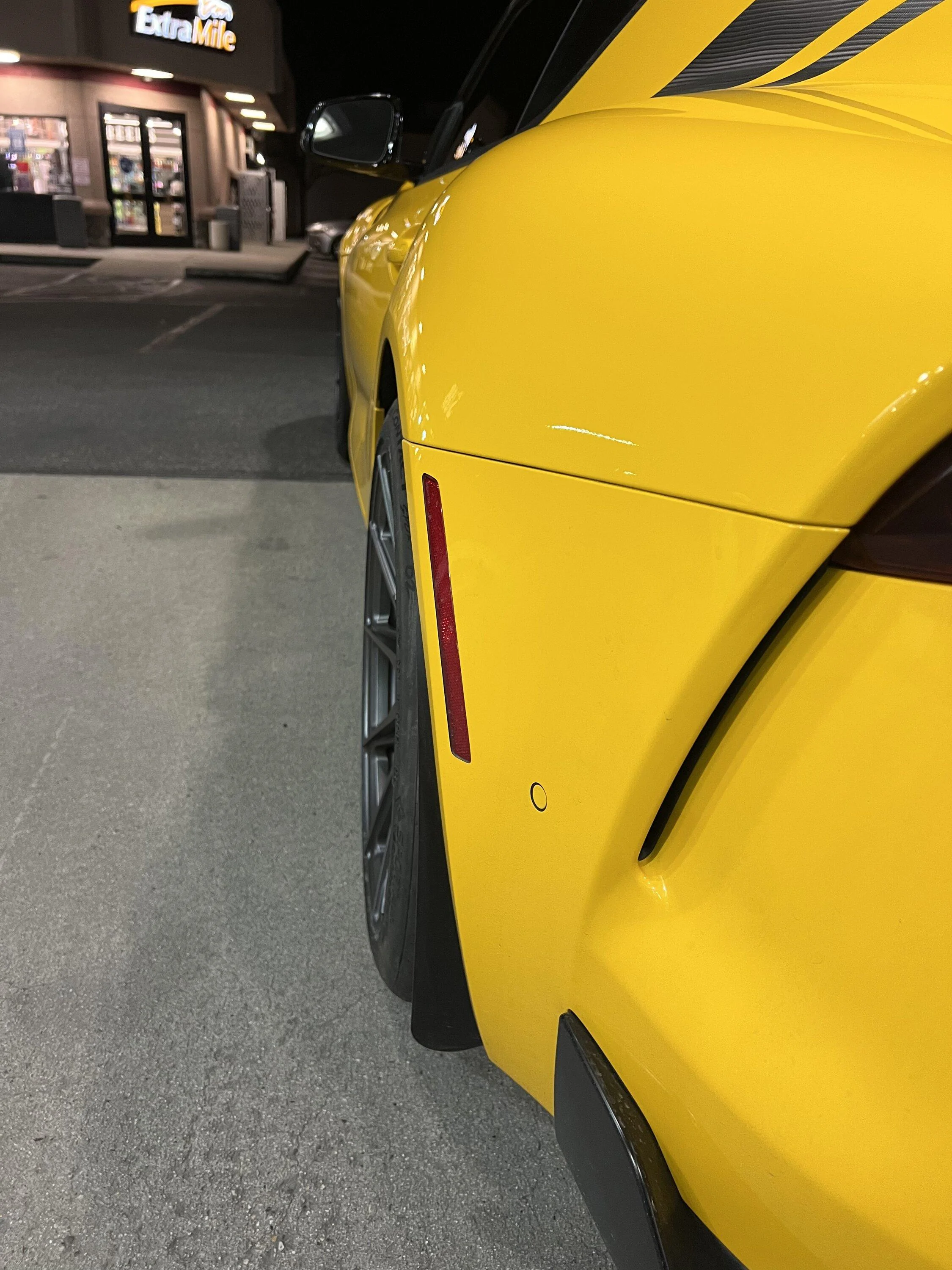

Supra MkV MY23 B48B20 (30i)
Titan 7 T-R10
Front: 19x9.5 +34
Rear: 19x11+40
Stock Tires
This looks like a quite safe setup, do the stones hit the door? I'm looking right now for a new set of 19" rims for summer tires, OEM size: front 19x9", rear 19x10". I'm considering now JR SL-02 with Eagle F1 Asymmetric 6 tires (OEM size: front 255/35 & rear 275/35). What would be a safe ET for these rims, more or less to have same look as your setup?
What about Concaver CRV4? Does anyone have this model? If yes, what design (performance or deep) is safe with OEM Brembo calipers?

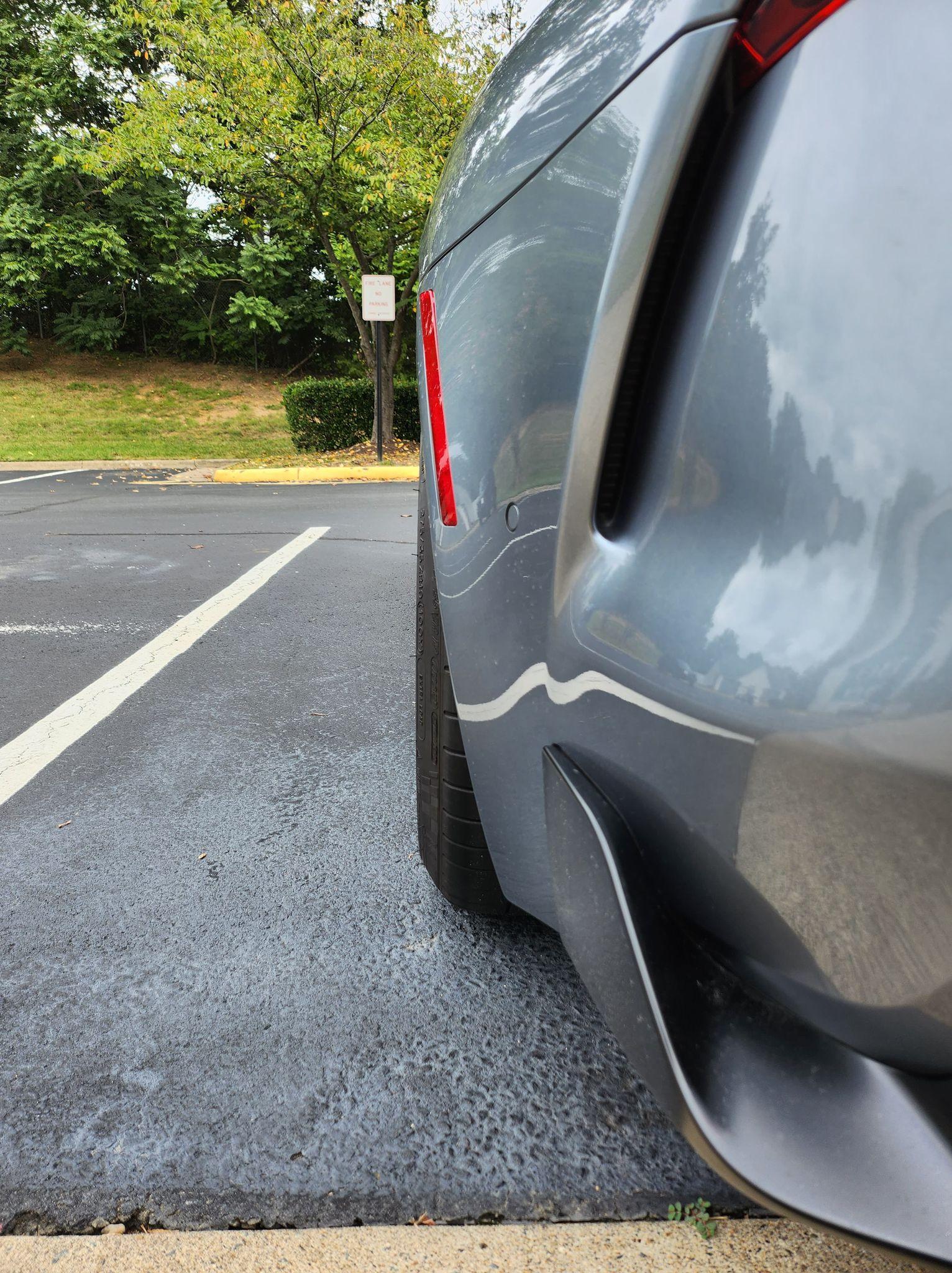

AHHH
Jun 10, 2022

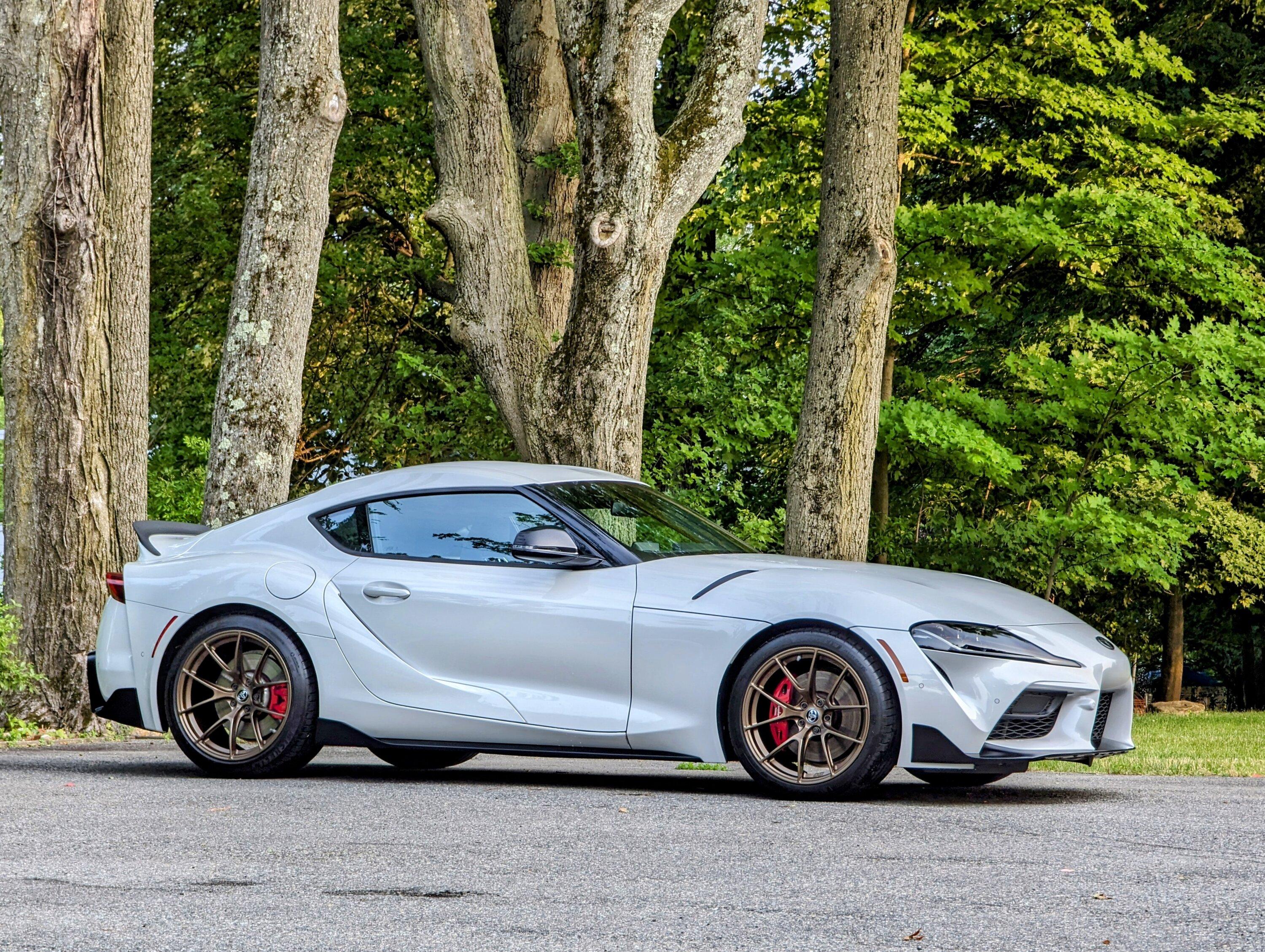

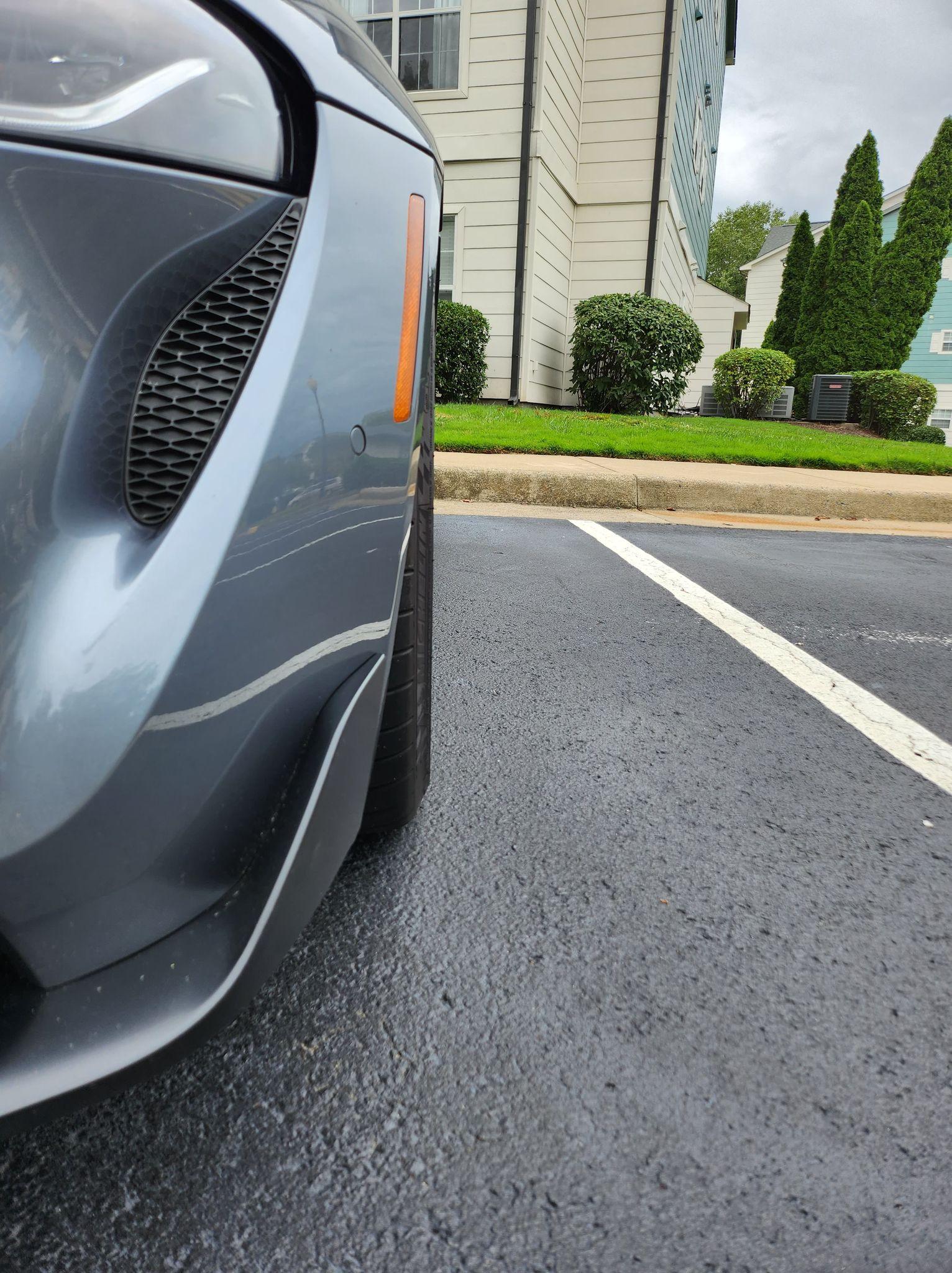

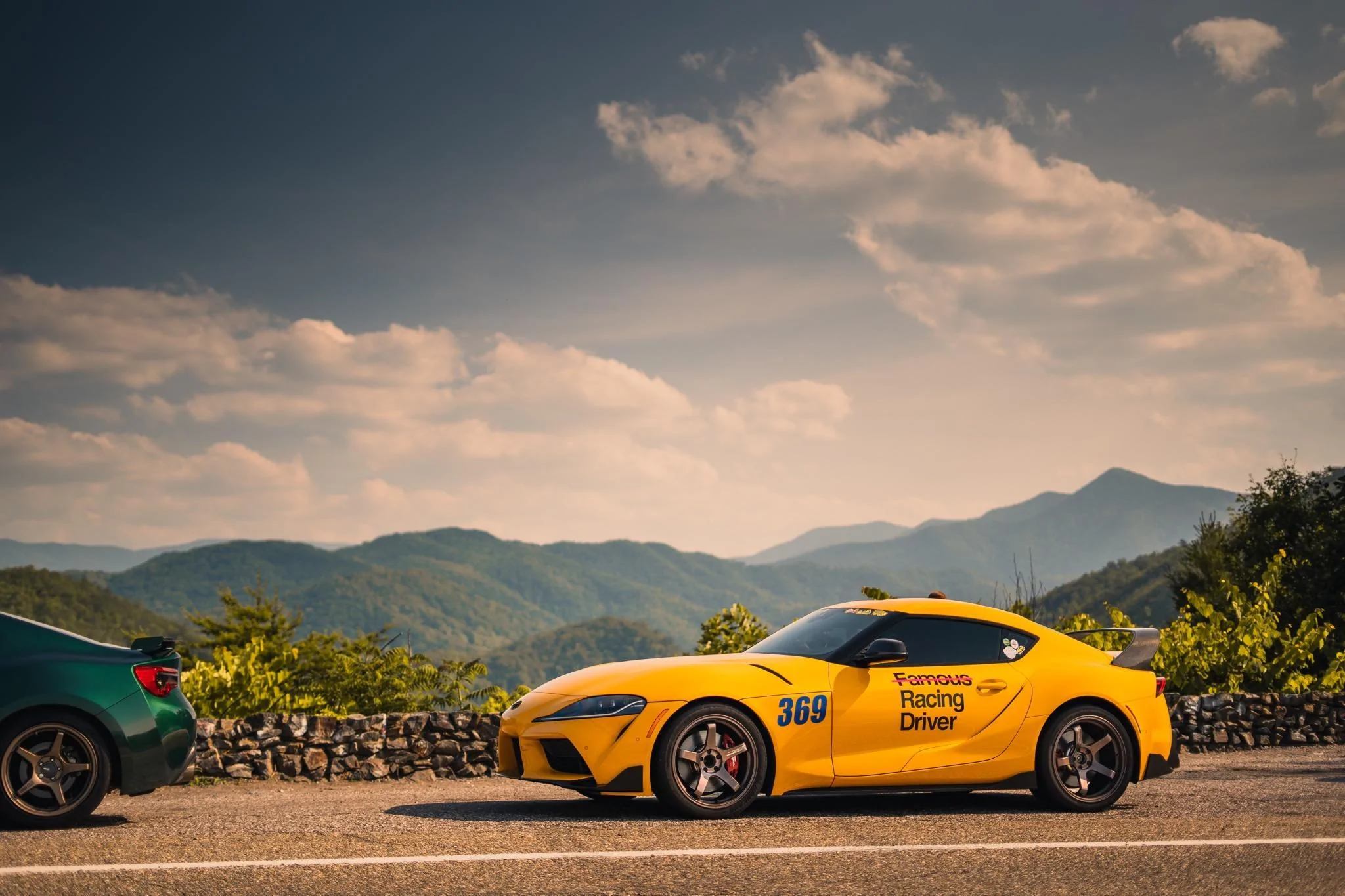

Rays Volk TE37 Ultra M-Spec (Gloss Black) w/ Rays Low centre caps
Typical sizing --> Front: 19x9.5, +23 / Rear: 19x10.5, +35
Tyres: Yokohama Advan V105
Front: 275/35 R 19
Rear: 295/35 R 19
The tyre shine in the first pic sorta exacerbates the wheel arch gap (overapplied onto the tread a bit lol)

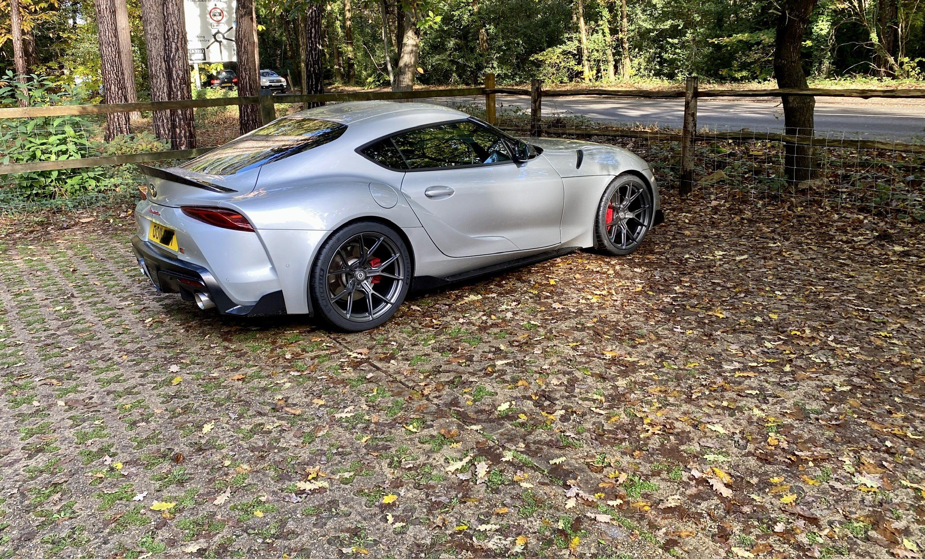

GR Supra 3.0

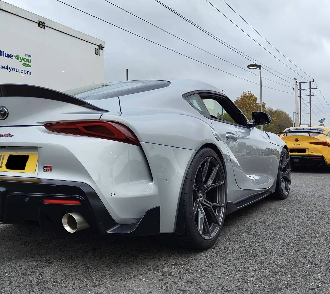

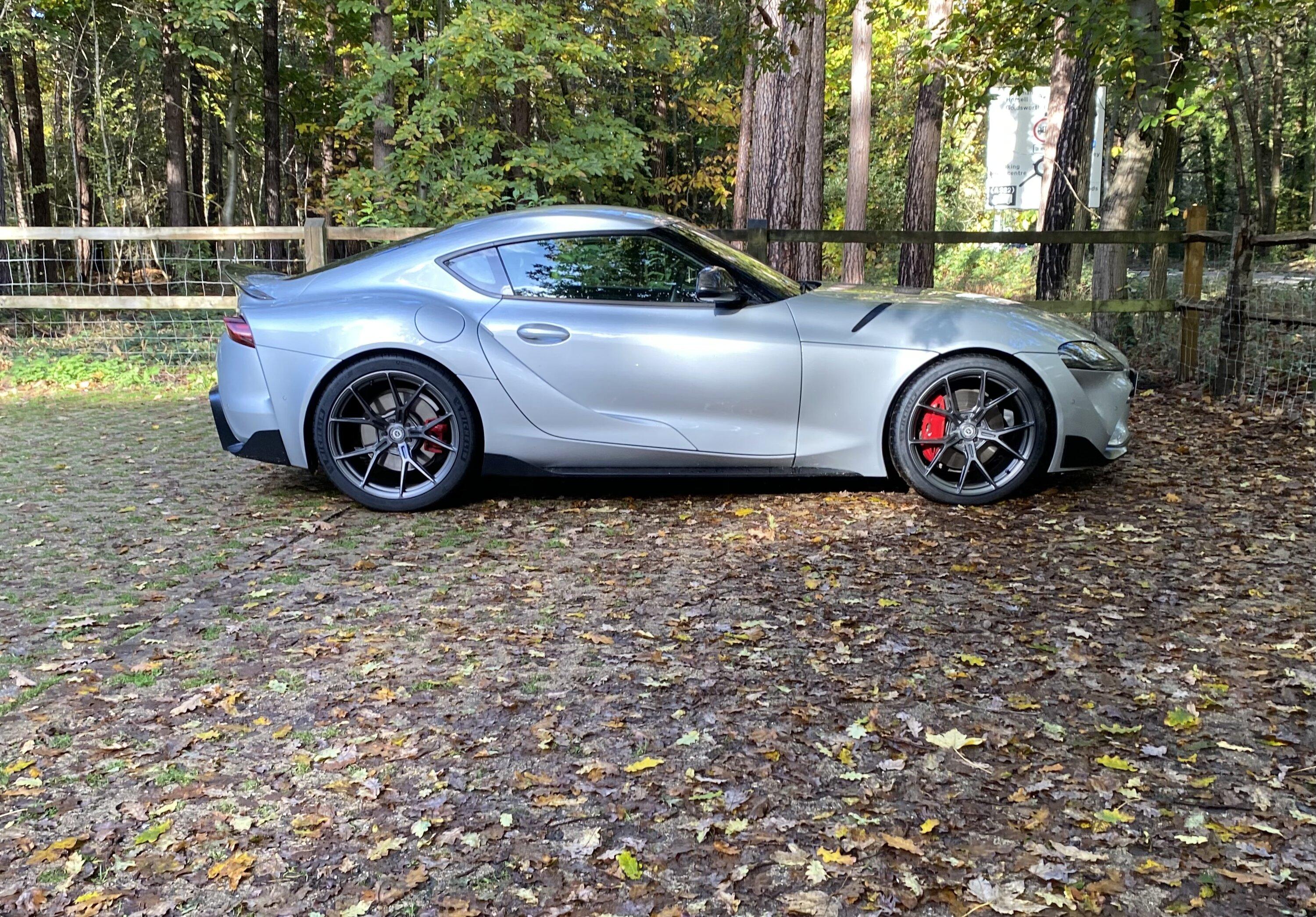

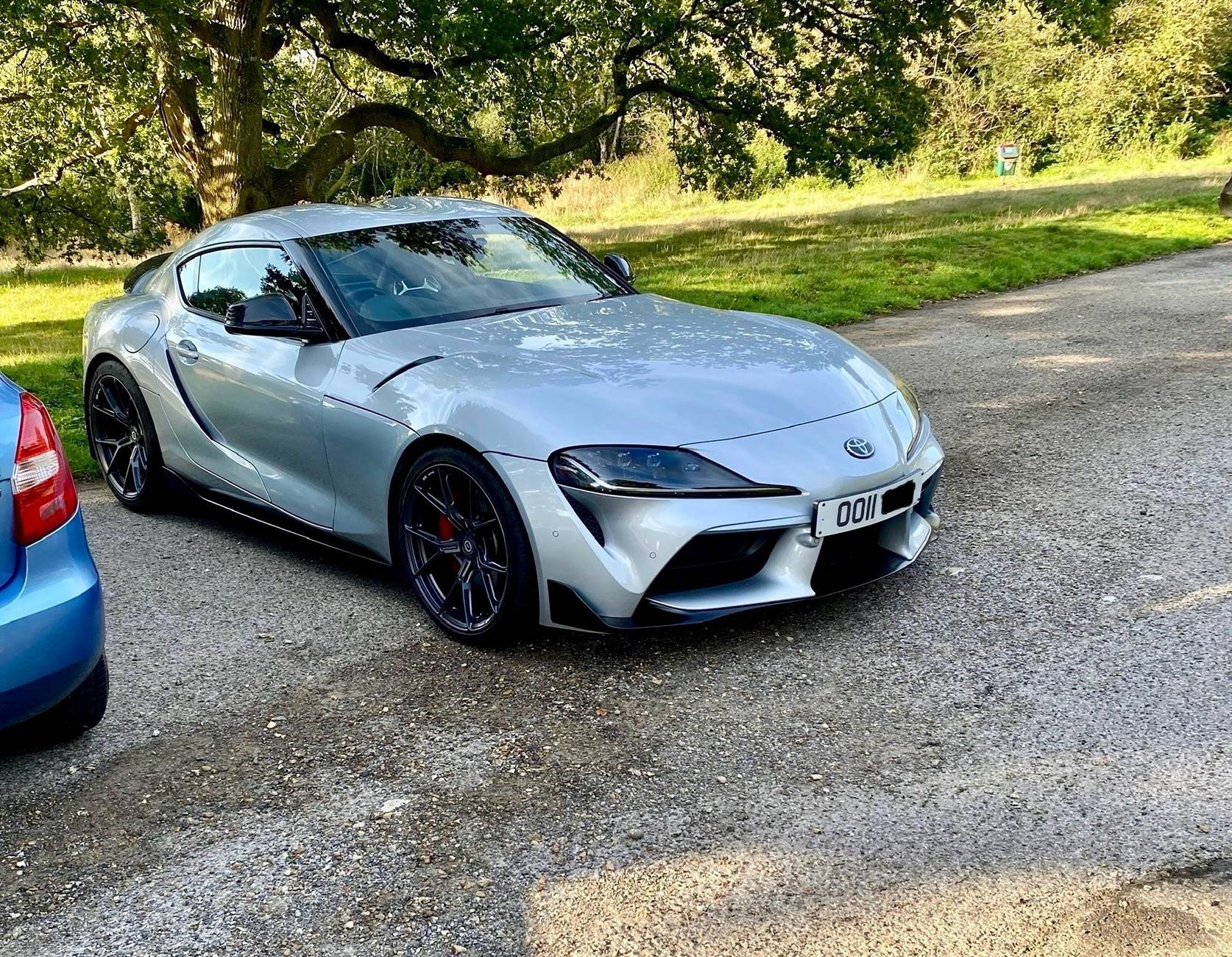

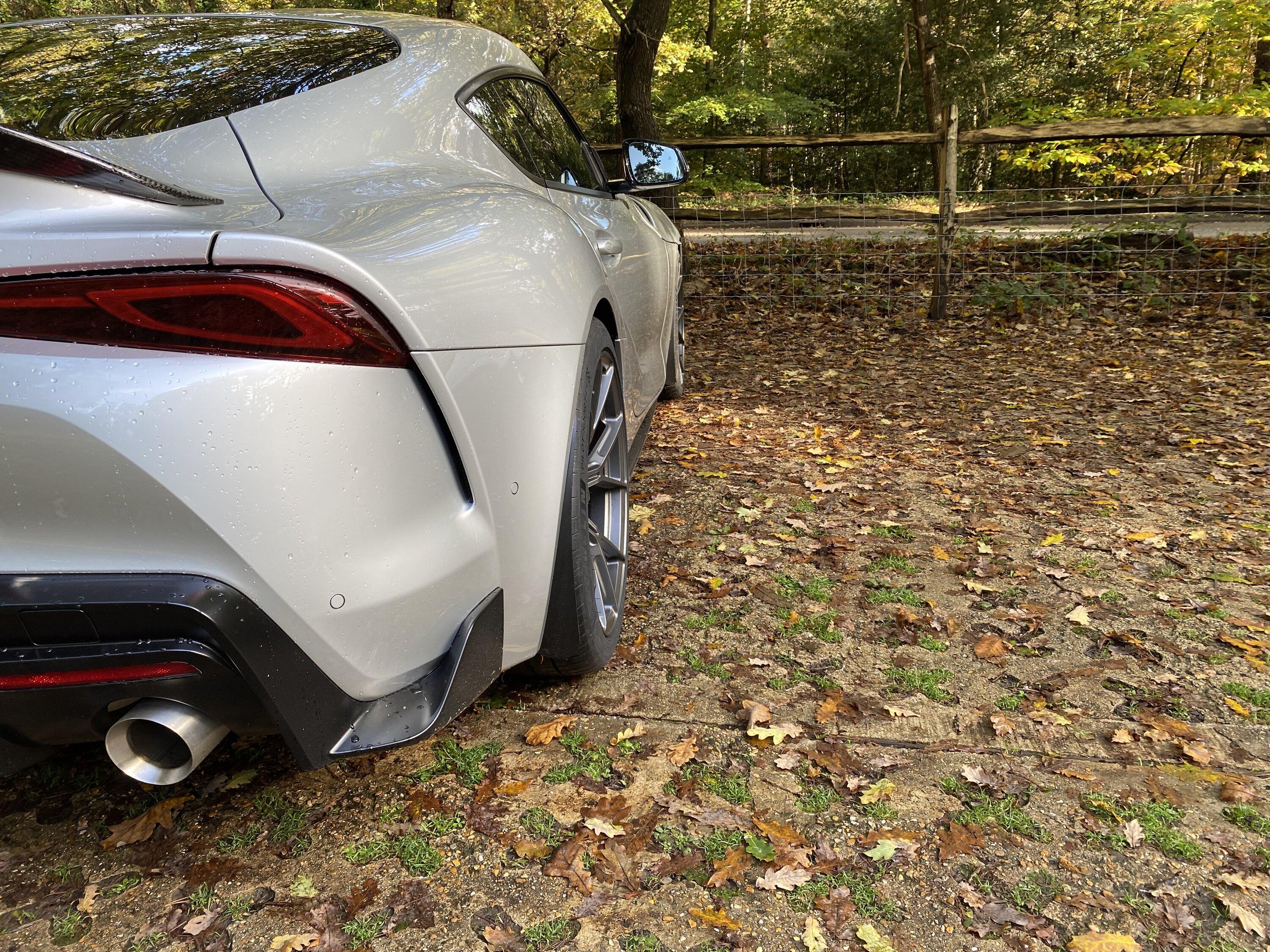

This thread has been really useful for me to see what stock suspension looks like with various setups as I’m trying not to lower mine due to speed bumps every 10ft on UK roads! Although, with the 20” setup I have raised the car slightly which means I do have scope to lower now if I wanted.
So, I thought I better add my setup to the mix for anyone else on this road! ??
Projex Design wheels.
20” x 11“ ET40” 305/30 Michelin PS4S
20” x 9.5“ ET30” 275/30 Michelin PS4S
(Offsets are for a flush fit so as not to fail an MOT)

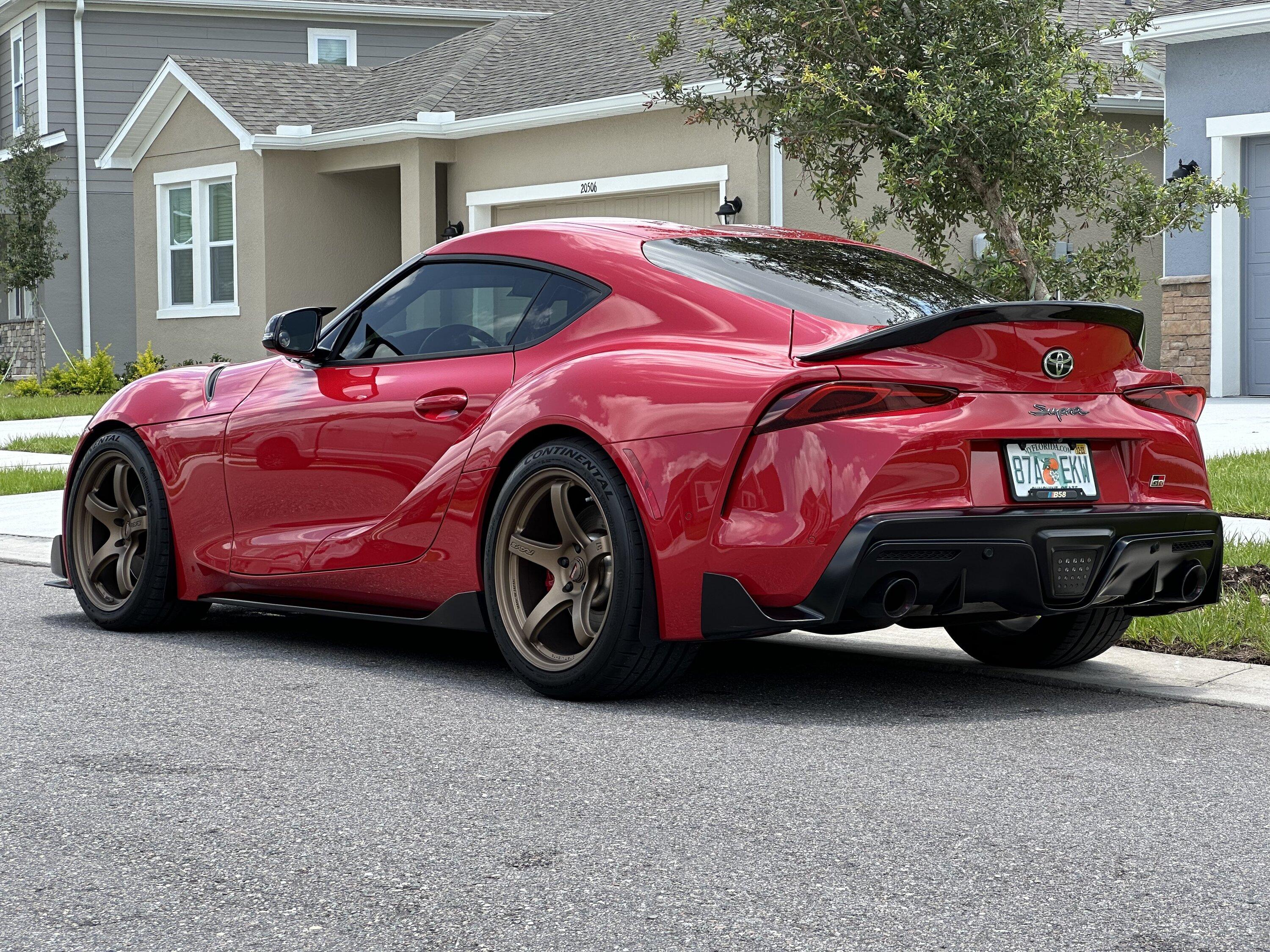

2020 Supra premium

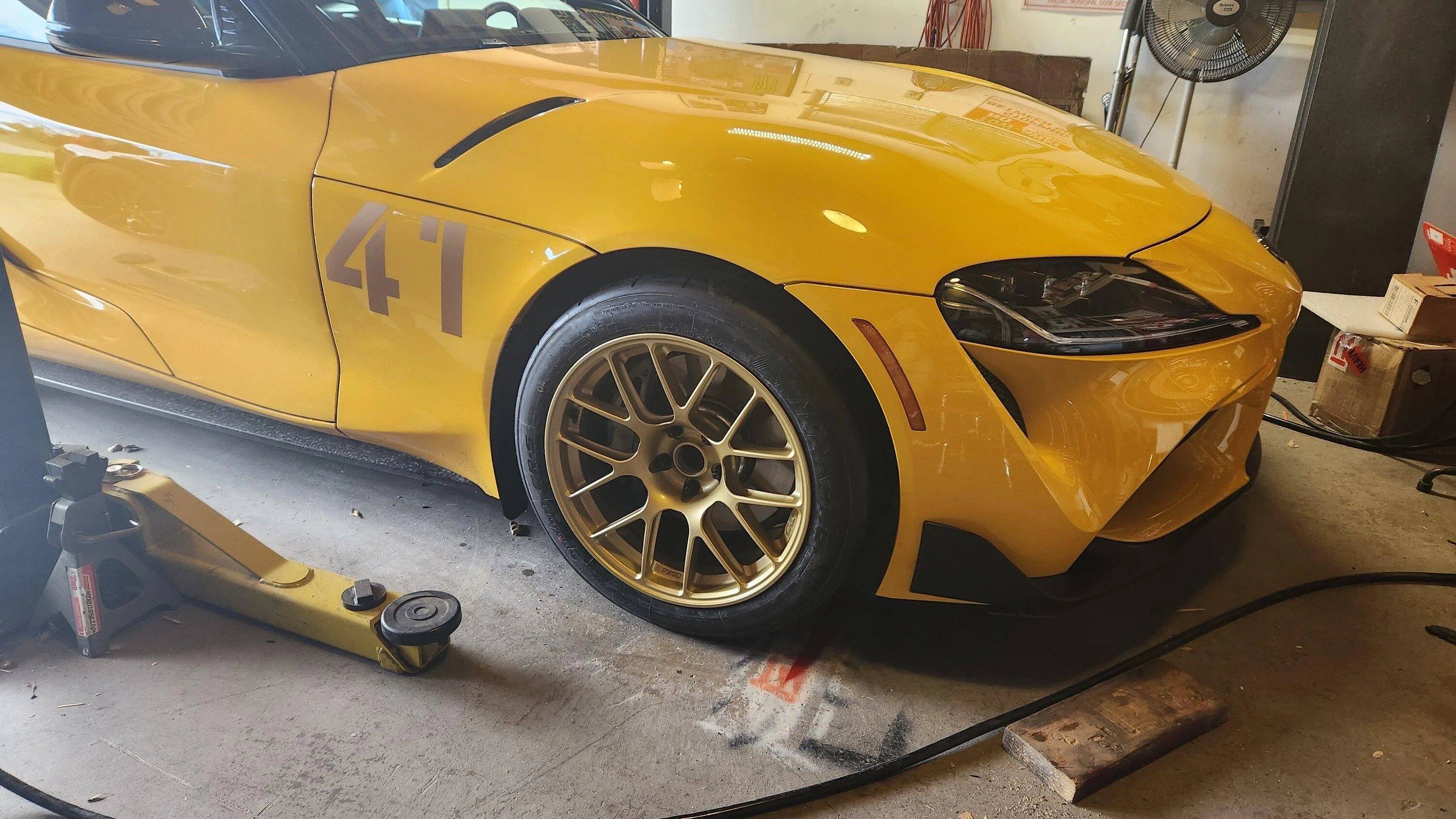

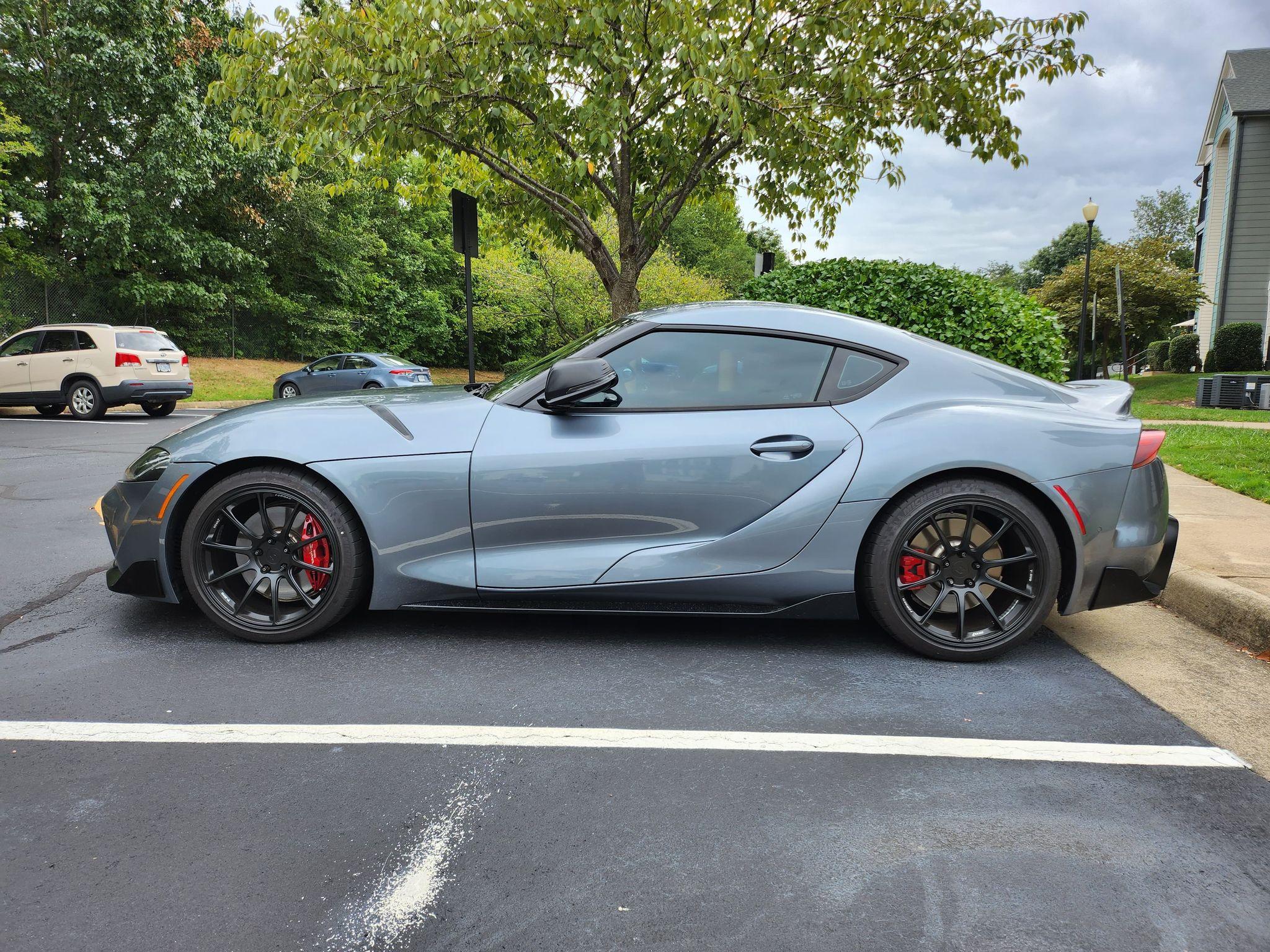

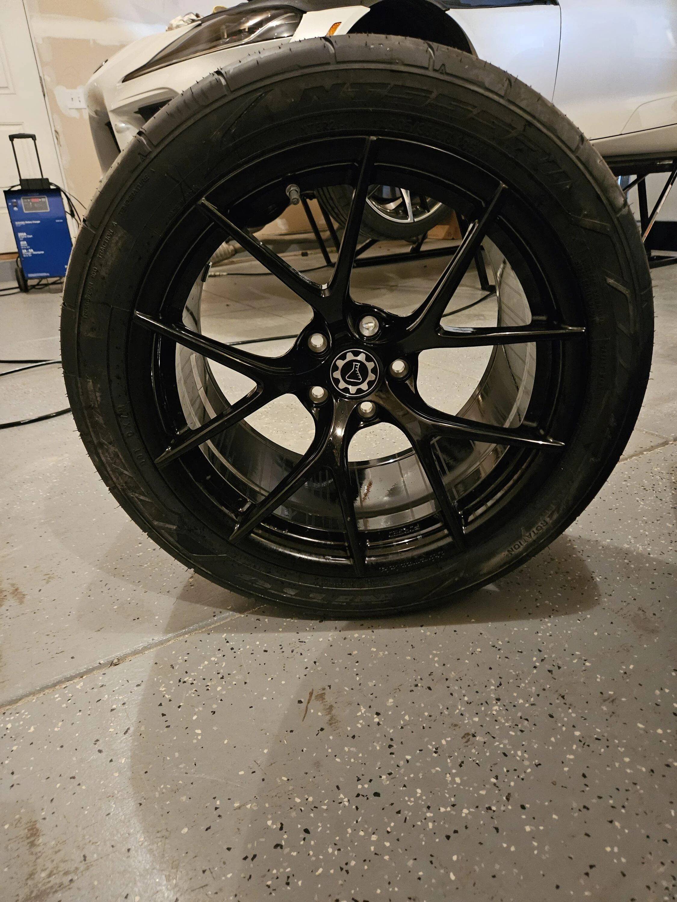

@Carl - Driveway Labs rims. Sorry for the bad pictures ill get some next spring that are better.
Fronts are 18x9.5 with +32. With nitto 555 g2 265/35/18
Rear 18x11 +40. With nitto 555r2 305/35/18
Color is bright black.
So far all my friends that seen them in person were impressed with the quality and with how light they are.
